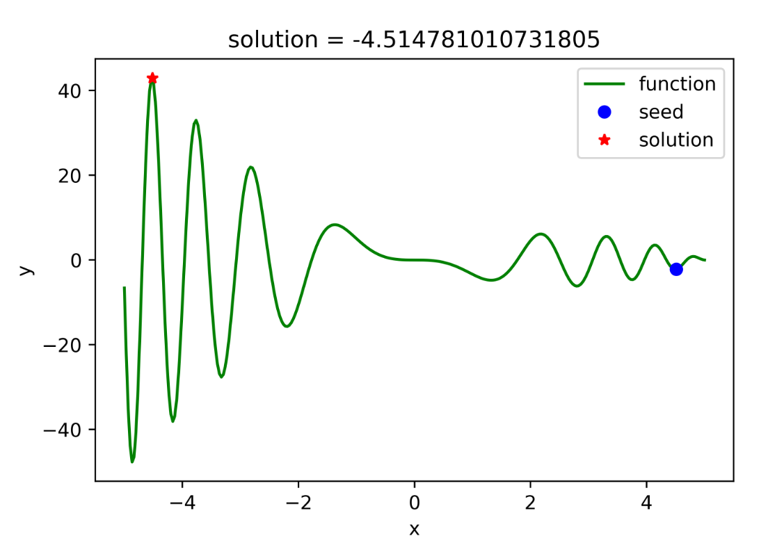

  61. def display(self):
  62. print('seed: {}\nsolution: {}'.format(self.x_seed, self.x_solu))
  63. plt.figure(figsize=(6, 4))
  64. x = np.linspace(self.interval[0], self.interval[1], 300)
  65. y = self.func(x)
  66. plt.plot(x, y, 'g-', label='function')
  67. plt.plot(self.x_seed, self.func(self.x_seed), 'bo', label='seed')
  68. plt.plot(self.x_solu, self.func(self.x_solu), 'r*', label='solution')
  69. plt.title('solution = {}'.format(self.x_solu))
  70. plt.xlabel('x')
  71. plt.ylabel('y')
  72. plt.legend()
  73. plt.savefig('SA.png', dpi=500)
  74. plt.show()
  75. plt.close()
  76. if __name__ == '__main__':
  77. SA([-5, 5], 'max')
结果展示
