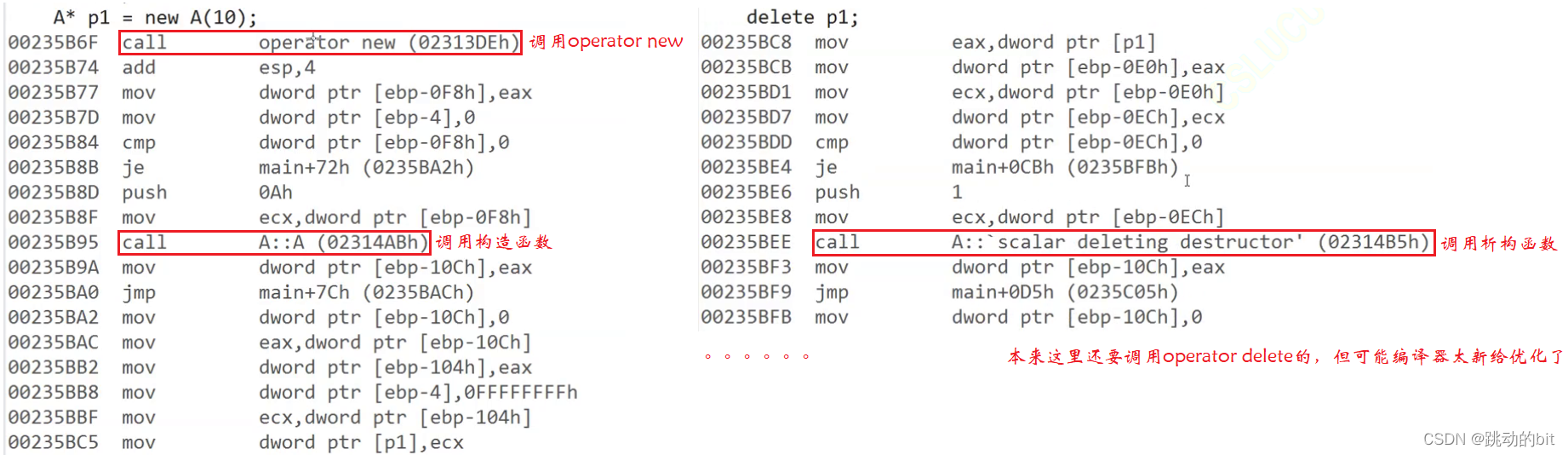

new A:
  1. 申请内存 —— 调用 operator new
  2. 构造函数
delete A:
  1. 析构函数
  2. 释放内存 —— 调用 operator delete
new 的反汇编 ❗

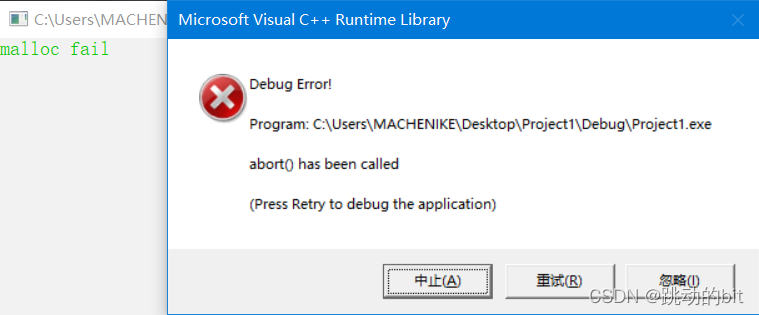

❓ 为什么要去调用 operator new 而不是调用其它的呢 ❔
int main()
	//malloc失败返回空
	char* p1 = (char*)malloc(0xffffffff);
	if (p1 == NULL)
		printf("malloc fail\n");
	else
		printf("malloc success:%p\n",p1);
	//new失败抛异常
	char* p2 = new char[0x7fffffff];
	if (p1 == NULL)
	else
		printf("malloc success:%p\n", p1);
	return 0;
📝说明
因为 new 和 malloc 它们失败时,处理的方式不一样
malloc 失败了,这里的检查起作用了
new 失败了,这里的检查没起作用,还引发了一个崩溃 —— 抛异常后没有解决

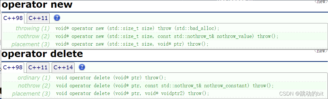

operator new 和 operator delete 源码 ❗
operator new:该函数实际通过malloc来申请空间,当malloc申请空间成功时直接返回;申请空间失败,
尝试执行空 间不足应对措施,如果改应对措施用户设置了,则继续申请,否则抛异常。

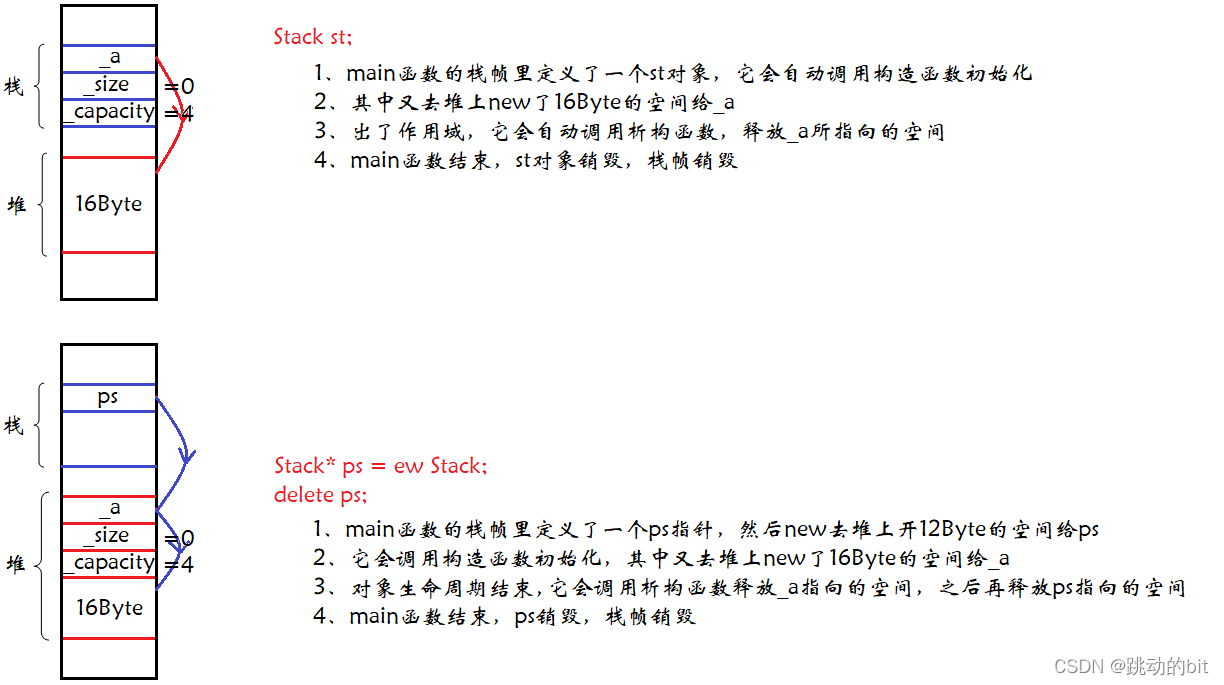

场景使用 ❓
class Stack
public:
	Stack(int capacity = 4)
		: _a(new int[capacity])
		, _size(0)
		, _capacity(capacity)
		cout << "Stack(int capacity = 4)" << endl;
	~Stack()
		delete[] _a;
		_size = _capacity = 0;
		cout << "~Stack()" << endl;
private:
	int* _a;
	int _size;
	int _capacity;
int main()
	//1
	Stack st;
	//2
	Stack* ps = new Stack;
	delete ps;
	return 0;
📝说明:

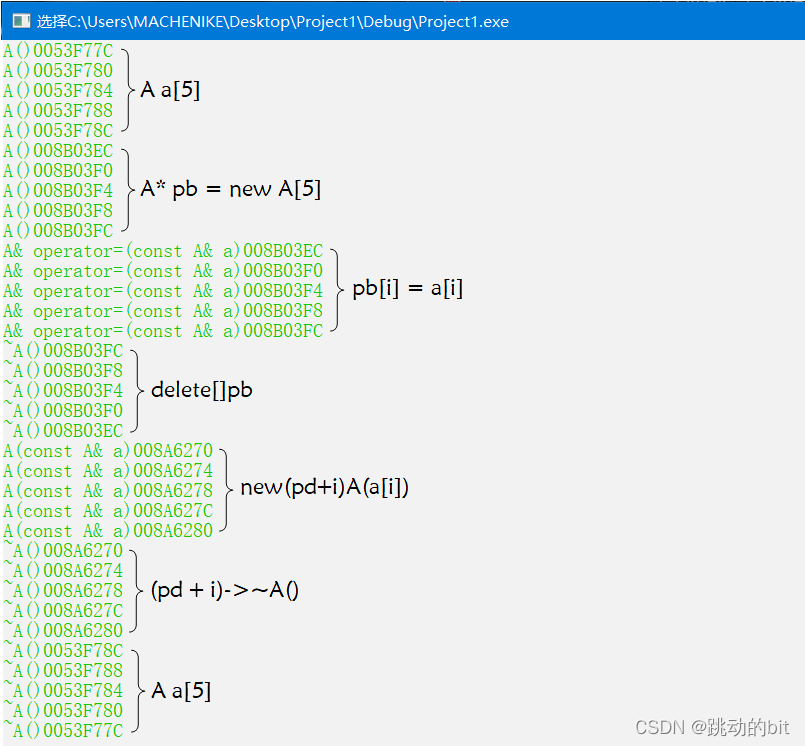

这里举一个好理解的 —— 复制一份 a数组到另一块空间 pb ❗
class A
public:
	A(int a = 0)
		: _a(a)
		cout << "A()" << this << endl;
	A(const A& a)
		cout << "A(const A& a)" << this << endl;
	A& operator=(const A& a)
		cout << "A& operator=(const A& a)" << this << endl;
		return *this;
	~A()
		cout << "~A()" << this << endl;
private:
	int _a;
int main()
	//构造+赋值
	A a[5];
	A* pb = new A[5];
	for(int i = 0; i < 5; i++)
		pb[i] = a[i];
	delete []pb;
	//拷贝构造
	A* pd = (A*)malloc(sizeof(A) * 5);
		new(pd + i)A(a[i]);
		(pd+i)->~A();
	return 0;
📝说明
由此可见,使用定位 new 表达式的效率更高。
