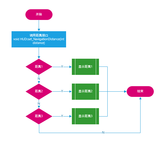

  1. void HUD::set_NavigationDistance(int distance)
  2. {
  3. ui->label_line->hide();
  4. switch (distance) {
  5. case NAVIGATIONDISTANCE_1:
  6. ui->label_dial_1->show();
  7. ui->label_dial_2->hide();
  8. ui->label_dial_3->hide();
  9. break;
  10. case NAVIGATIONDISTANCE_2:
  11. ui->label_dial_1->show();
  12. ui->label_dial_2->show();
  13. ui->label_dial_3->hide();
  14. break;
  15. case NAVIGATIONDISTANCE_3:
  16. ui->label_dial_1->show();
  17. ui->label_dial_2->show();
  18. ui->label_dial_3->show();
  19. break;
  20. default:
  21. break;
  22. }
  23. }

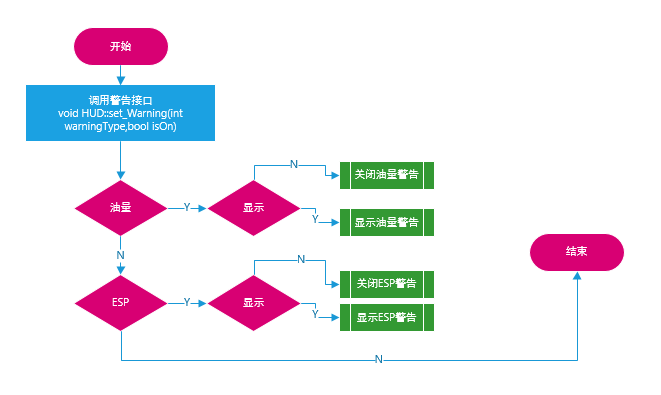

告警,我观察我车上的HUD只有两个表示,一个ESP一个是油量低时的提示
  1. #define WARNINGTYPE_GASOLINE 1 //油量警告
  2. #define WARNINGTYPE_ESP 2 //电子稳定系统,电子限滑
  1. void HUD::set_Warning(int warningType,bool isOn)
  2. {
  3. switch (warningType) {
  4. case WARNINGTYPE_GASOLINE:
  5. if(isOn)
  6. {
  7. ui->label_gasoline->show();
  8. }
  9. else
  10. {
  11. ui->label_gasoline->hide();
  12. }
  13. break;
  14. case WARNINGTYPE_ESP:
  15. if(isOn)
  16. {
  17. ui->label_esp->show();
  18. }
  19. else
  20. {
  21. ui->label_esp->hide();
  22. }
  23. break;
  24. default:
  25. break;
  26. }
  27. }
