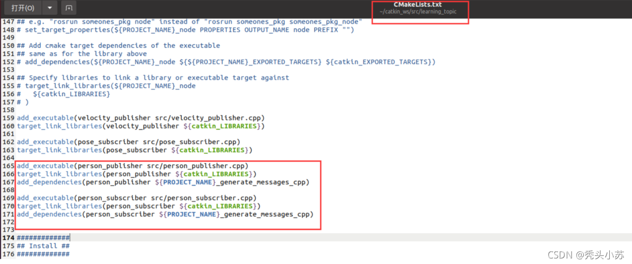

配置编译规则
- 设置需要编译的代码和可执行文件
- 设置链接库
- 添加依赖项
add_executable(person_publisher src/person_publisher.cpp) target_link_libraries(person_publisher ${catkin_LIBRARIES}) add_dependencies(person_publisher ${PROJECT_NAME}_generate_messages_cpp) add_executable(person_subscriber src/person_subscriber.cpp) target_link_libraries(person_subscriber ${catkin_LIBRARIES}) add_dependencies(person_subscriber ${PROJECT_NAME}_generate_messages_cpp)放置的具体位置如下:
