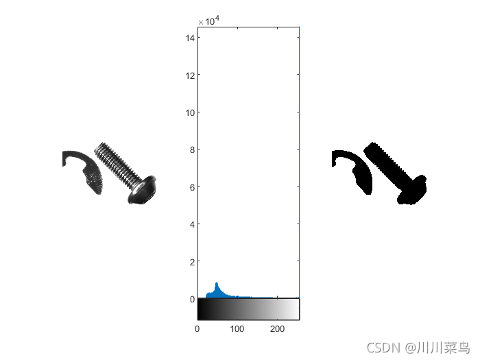

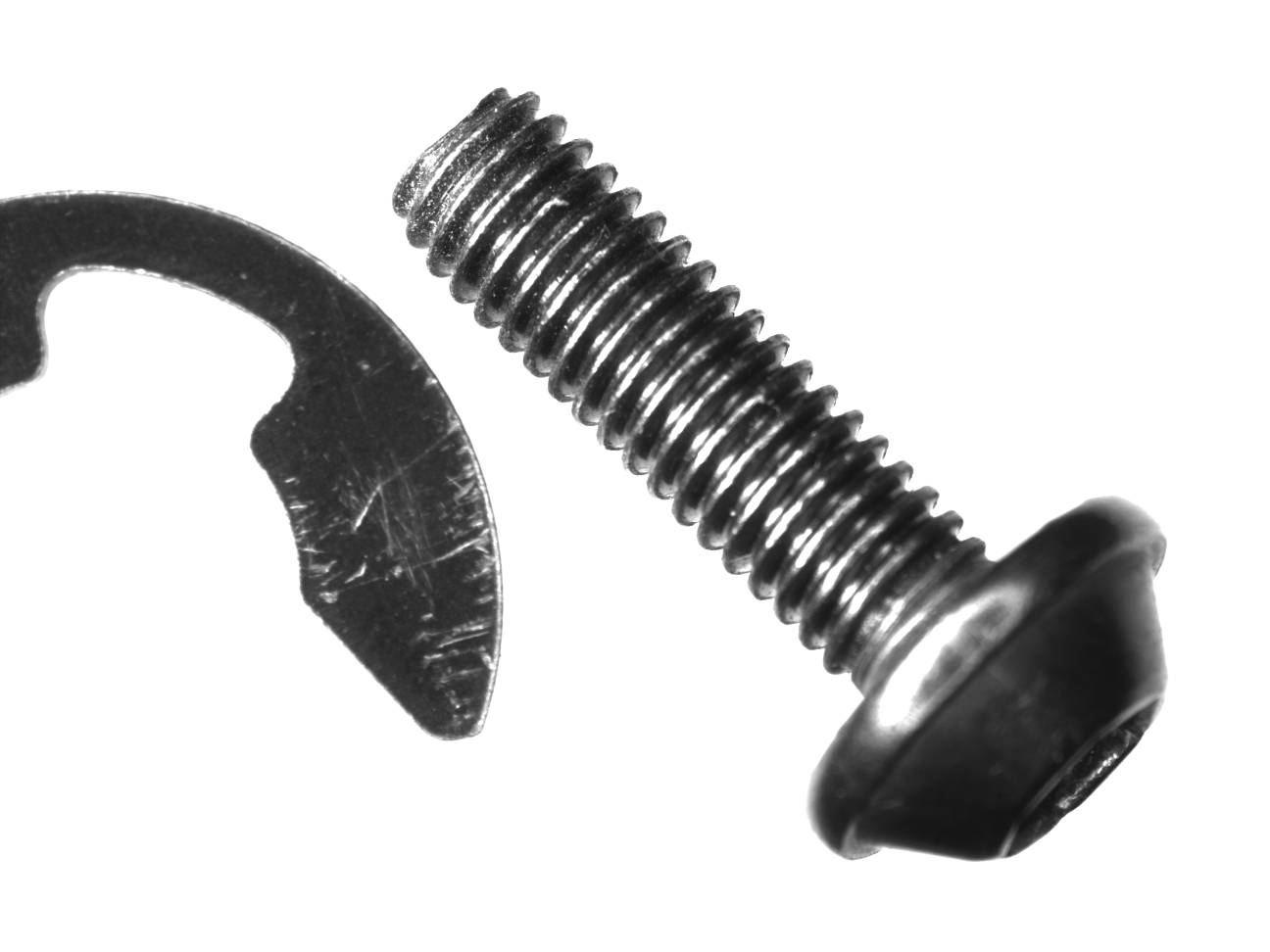

X1=imread('Pic1_3.bmp');
figure
subplot(131)
imshow(X1)
subplot(132)
imhist(X1)
XX1=im2bw(X1,254/255);
subplot(133)

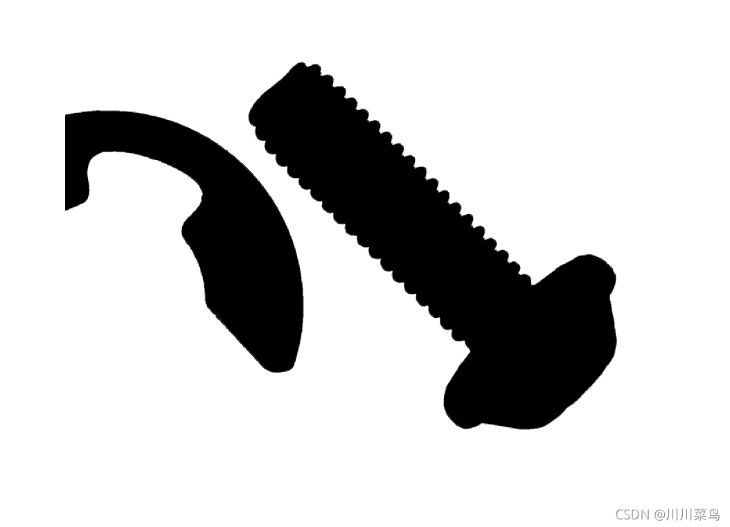

for kk=1:2
m=30;
for i=m+1:size(XX1,1)-m
    for j=m+1:size(XX1,2)-m
        a=XX1(i-m:i+m,j-m:j+m);
        if length(find(a(1:m,m+1)==0))>0 & length(find(a(m+1:end,m+1)==0))>0 & length(find(a(m+1,1:m)==0))>0 & length(find(a(m+1,m+1:end)==0))>0
            XX1(i,j)=0;
        end
    end
end
end
imshow(XX1)

[~,b]=max(psnr_list);
result=M{1,b};
figure
imshow(result)

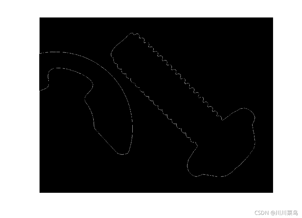

result=im2bw(result,0.3);
Y1=bwperim(result);
imshow(Y1)
imwrite(Y1,'pic1.bmp')
