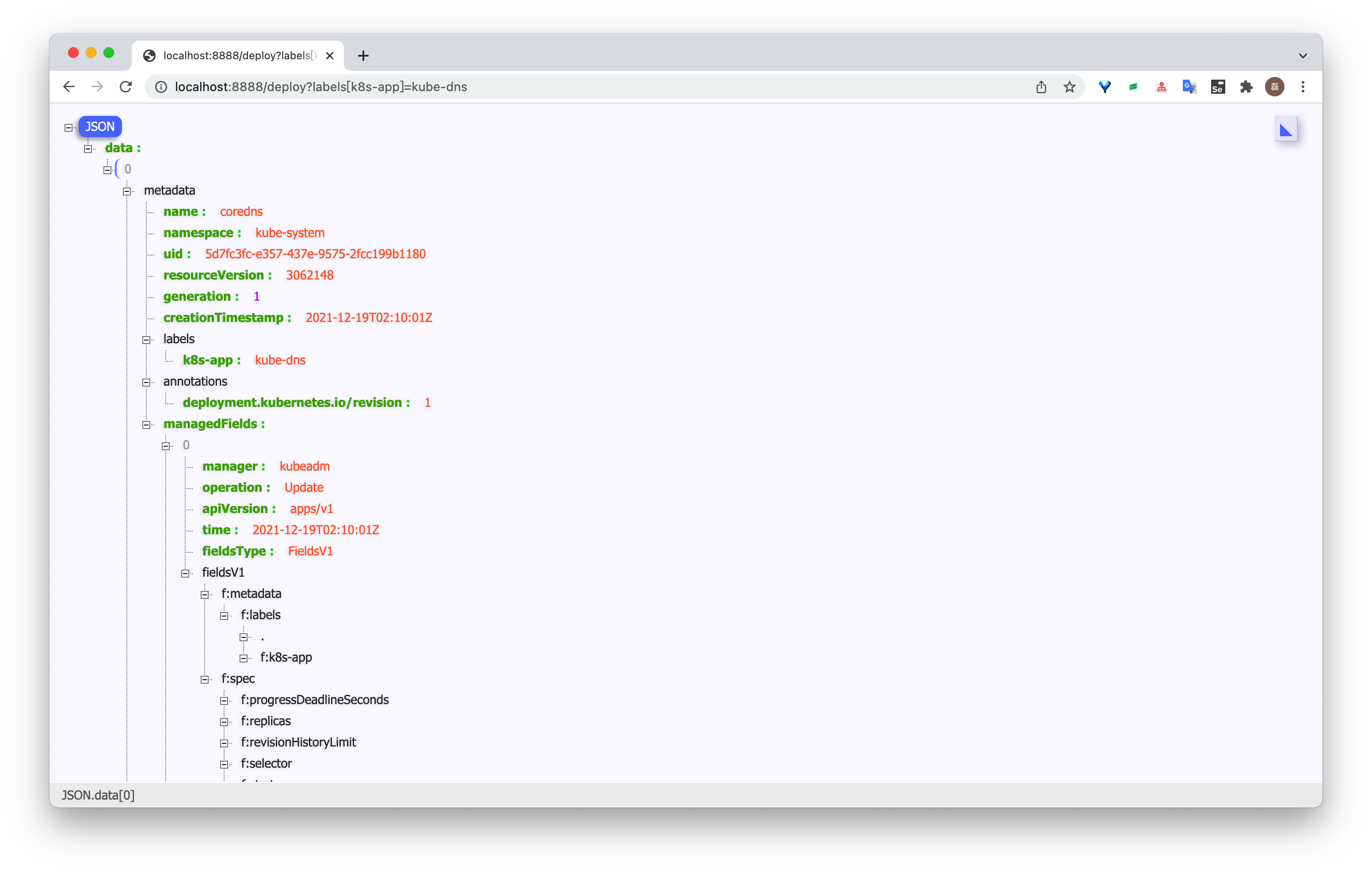

4.2 通过Gin实现K8s资源获取
4.2.1 单个资源对象获取
通过生成deployinformer,通过gin框架暴露访问入口,通过informer中的indexer来获取deployment资源。
func main() {
  clientSet, err := initClientSet()
  if err != nil {
    log.Fatal(err)
  sharedInformerFactory := informers.NewSharedInformerFactory(clientSet, 0)
  // 获取deployinformeer
  deployInformer := sharedInformerFactory.Apps().V1().Deployments()
  _ = deployInformer.Informer()
  lister := deployInformer.Lister()
  stopCh := make(chan struct{})
  sharedInformerFactory.Start(stopCh)
  sharedInformerFactory.WaitForCacheSync(stopCh)
  // http://localhost:8888/deploy?labels[k8s-app]=kube-dns
  r := gin.Default()
  r.GET("/deploy", func(c *gin.Context) {
    var set map[string]string
    // 通过labels过滤deploy
    if content, ok := c.GetQueryMap("labels"); ok {
      set = content
    selectQuery := labels.SelectorFromSet(set)
    podList, err := lister.List(selectQuery)
    if err != nil {
      c.JSON(400, gin.H{
        "msg": err.Error(),
      return
    c.JSON(200, gin.H{
      "data": podList,
  r.Run(":8888")
  //<-stopCh

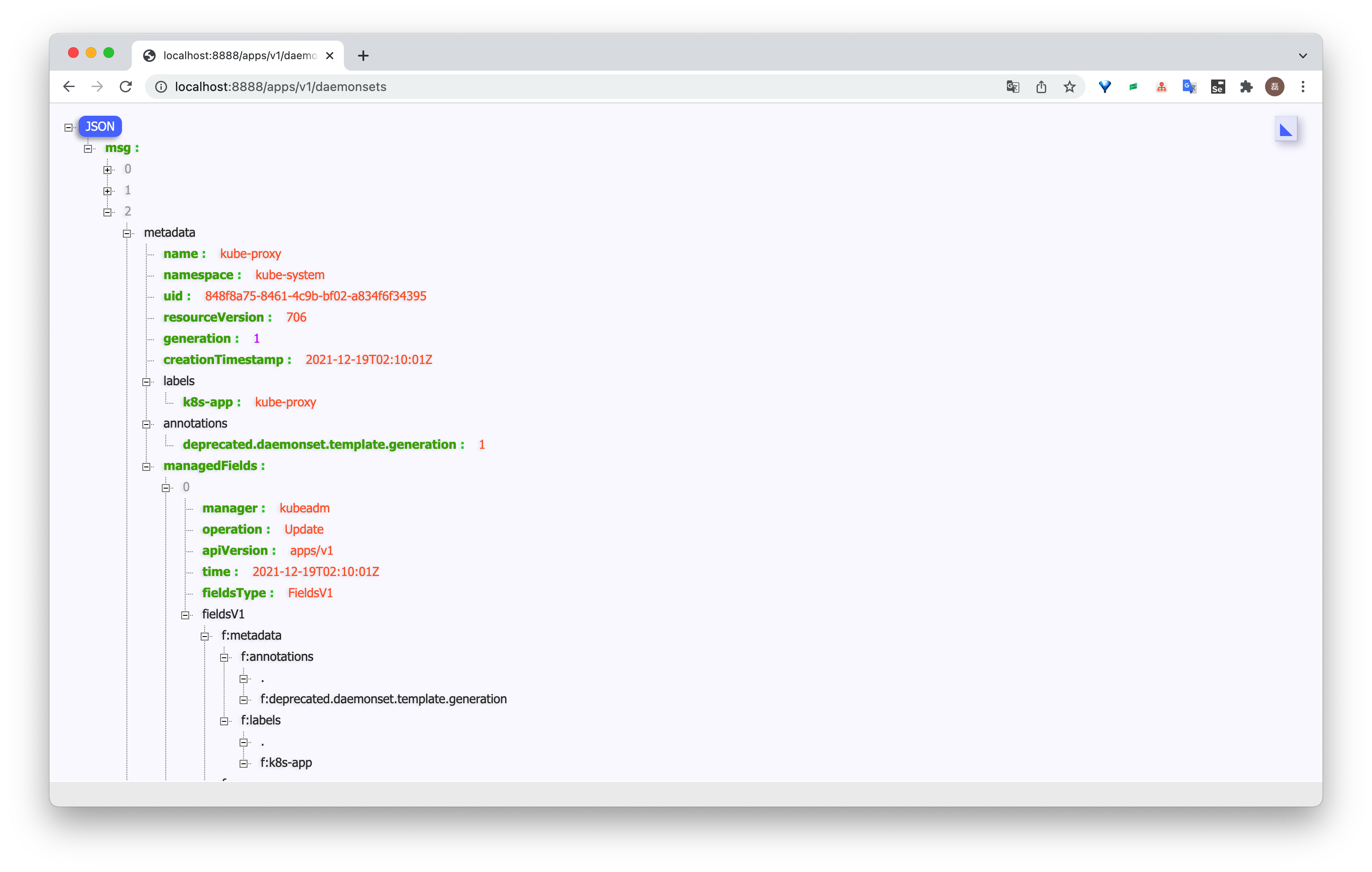

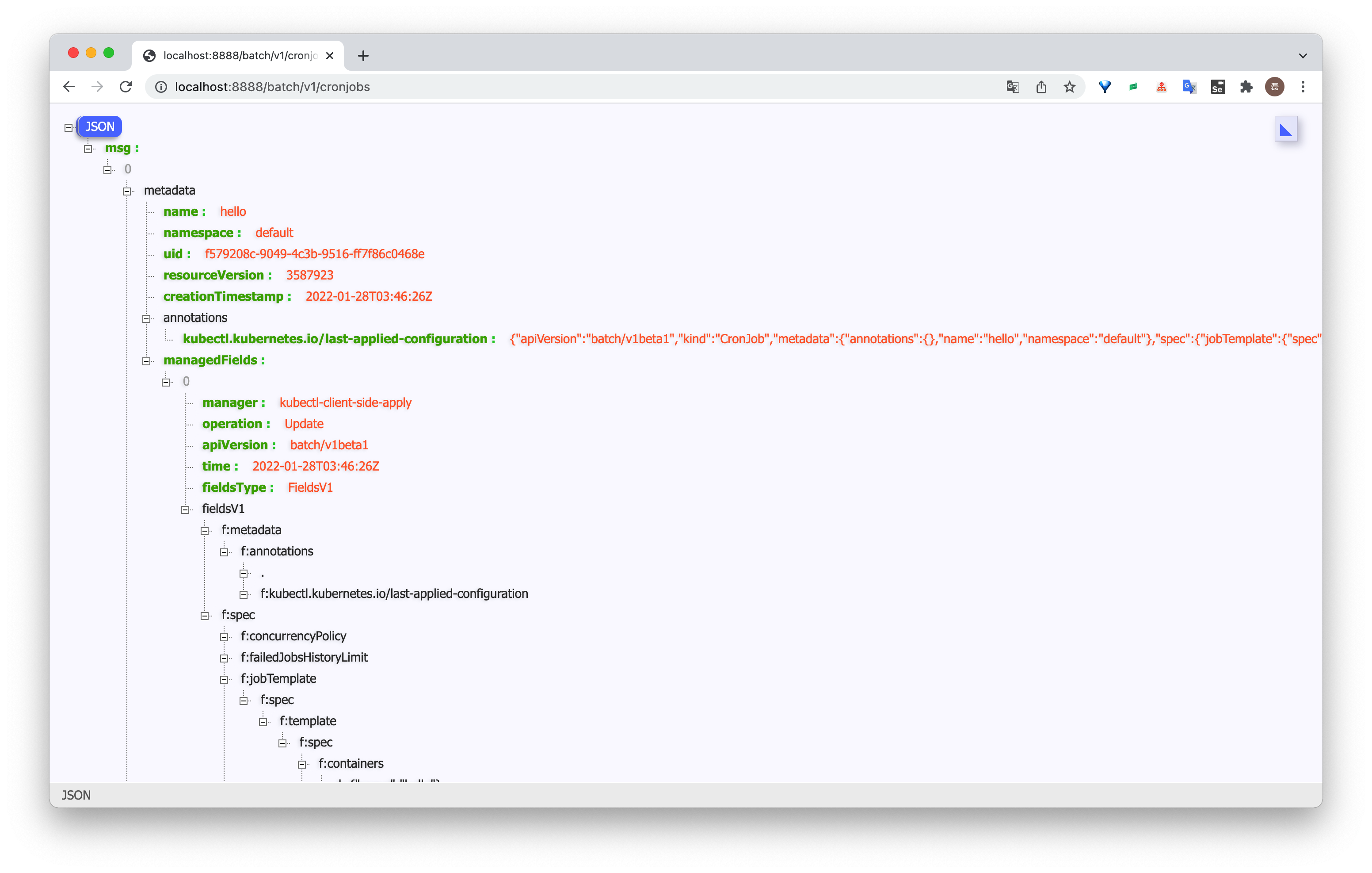

4.2.2 根据路径参数获取不同资源
之前的示例可以获取制定资源,下面示例将gvr通过gin路径参数传递进来,进而实现一个API可以获取K8s所有资源。
func main() {
  clientSet := InitClientSet()
  defer close(stopCh)
  engin := gin.Default()
  // 构造一个通用的根据不同group/version/kind 获取对象类型
  //http://localhost:8888/core/v1/pods
  engin.GET("/:group/:version/:resource", func(c *gin.Context) {
    g, v, r := c.Param("group"), c.Param("version"), c.Param("resource")
    // 如果是core组则为空字符串
    if g == "core" {
      g = ""
    gvr := schema.GroupVersionResource{g, v, r}
    genericInformer, _ := sharedInformerFactory.ForResource(gvr)
    _ = genericInformer.Informer()
    items, err := genericInformer.Lister().List(labels.Everything())
    if err != nil {
      c.JSON(500, gin.H{
        "msg": err,
    c.JSON(200, gin.H{
      "msg": items,
  engin.Run(":8888")
