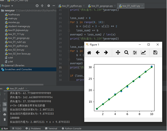

 (1)已知样本输入和标签如x.txt和y.txt所示,试使用Python求出i.) y=2x+2;ii.) y=x+3;iii.)y = 3x-1这三条直线哪个更加接近于样本给出的值。
 (2)对于上述数据,采用线性回归拟合出该线性方程。
 (要求:采用直接读取文件的方式,不要复制粘贴。)

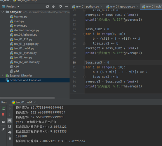

loss_sum1 = 0
for i in range(0, 10):
    a = (2 * x[i] + 2 - y[i]) ** 2
    loss_sum1 += a
average1 = loss_sum1 / len(x)
print("损失值为:%.15f"%average1)
loss_sum2 = 0
    b = (x[i] + 3 - y[i]) ** 2
    loss_sum2 += b
average2 = loss_sum2 / len(x)
print("损失值为:%.15f"%average2)
loss_sum3 = 0
    b = (3 * x[i] - 1 - y[i]) ** 2
    loss_sum3 += b
average3 = loss_sum3 / len(x)
print("损失值为:%.15f"%average3)
if (loss_sum1 < loss_sum2) and (loss_sum1 < loss_sum3):
    print("y=2x+2更加接近样本给出的值")
if (loss_sum2 < loss_sum1) and (loss_sum2 < loss_sum3):
    print("y=x+1更加接近样本给出的值")
else:
    print("y=3x-1更加接近样本给出的值")

k = [3, 0]
b = [-1, 0]
ones = 0
while True:
    dk, db = 0, 0
        dk += 2 / 10 * (k[0] * x[i] + b[0] - y[i]) * x[i]
        db += 2 / 10 * (k[0] * x[i] + b[0] - y[i])
    k[1] = k[0] - 0.001 * dk
    b[1] = b[0] - 0.001 * db
    if ones == 100000:
        break
    else:
        k[0] = k[1]
        b[0] = b[1]
        ones += 1
print("拟合回归方程的斜率k为:%.7f"%k[1])
print("拟合回归方程的斜率k为:%.7f"%b[1])
print(ones)
print("拟合回归方程为:%.7f * x + %.7f" % (k[1], b[1]))
x = np.array(x)
y = np.array(y)
Y = k[1] * x + b[1]
plt.scatter(x, y)
plt.plot(x, Y, '*-g')
plt.show()
