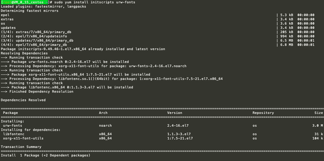

下载文件
wget https://dl.grafana.com/oss/release/grafana-6.2.5-1.x86_64.rpm
sudo yum install initscripts urw-fonts
  • 1
  • 2
sudo rpm -Uvh grafana-6.2.5-1.x86_64.rpm
  • 1
Preparing...                          ################################# [100%]
Updating / installing...
   1:grafana-6.2.5-1                  ################################# [100%]
### NOT starting on installation, please execute the following statements to configure grafana to start automatically using systemd
sudo /bin/systemctl daemon-reload
sudo /bin/systemctl enable grafana-server.service
### You can start grafana-server by executing
sudo /bin/systemctl start grafana-server.service
