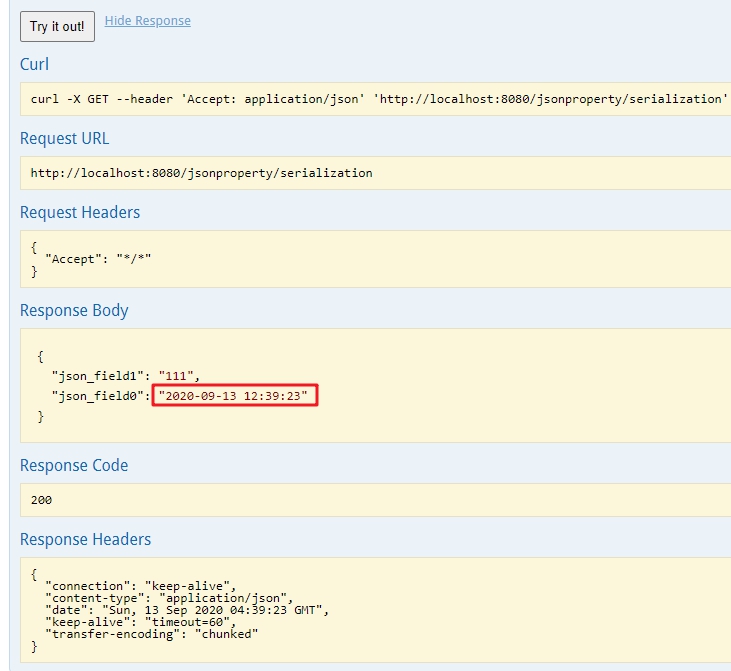

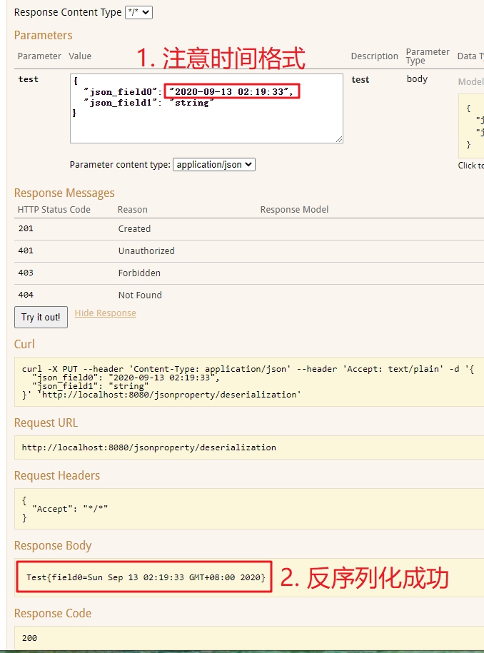

  1. 启动SpringbootConfigBeanApplication后,浏览器打开:http://localhost:8080/swagger-ui.html
  2. 先验证序列化接口/jsonproperty/serialization:
  3. 再验证反序列化接口 /jsonproperty/deserialization:
