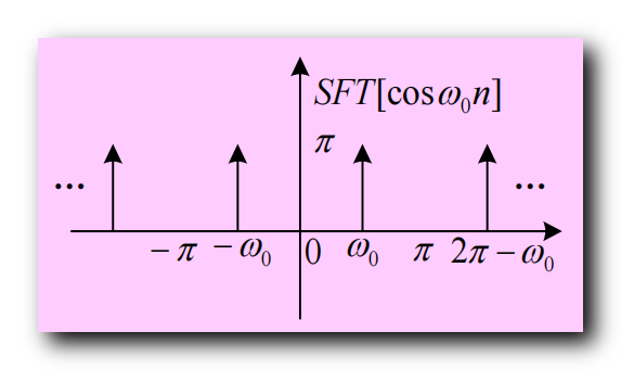

S F T [ cos ⁡ ω 0 n ] SFT[\cos \omega_0 n] SFT[cosω0n] 如下图所示 :
