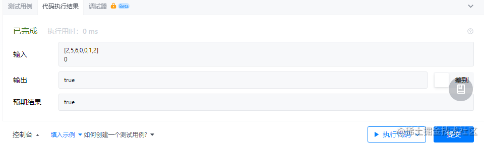

输入: nums = [2,5,6,0,0,1,2], target = 0
输出: true

class Solution {
    public boolean search(int[] nums, int target) {
        int n = nums.length;
        if (n == 0) {
            return false;
        if (n == 1) {
            return nums[0] == target;
        int l = 0, r = n - 1;
        while (l <= r) {
            int mid = (l + r) / 2;
            if (nums[mid] == target) {
                return true;
            if (nums[l] == nums[mid] && nums[mid] == nums[r]) {
                ++l;
                --r;
            } else if (nums[l] <= nums[mid]) {
                if (nums[l] <= target && target < nums[mid]) {
                    r = mid - 1;
                } else {
                    l = mid + 1;
            } else {
                if (nums[mid] < target && target <= nums[n - 1]) {
                    l = mid + 1;
                } else {
                    r = mid - 1;
        return false;
