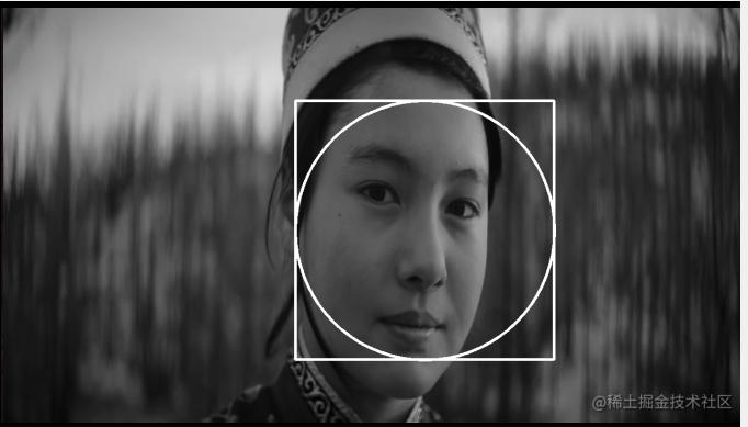

3.2 方法2: face_cascade.detectMultiScale
//人脸检测代码
void ImageHandle::opencv_face(QImage qImage)
    QTime time;
    time.start();
    //定义级联分类器
    CascadeClassifier face_cascade;
    //加载分类文件
    if(!face_cascade.load("C:/opencv/sources/data/haarcascades_cuda/haarcascade_frontalface_alt2.xml") )
        qDebug()<<"分类器加载错误";
        return;
    Mat frame=QImage2cvMat(qImage);
    cvtColor(frame, frame, COLOR_BGR2GRAY );//转换成灰度图像
    std::vector<Rect> faces;
    //正脸检测
    face_cascade.detectMultiScale(frame,faces);
    qDebug()<<tr("耗时:%1 ms  识别:%2  数量:%3\n").arg(time.elapsed()).arg(faces.size()).arg(faces.size());
    for ( size_t i = 0; i < faces.size(); i++ )
        //绘图画框和画圈
        Point center(faces[i].x + faces[i].width/2, faces[i].y + faces[i].height/2);
        ellipse(frame, center, Size( faces[i].width/2, faces[i].height/2 ), 0, 0, 360, Scalar( 255, 0, 255 ), 4 );
        rectangle(frame,
                  cvPoint(cvRound(faces[i].x), cvRound(faces[i].y)),
                  cvPoint(cvRound((faces[i].x + faces[i].width-1)),
                  cvRound((faces[i].y + faces[i].height-1))),
                  Scalar(255, 255, 255), 3, 8, 0);
//        //提取识别结果  取出的frame1 就是框住的图像
//        Mat frame1;
//        for(size_t i=0;i<faces.size();i++)
//            Point center(faces[i].x + faces[i].width / 2, faces[i].y + faces[i].height / 2);
//            frame1= frame(Rect(faces[i].x, faces[i].y, faces[i].width, faces[i].height));
    /*在控件上显示*/
    m_image=Mat2QImage(frame);
