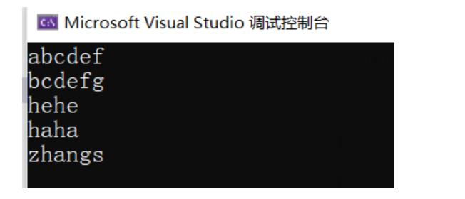

指针数组存放字符数组数组名
int main()
    const char* arr[5] = {"abcdef","bcdefg","hehe","haha","zhangs"};
    //arr数组存放的都是常量字符串,所以用const修饰数组
    int i= 0;
    for(i = 0;i<5;i++)
        printf("%s\n",arr[i]);
    return 0;
image-20220214205925089
打印字符串只需要提供起始地址就可以了,从起始位置向后打印 打印整形则要解引用才能里面的值
