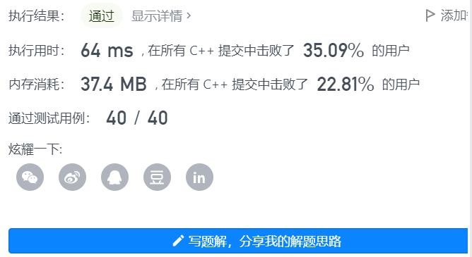

三、代码
class Solution {
public:
    int maxSumDivThree(vector<int>& nums) {
        int n = nums.size();
        vector<vector<int>> dp(n + 1, vector<int>(3, 0));
        dp[0][0] = 0;
        dp[0][1] = INT_MIN;
        dp[0][2] = INT_MIN;
        for(int i = 1;  i <= n; i++){
            if(nums[i - 1] % 3 == 0){
                dp[i][0] = max(dp[i - 1][0], dp[i - 1][0] + nums[i - 1]);
                dp[i][1] = max(dp[i - 1][1], dp[i - 1][1] + nums[i - 1]);
                dp[i][2] = max(dp[i - 1][2], dp[i - 1][2] + nums[i - 1]);
            }else if(nums[i - 1] % 3 == 1){
                dp[i][0] = max(dp[i - 1][0], dp[i - 1][2] + nums[i - 1]);
                dp[i][1] = max(dp[i - 1][1], dp[i - 1][0] + nums[i - 1]);
                dp[i][2] = max(dp[i - 1][2], dp[i - 1][1] + nums[i - 1]);
            }else if(nums[i - 1] % 3 == 2){
                dp[i][0] = max(dp[i - 1][0], dp[i - 1][1] + nums[i - 1]);
                dp[i][1] = max(dp[i - 1][1], dp[i - 1][2] + nums[i - 1]);
                dp[i][2] = max(dp[i - 1][2], dp[i - 1][0] + nums[i - 1]);
        return dp[n][0];
