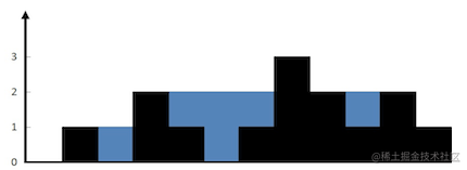

给定 n 个非负整数表示每个宽度为 1 的柱子的高度图,计算按此排列的柱子,下雨之后能接多少雨水。
示例图:
示例 1:
输入:height = [0,1,0,2,1,0,1,3,2,1,2,1]
输出:6
解释:上面是由数组 [0,1,0,2,1,0,1,3,2,1,2,1] 表示的高度图,在这种情况下,可以接 6 个单位的雨水(蓝色部分表示雨水)。

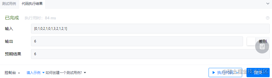

2、代码实现
代码参考:
 public class Solution//双指针
        public int Trap(int[] height)
            int left = -1; int right = 0;
            int sum = 0;
            for (int i = 0; i < height.Length; i++)
                if (height[i] != 0 && left == -1)
                    left = i;
                if (height[i]!=0)
                    right = i;
                sum += height[i];
            if (left == -1)
                return 0;
            int curHeight = Math.Min(height[left],height[right]);
            int volume = 0;
            while (left < right)
                int tempL = left; int tempR = right;
                while (left < right && height[left] <= curHeight)
                    left++;
                while (left < right && height[right] <= curHeight)
                    right--;
                volume += curHeight * (left - tempL - right + tempR);
                curHeight++;
            volume += height[left];
            return volume - sum;
