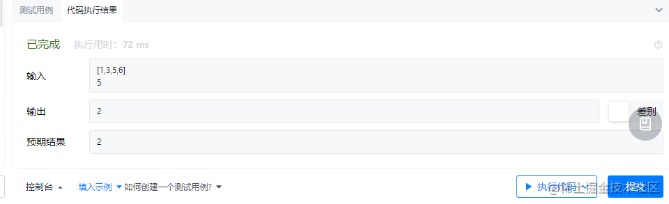

代码参考:
public class Solution {
    public int SearchInsert(int[] nums, int target) {
        int low = 0;
        int high = nums.Length - 1;
        int mid = 0;
        while (low <= high)
            mid = (low + high) / 2;
            if (target == nums[mid]) return mid;
            else if (target > nums[mid]) low = mid + 1;
            else high = mid - 1;
        if (target > nums[mid]) return mid + 1;
        else return mid;
3、时间复杂度
