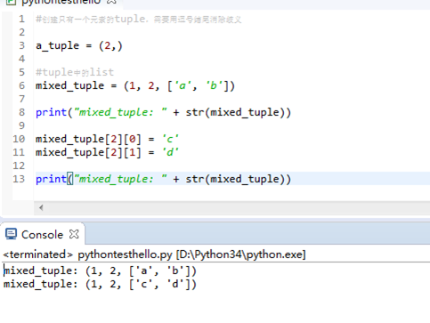

#创建只有一个元素的tuple,需要用逗号结尾消除歧义
a_tuple = (2,)
#tuple中的list
mixed_tuple = (1, 2, ['a', 'b'])
print("mixed_tuple: " + str(mixed_tuple))
mixed_tuple[2][0] = 'c'
mixed_tuple[2][1] = 'd'
-->所以 创建的tuple并没有更改 只是改了里面的list
