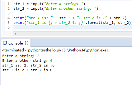

str_1 = input("Enter a string: ")
str_2 = input("Enter another string: ")
print("str_1 is: " + str_1 + ". str_2 is :" + str_2)
print("str_1 is {} + str_2 is {}".format(str_1, str_2))
