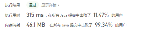

我的答案
class CQueue {
    Stack<Integer> stk1,stk2;
    int  size;
    public CQueue() {
        //初始化
         stk1 = new Stack<Integer>();
         stk2 = new Stack<Integer>();
         size =0;
    public void appendTail(int value) {
        //插入前先将栈1的全部移到栈2里面
        while(!stk1.isEmpty()){
            stk2.push(stk1.pop());
        //插入元素放入到栈1
        stk1.push(value);
        //将插入的元素再从栈2移回去栈1
        while(!stk2.isEmpty()){
            stk1.push(stk2.pop());
        size ++;
    public int deleteHead() {
        //直接弹出栈1
        if(size==0) return -1;
        int res = stk1.pop();
        size --;
        return res;
 * Your CQueue object will be instantiated and called as such:
 * CQueue obj = new CQueue();
 * obj.appendTail(value);
 * int param_2 = obj.deleteHead();
