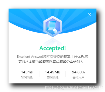

class Main {
        int index = new Solution().strStr("mabcban", "cb");
        System.out.println(index);
