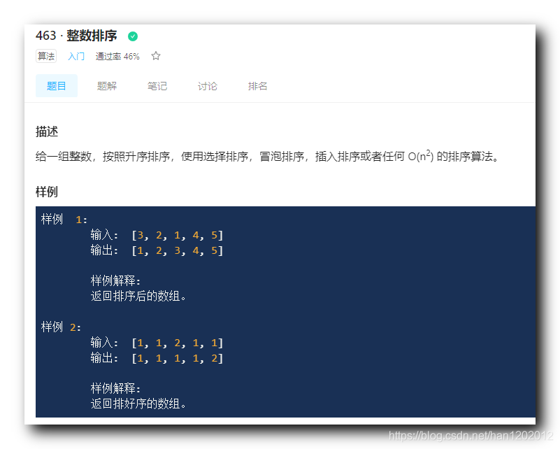

归并排序 : https://www.lintcode.com/problem/463
