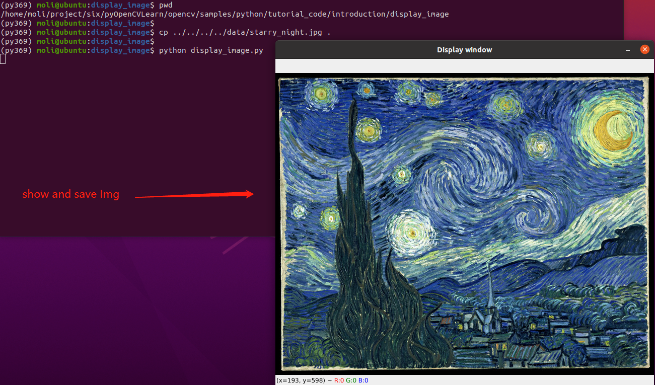

imshow and imsave【弹框和保存图片】
display_image.py 代码内容如下:

运行该代码:
cd opencv/samples/python/tutorial_code/introduction/display_image
cp ../../../../data/starry_night.jpg .
python display_image.py
- 1
- 2
- 3
- 4
- 5
- 6
效果如下:

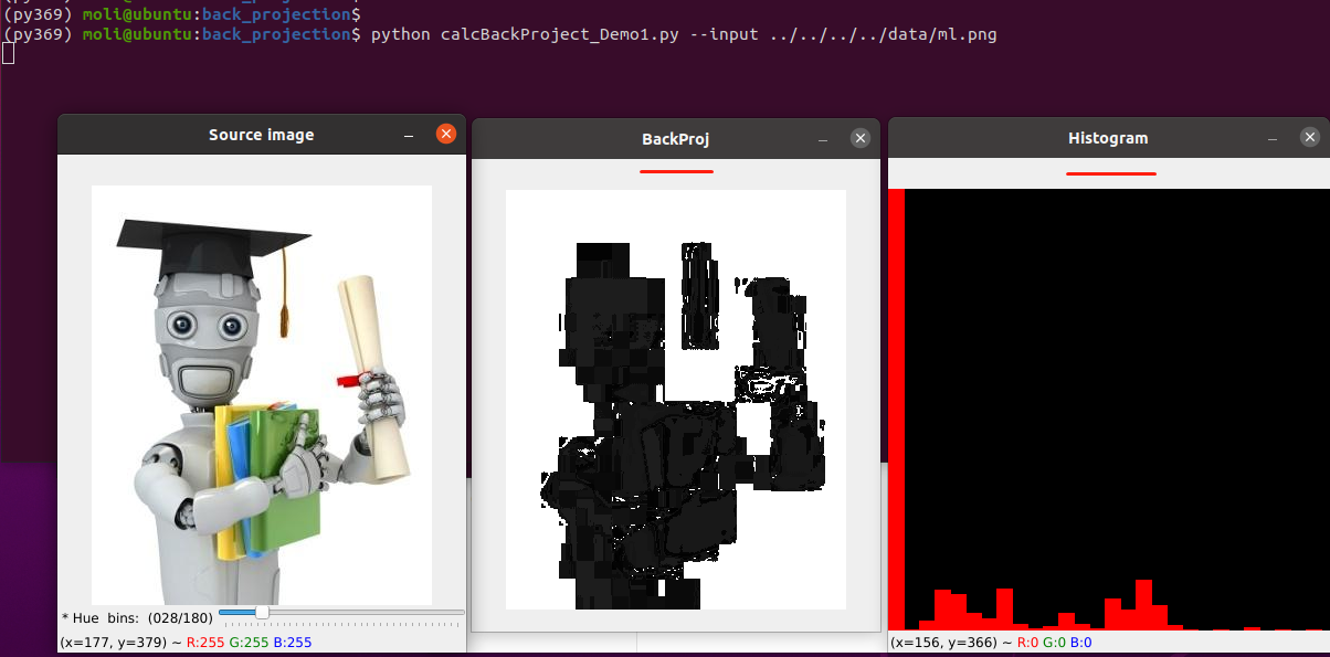

Back Projection【绘制直方图 - 反向投影 】
Back Projection 相关概念自行查阅;
运行代码一:
cd opencv/samples/python/tutorial_code/Histograms_Matching/back_projection
python calcBackProject_Demo1.py --input ../../../../data/ml.png
# 或者
python calcBackProject_Demo2.py --input ../../../../data/ml.png
