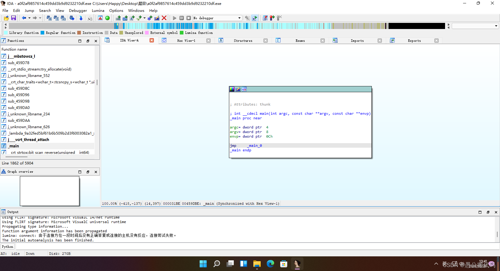

代码载入ida分析,字符串搜索main定位到入口函数
点击选择框中的‘main’,双击按F5再进入主函数伪代码:

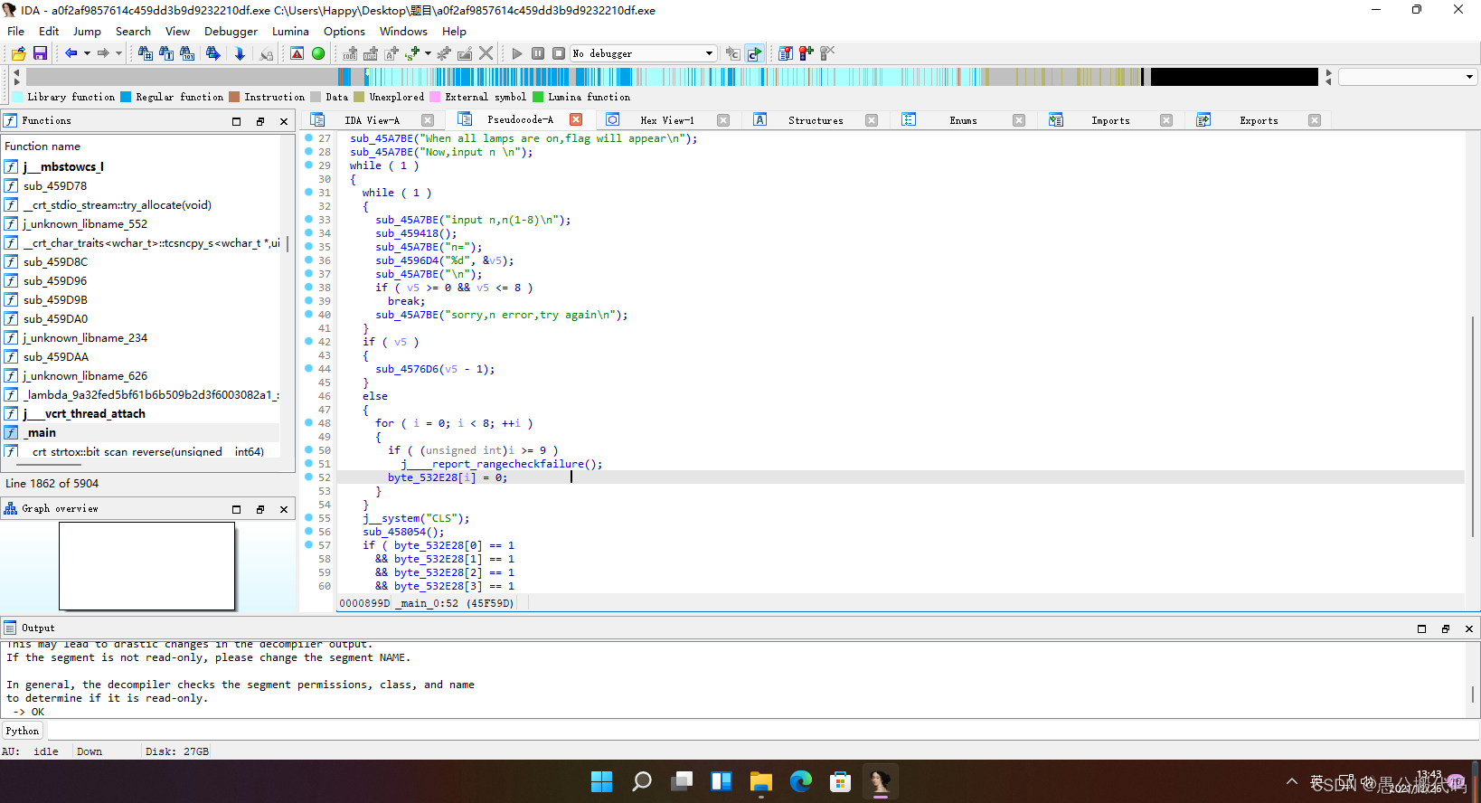

int __cdecl main_0(int argc, const char **argv, const char **envp)
  int i; // [esp+DCh] [ebp-20h]
  int v5; // [esp+F4h] [ebp-8h] BYREF
  sub_45A7BE(&unk_50B110);
  sub_45A7BE(&unk_50B158);
  sub_45A7BE(&unk_50B1A0);
  sub_45A7BE(&unk_50B1E8);
  sub_45A7BE(&unk_50B230);
  sub_45A7BE(&unk_50B278);
  sub_45A7BE(&unk_50B2C0);
  sub_45A7BE(&unk_50B308);
  sub_45A7BE(&unk_50AFD0);
  sub_45A7BE("|              by 0x61                                 |\n");
  sub_45A7BE("|                                                      |\n");
  sub_45A7BE("|------------------------------------------------------|\n");
  sub_45A7BE(
    "Play a game\n"
    "The n is the serial number of the lamp,and m is the state of the lamp\n"
    "If m of the Nth lamp is 1,it's on ,if not it's off\n"
    "At first all the lights were closed\n");
  sub_45A7BE("Now you can input n to change its state\n");
  sub_45A7BE(
    "But you should pay attention to one thing,if you change the state of the Nth lamp,the state of (N-1)th and (N+1)th w"
    "ill be changed too\n");
  sub_45A7BE("When all lamps are on,flag will appear\n");
  sub_45A7BE("Now,input n \n");
  while ( 1 )
    while ( 1 )
      sub_45A7BE("input n,n(1-8)\n");
      sub_459418();
      sub_45A7BE("n=");
      sub_4596D4("%d", &v5);
      sub_45A7BE("\n");
      if ( v5 >= 0 && v5 <= 8 )
        break;
      sub_45A7BE("sorry,n error,try again\n");
    if ( v5 )
      sub_4576D6(v5 - 1);
    else
      for ( i = 0; i < 8; ++i )
        if ( (unsigned int)i >= 9 )
          j____report_rangecheckfailure();
        byte_532E28[i] = 0;
    j__system("CLS");
    sub_458054();
    if ( byte_532E28[0] == 1
      && byte_532E28[1] == 1
      && byte_532E28[2] == 1
      && byte_532E28[3] == 1
      && byte_532E28[4] == 1
      && byte_532E28[5] == 1
      && byte_532E28[6] == 1
      && byte_532E28[7] == 1 )
      sub_457AB4();

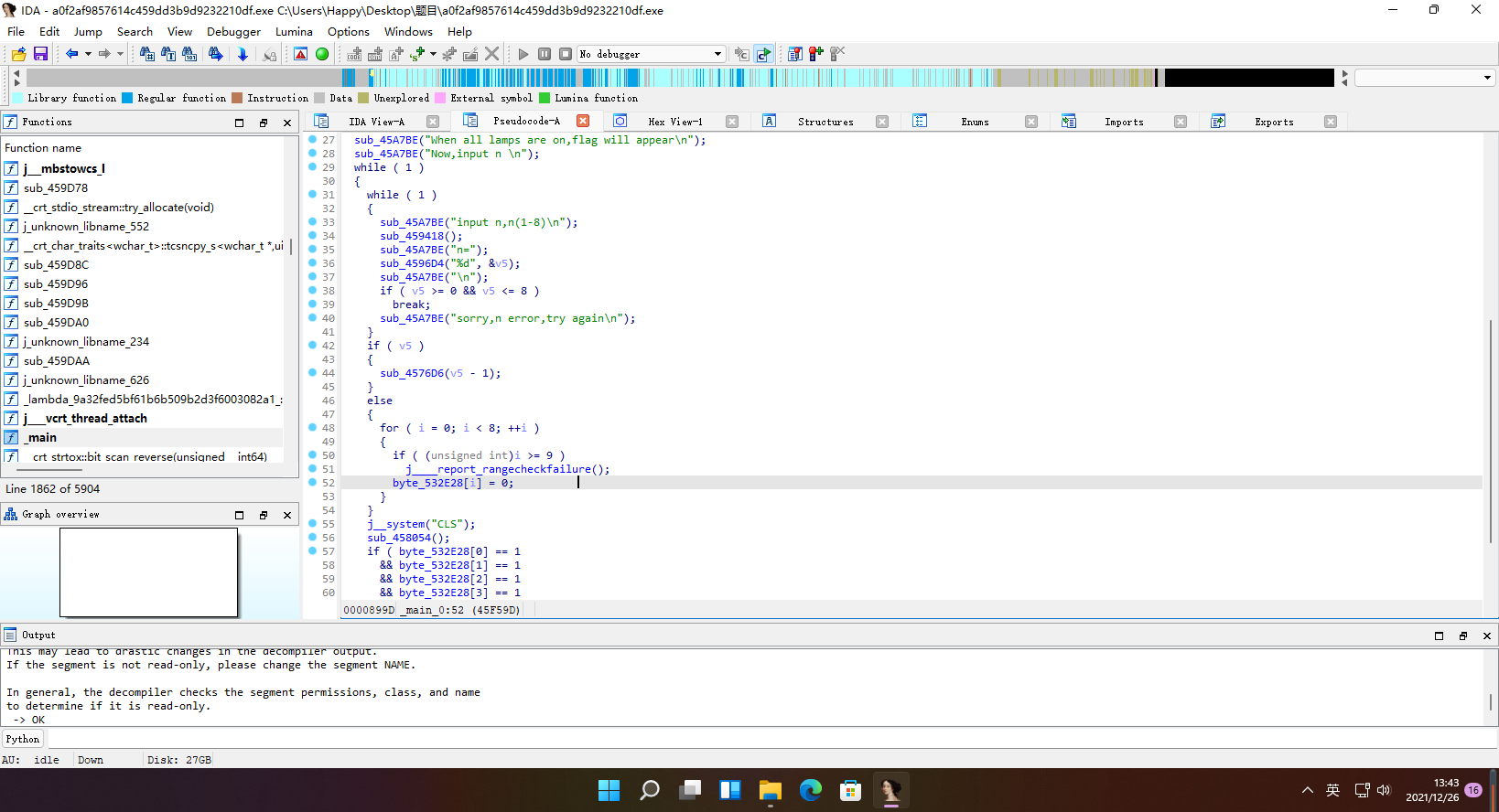

 分析可知下图中部分内容为是否出现flag的条件,因为八行中的每一行都变为1时,即全部通开时,调用函数sub_457AB4()

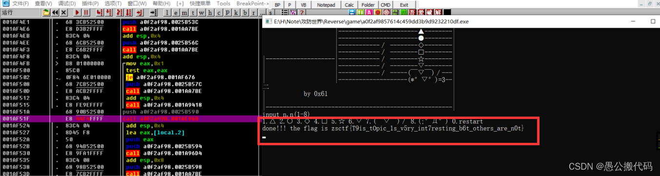

 运行得到flag:zsctf{T9is_tOpic_1s_v5ry_int7resting_b6t_others_are_n0t}

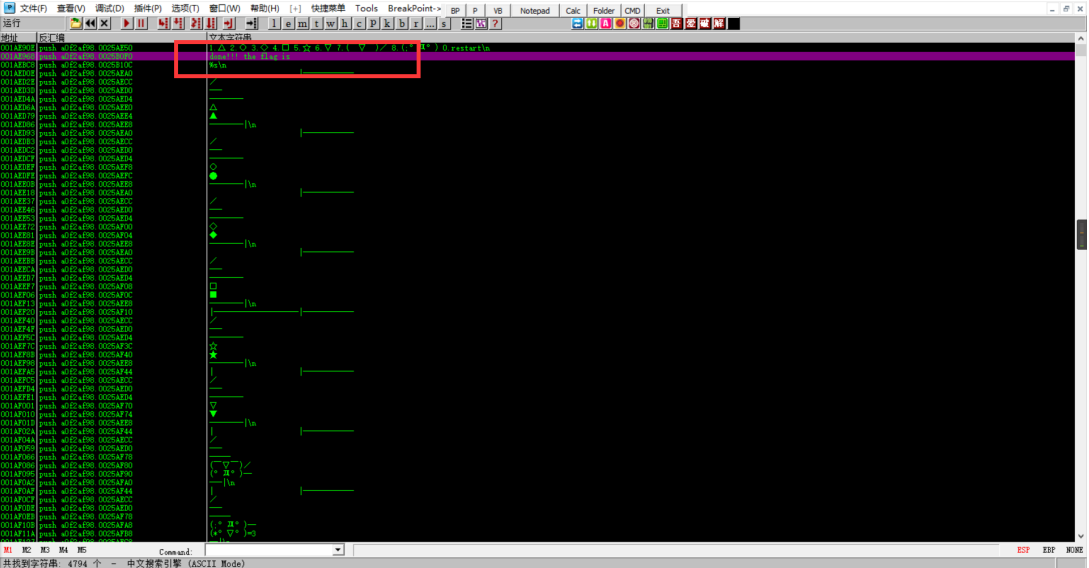

2.OD动态分析

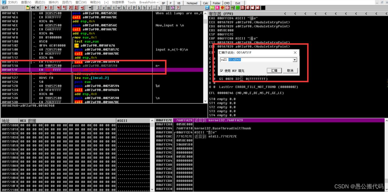

1.查询 flag 位置
 程序拖入OD,右键——》中文搜索引擎——》搜索 ASCII——》查询flag——》双击跳转函数开始位置
 2. 复制地址
跳转地址
001AE968 |. 68 F0B02500 push a0f2af98.0025B0F0
; done!!! the flag is

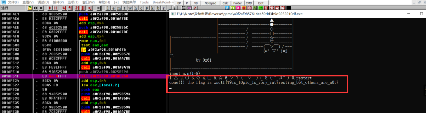

 3. 修改地址
 找到程序输入开始位置,修改调用函数地址,直接执行 flag 生成函数

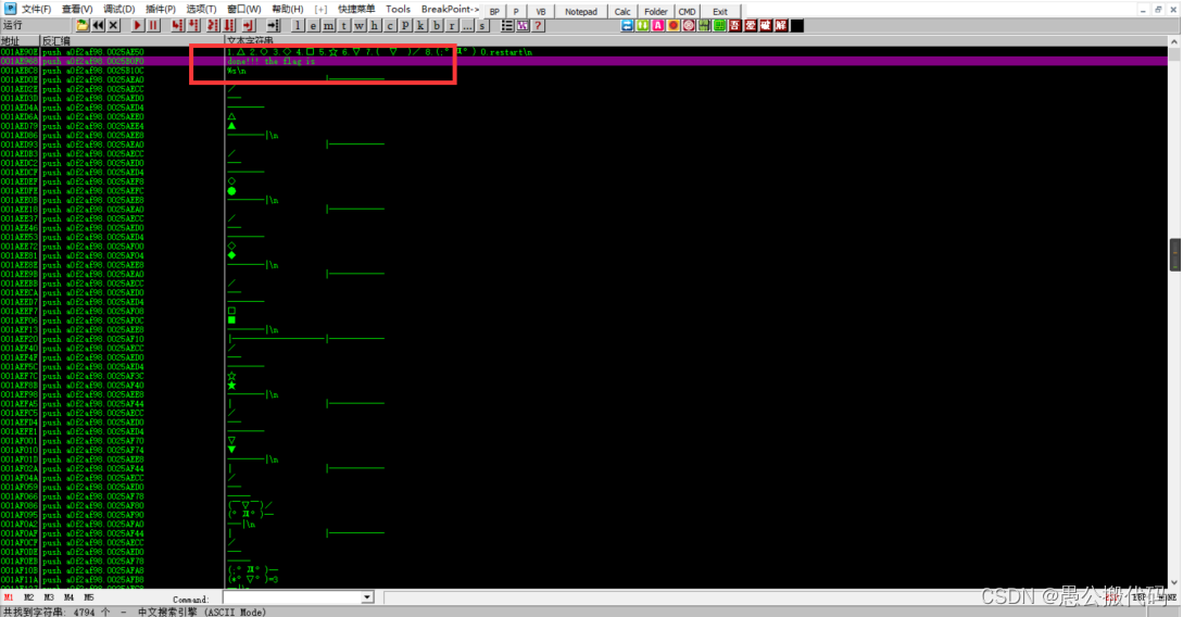

 4. 调试运行程序
 随便输入,直接获取 flag
总结
