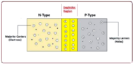

在PN结两边,存在一个由电子-空穴扩散而形成的耗散区,以及伴随着的接触电位 V 0 V_0 V0区,只有热量动能超过 V 0 V_0 V0的电子才能够从n型区域穿越到p型区域。根据统计力学原理,处在热平衡下电子的动能分布遵循 玻尔兹曼分布 。具有能量为 e V 0 eV_0 eV0的概率为:
其中 i d i_d id是漂移电流, a a a是比例常数, T T T是温度, k k k是玻尔兹曼常数。
▲ PN结的结构示意图
▲ PN结的结构示意图
这股漂移电流在耗散区建立一个电场 E d E_d Ed。到外部电压 V V V施加在PN结,产生电场 E D E_D ED,产生电流:

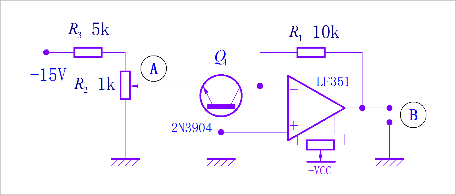

在推文开始提到的文章中,使用 2N3904 测试二极管的I-V特性。对于2N23904的电流放大和转换,选择了 LF356 运放进行I-V转换。 LF356的偏置电压为10mA和偏置电流为30pA。
下面是实验所使用的电路图。根据Measurement of Boltzmann’s constant 文献中描述,测量A,B两点的电压,便可以建立起 Q 1 Q_1 Q1的发射结对应的电压与电流之间的关系。
▲ 基于2N3904的PN结测量Boltzmann常数

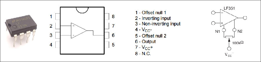

后级的 LF351 组成电流-电压转换电路,根据电路中的参数,B点的电压与流经 Q 1 Q_1 Q1集电极电流之间的关系为: U B = I Q 1 C × 1 0 4 U_B = I_{Q1C} \times 10^4 UB=IQ1C×104
▲ JFET输入的OPAMP-LF351运放
在实验中,使用DP1308可编程直流电源的-25V输出电压串联一个10kΩ电阻做为A点给定电源。使用FLUKE45测量A点电位,使用DM3068 6 1 2 6{1 \over 2} 621 位数字万用表测量B点的电压并自动记录。

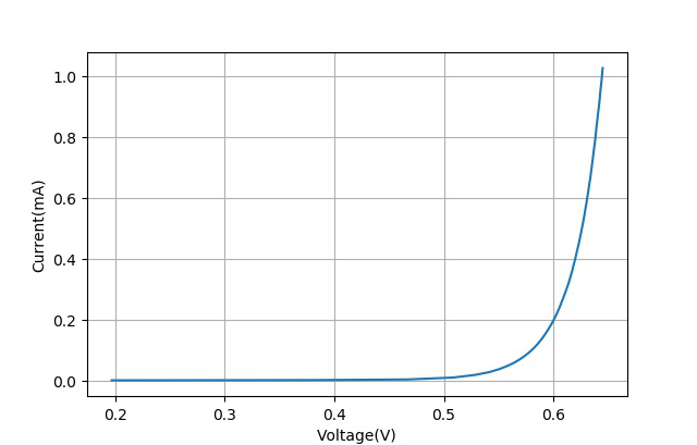

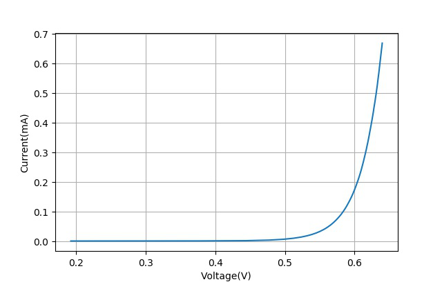

设置数字直流电源DP1308输出电压从**-0.2到-10V**,同时测量A,B两点的电压变化,并换算成PN结的电压-电流关系,绘制如下。
▲ 测量输入电压与电流曲线
▲ 测量输入电压与电流曲线
vv=[0.19666,0.29133,0.38548,0.46684,0.50835,0.52833,0.54163,0.55082,0.55782,0.56394,0.56880,0.57302,0.57684,0.58020,0.58313,0.58579,0.58826,0.59053,0.59258,0.59455,0.59635,0.59811,0.59976,0.60135,0.60275,0.60409,0.60543,0.60665,0.60770,0.60898,0.61006,0.61118,0.61223,0.61328,0.61428,0.61518,0.61598,0.61692,0.61765,0.61840,0.61921,0.61997,0.62064,0.62134,0.62205,0.62278,0.62345,0.62408,0.62466,0.62535,0.62587,0.62648,0.62706,0.62764,0.62818,0.62867,0.62918,0.62968,0.63024,0.63069,0.63112,0.63165,0.63213,0.63249,0.63295,0.63346,0.63395,0.63427,0.63469,0.63506,0.63545,0.63586,0.63621,0.63659,0.63696,0.63735,0.63777,0.63817,0.63844,0.63878,0.63909,0.63933,0.63971,0.64012,0.64046,0.64071,0.64112,0.64151,0.64182,0.64218,0.64246,0.64269,0.64300,0.64331,0.64365,0.64398,0.64429,0.64452,0.64475,0.64512]
cc=[0.00028,0.00066,0.00111,0.00309,0.00934,0.01789,0.02737,0.03718,0.04723,0.05752,0.06778,0.07812,0.08864,0.09908,0.10968,0.12018,0.13074,0.14143,0.15200,0.16262,0.17335,0.18394,0.19461,0.20535,0.21598,0.22666,0.23746,0.24814,0.25882,0.26961,0.28032,0.29097,0.30182,0.31250,0.32317,0.33402,0.34473,0.35559,0.36628,0.37702,0.38788,0.39856,0.40931,0.42017,0.43090,0.44163,0.45252,0.46324,0.47399,0.48485,0.49542,0.50630,0.51708,0.52794,0.53868,0.54945,0.56033,0.57108,0.58183,0.59272,0.60346,0.61422,0.62511,0.63587,0.64665,0.65752,0.66831,0.67906,0.68997,0.70074,0.71148,0.72239,0.73315,0.74391,0.75482,0.76557,0.77648,0.78723,0.79801,0.80891,0.81966,0.83042,0.84134,0.85209,0.86286,0.87379,0.88452,0.89531,0.90623,0.91701,0.92777,0.93868,0.94950,0.96025,0.97118,0.98193,0.99271,1.00364,1.01442,1.02530]

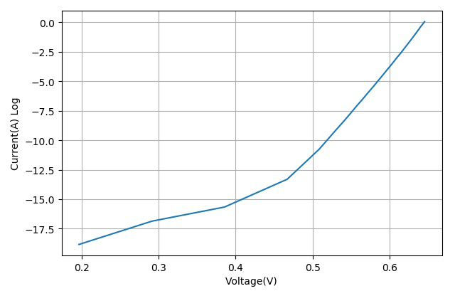

  • 1
  • 2
▲ 电流使用LOG尺度绘制的数据曲线
▲ 电流使用LOG尺度绘制的数据曲线
利用模型(3)匹配上述测量数据,将模式简化成下带有参数[a,b,c]的指数函数关系,利用前面测量的PN结I-V数据,使用SCIPY.OPTIMIZE中的curve_fit函数进行函数拟合,获得参数[a,b,c]的数值。
from scipy.optimize         import curve_fit
vv, cc = tspload('iv2n3904', 'vv', 'cc')
def func(x, a, b, c):
    return a * exp(x * b) + c
param = [0.001, 0.02, 0.0]
param, conv = curve_fit(func, vv, cc, p0=param)
printf(param)
  • 1
  • 2
  • 3
  • 4
  • 5
  • 6
  • 7
测量参数为:
a=2.33332986e-11
b=3.79731168e+01
c=8.85188988e-03
由模式(3)可以知道,参数b与Boltzmann常数之间的关系:
将常数e, T = 300(27摄氏度)代入上面公式,可以得到:
这个数值比现在测到得到精确的Botlzmann常数大了1.9%左右。在上述时间条件下,这个数值非常精确了。

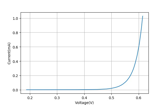

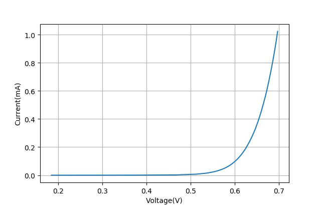

3. 基于NPN 8050测试Boltzmann常数
将前面所使用的三极管2N3904更换成另外一款NPN性的硅三极管8050,使用相同的测试方案完成8050的b-e结的电压-电流测试,所得到的数据曲线如下:
▲ 测试NPN8050的发射极PN结的I-V曲线
使用相同的方法进行建模,并计算参数:
这个数值比精确Boltzmann常数大了3.29%。

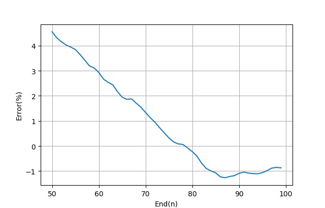

在实验[02-1]中,选择不同测量数据的来拟合估算Boltzmann常数会产生一定的变化。下面选择2N3904测量数据中,从数据编号n=10(对应电流:0.06mA)开始,结束数据编号n从50变化到100,使用模型(3)计算相应的Boltzmann常数,对应的误差曲线如下:
▲ 不同的二极管电流计算Boltzmann常数误差变化
从数值计算结果来看,使用前面数据测量范围(10~78),对应电流(0.06mA变化到0.7mA)时,测到得到的Boltzmann的误差最小。
