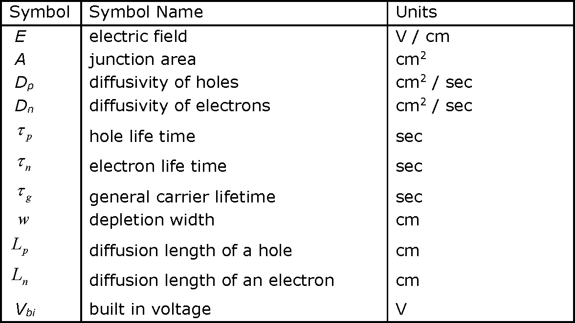

▲ 二极管特性公示中的符号说明
▲ 二极管特性公示中的符号说明

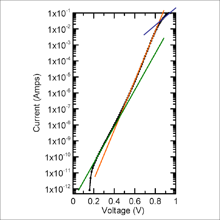

下面是整流二极管(1N4002)的分段I-V关系。
▲ 图1 二极管分段I-V关系
▲ 图1 二极管分段I-V关系
从上面公式来看,的确,当电压低于一定程度的时候,I-V的关系已经不在呈现模型所描述的情况了。因此,存在以下问题:
  • 究竟关系是什么?
  • 使用实验来测量这个关系,并进一步解释其中的原因。

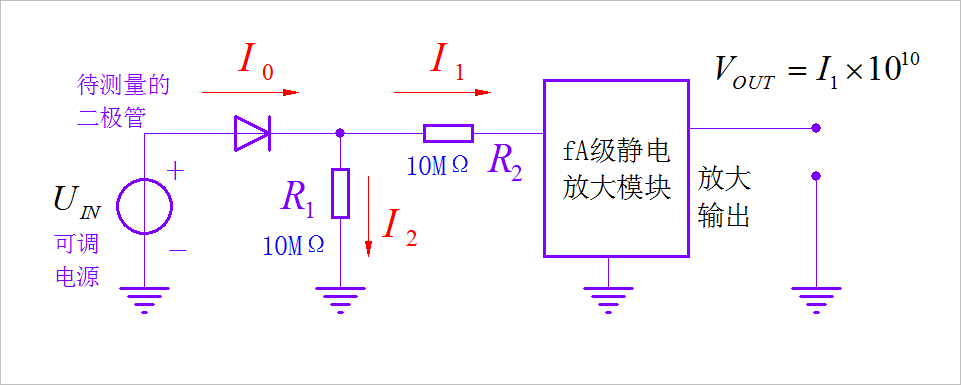

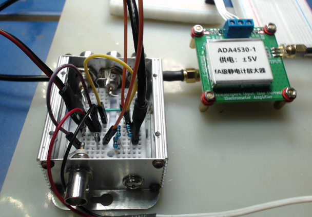

图1可以看到,我们需要测量的电流范围应该在 1 0 − 12 − 1 0 − 9 10^{ - 12} -10^{ - 9} 1012109之间,因此,需要能够测量在pA级别的电路能够进行测量。下面使用 ADA4531 fA级静电放大器 模块来进行测量。在面包板上搭建如下电路:
▲ 测量二极管电流电路图
▲ 测量二极管电流电路图
▲ 扩展量程之后的测量电路
▲ 扩展量程之后的测量电路
▲ 实验电路
▲ 实验电路

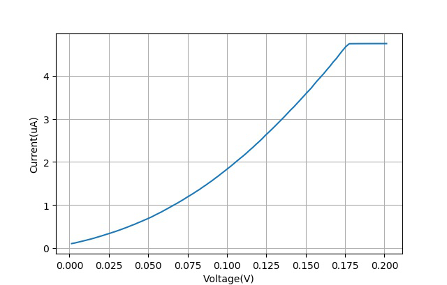

2.测量数据和结果分析
测量输出的电流与输入电流之间的关系如下图所示:
▲ 硅二极管I-V之间的关系
▲ 硅二极管I-V之间的关系

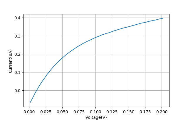

u1=[0.00,0.00,0.01,0.01,0.01,0.01,0.01,0.02,0.02,0.02,0.02,0.02,0.03,0.03,0.03,0.03,0.03,0.04,0.04,0.04,0.04,0.04,0.05,0.05,0.05,0.05,0.05,0.06,0.06,0.06,0.06,0.06,0.07,0.07,0.07,0.07,0.07,0.08,0.08,0.08,0.08,0.08,0.09,0.09,0.09,0.09,0.09,0.10,0.10,0.10,0.10,0.10,0.11,0.11,0.11,0.11,0.11,0.12,0.12,0.12,0.12,0.12,0.13,0.13,0.13,0.13,0.13,0.14,0.14,0.14,0.14,0.14,0.15,0.15,0.15,0.15,0.16,0.16,0.16,0.16,0.16,0.17,0.17,0.17,0.17,0.17,0.18,0.18,0.18,0.18,0.18,0.19,0.19,0.19,0.19,0.19,0.20,0.20,0.20,0.20]
c1=[-0.07,-0.05,-0.04,-0.03,-0.01,0.00,0.01,0.03,0.04,0.05,0.06,0.07,0.08,0.09,0.10,0.11,0.12,0.12,0.13,0.14,0.15,0.16,0.16,0.17,0.18,0.19,0.19,0.20,0.20,0.21,0.21,0.22,0.22,0.23,0.23,0.24,0.24,0.25,0.25,0.26,0.26,0.26,0.27,0.27,0.27,0.28,0.28,0.28,0.29,0.29,0.29,0.30,0.30,0.30,0.31,0.31,0.31,0.31,0.31,0.32,0.32,0.32,0.32,0.33,0.33,0.33,0.33,0.34,0.34,0.34,0.34,0.34,0.35,0.35,0.35,0.35,0.36,0.36,0.36,0.36,0.36,0.37,0.37,0.37,0.37,0.37,0.37,0.38,0.38,0.38,0.38,0.38,0.38,0.39,0.39,0.39,0.39,0.39,0.39,0.40]
  • 1
  • 2

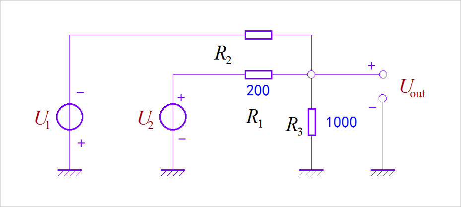

使用 RIGOL DP1308可编程电源,独立控制P25V和N25V的输出,通过电阻网络将它们合并在一起,形式一个可以有负电压平稳过渡到正电压的电压源。
▲ 基于RIGOL DP1308数控电源合成正负连续变化电源

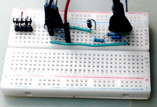

上面的电阻网络在面包板上进行搭建。测量电流的电路部分与前面相同。
▲ 测量实验电路
▲ 测量实验电路

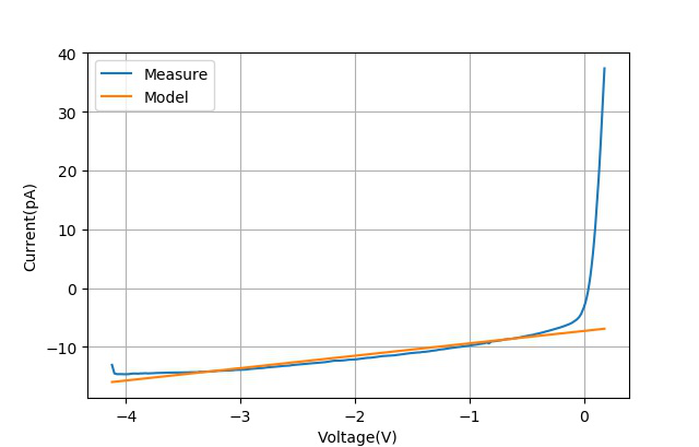

下面是测量施加电压从-4.5V增加到0.2V过程中电流的变化和数据。
▲ 实际Silicon整流二极管测量数据曲线
v=[-4.12,-4.10,-4.08,-4.06,-4.04,-4.02,-4.00,-3.98,-3.95,-3.93,-3.91,-3.89,-3.87,-3.85,-3.83,-3.81,-3.79,-3.77,-3.75,-3.73,-3.71,-3.69,-3.66,-3.64,-3.62,-3.60,-3.58,-3.56,-3.54,-3.52,-3.50,-3.48,-3.46,-3.44,-3.42,-3.40,-3.38,-3.36,-3.33,-3.31,-3.29,-3.27,-3.25,-3.23,-3.21,-3.19,-3.17,-3.15,-3.13,-3.11,-3.09,-3.07,-3.04,-3.02,-3.00,-2.98,-2.96,-2.94,-2.92,-2.90,-2.88,-2.86,-2.84,-2.82,-2.80,-2.78,-2.75,-2.73,-2.71,-2.69,-2.67,-2.65,-2.63,-2.61,-2.59,-2.57,-2.55,-2.53,-2.51,-2.49,-2.47,-2.45,-2.42,-2.40,-2.38,-2.36,-2.34,-2.32,-2.30,-2.28,-2.26,-2.24,-2.22,-2.20,-2.18,-2.16,-2.14,-2.11,-2.09,-2.07,-2.05,-2.03,-2.01,-1.99,-1.97,-1.95,-1.93,-1.91,-1.89,-1.87,-1.85,-1.82,-1.80,-1.78,-1.76,-1.74,-1.72,-1.70,-1.68,-1.66,-1.64,-1.62,-1.60,-1.58,-1.56,-1.54,-1.51,-1.49,-1.47,-1.45,-1.43,-1.41,-1.39,-1.37,-1.35,-1.33,-1.31,-1.29,-1.27,-1.25,-1.22,-1.20,-1.18,-1.16,-1.14,-1.12,-1.10,-1.08,-1.06,-1.04,-1.02,-1.00,-0.98,-0.96,-0.93,-0.91,-0.89,-0.87,-0.85,-0.83,-0.81,-0.79,-0.77,-0.75,-0.73,-0.71,-0.69,-0.66,-0.64,-0.62,-0.60,-0.58,-0.56,-0.54,-0.52,-0.50,-0.48,-0.46,-0.44,-0.42,-0.40,-0.38,-0.35,-0.33,-0.31,-0.29,-0.27,-0.25,-0.23,-0.21,-0.19,-0.17,-0.15,-0.13,-0.11,-0.09,-0.07,-0.04,-0.02,-0.02,-0.00,-0.00,-0.00,-0.00,0.00,0.00,0.00,0.00,0.00,0.01,0.01,0.01,0.01,0.01,0.01,0.01,0.01,0.01,0.01,0.01,0.01,0.02,0.02,0.02,0.02,0.02,0.02,0.02,0.02,0.02,0.02,0.02,0.03,0.03,0.03,0.03,0.03,0.03,0.03,0.03,0.03,0.03,0.03,0.04,0.04,0.04,0.04,0.04,0.04,0.04,0.04,0.04,0.04,0.04,0.05,0.05,0.05,0.05,0.05,0.05,0.05,0.05,0.05,0.05,0.06,0.06,0.06,0.06,0.06,0.06,0.06,0.06,0.06,0.06,0.06,0.07,0.07,0.07,0.07,0.07,0.07,0.07,0.07,0.07,0.07,0.07,0.08,0.08,0.08,0.08,0.08,0.08,0.08,0.08,0.08,0.08,0.08,0.08,0.09,0.09,0.09,0.09,0.09,0.09,0.09,0.09,0.09,0.09,0.09,0.10,0.10,0.10,0.10,0.10,0.10,0.10,0.10,0.10,0.10,0.10,0.11,0.11,0.11,0.11,0.11,0.11,0.11,0.11,0.11,0.11,0.11,0.12,0.12,0.12,0.12,0.12,0.12,0.12,0.12,0.12,0.12,0.12,0.13,0.13,0.13,0.13,0.13,0.13,0.13,0.13,0.13,0.13,0.13,0.14,0.14,0.14,0.14,0.14,0.14,0.14,0.14,0.14,0.14,0.14,0.15,0.15,0.15,0.15,0.15,0.15,0.15,0.15,0.15,0.15,0.15,0.16,0.16,0.16,0.16,0.16,0.16,0.16,0.16,0.16,0.16,0.16,0.17,0.17,0.17,0.17,0.17,0.17,0.17,0.17,0.17,0.17,0.17,0.18,0.18,0.18]
c=[-13.04,-14.48,-14.61,-14.61,-14.61,-14.63,-14.63,-14.61,-14.55,-14.51,-14.51,-14.54,-14.49,-14.49,-14.46,-14.49,-14.48,-14.46,-14.43,-14.41,-14.41,-14.39,-14.38,-14.37,-14.36,-14.36,-14.34,-14.33,-14.33,-14.32,-14.32,-14.32,-14.32,-14.29,-14.29,-14.28,-14.29,-14.21,-14.23,-14.20,-14.19,-14.17,-14.16,-14.13,-14.08,-14.04,-14.04,-14.02,-14.01,-13.99,-13.98,-13.95,-13.89,-13.89,-13.87,-13.86,-13.84,-13.78,-13.75,-13.71,-13.66,-13.61,-13.60,-13.59,-13.55,-13.49,-13.45,-13.43,-13.40,-13.35,-13.32,-13.28,-13.23,-13.21,-13.19,-13.15,-13.08,-13.04,-13.00,-12.95,-12.91,-12.86,-12.84,-12.82,-12.78,-12.75,-12.71,-12.68,-12.65,-12.62,-12.58,-12.51,-12.46,-12.40,-12.32,-12.33,-12.32,-12.30,-12.27,-12.22,-12.16,-12.14,-12.12,-12.10,-12.04,-11.98,-11.93,-11.88,-11.84,-11.83,-11.78,-11.73,-11.66,-11.61,-11.55,-11.53,-11.50,-11.47,-11.43,-11.42,-11.36,-11.29,-11.25,-11.20,-11.14,-11.09,-11.04,-11.00,-10.97,-10.93,-10.91,-10.84,-10.82,-10.77,-10.72,-10.64,-10.61,-10.54,-10.45,-10.41,-10.37,-10.30,-10.23,-10.17,-10.11,-10.06,-10.01,-9.97,-9.91,-9.85,-9.79,-9.75,-9.68,-9.63,-9.58,-9.50,-9.44,-9.37,-9.25,-9.39,-9.07,-9.04,-8.98,-8.92,-8.88,-8.78,-8.71,-8.65,-8.65,-8.58,-8.53,-8.45,-8.38,-8.28,-8.21,-8.12,-8.03,-7.98,-7.89,-7.78,-7.70,-7.60,-7.49,-7.37,-7.27,-7.15,-7.03,-6.92,-6.81,-6.69,-6.55,-6.40,-6.26,-6.09,-5.89,-5.61,-5.35,-4.92,-4.30,-4.23,-3.35,-3.27,-3.20,-3.08,-3.03,-3.04,-2.99,-2.96,-2.87,-2.82,-2.78,-2.71,-2.65,-2.60,-2.55,-2.47,-2.40,-2.35,-2.27,-2.21,-2.15,-2.06,-2.00,-1.90,-1.85,-1.79,-1.72,-1.63,-1.56,-1.49,-1.39,-1.33,-1.25,-1.14,-1.05,-0.98,-0.91,-0.82,-0.75,-0.68,-0.55,-0.46,-0.38,-0.27,-0.17,-0.08,0.07,0.19,0.28,0.36,0.52,0.61,0.72,0.83,0.93,1.09,1.21,1.36,1.48,1.59,1.69,1.83,1.96,2.07,2.21,2.33,2.44,2.56,2.86,2.95,3.09,3.23,3.31,3.43,3.66,3.79,3.94,4.10,4.23,4.37,4.62,4.79,4.93,5.10,5.23,5.38,5.65,5.81,6.01,6.12,6.30,6.45,6.58,6.85,7.08,7.23,7.40,7.57,7.74,8.01,8.20,8.39,8.60,8.79,8.99,9.29,9.48,9.66,9.88,10.07,10.26,10.49,10.80,11.02,11.24,11.44,11.63,11.83,12.13,12.37,12.58,12.80,13.03,13.29,13.65,13.89,14.09,14.38,14.61,14.84,15.24,15.51,15.71,15.95,16.24,16.47,16.69,17.06,17.33,17.53,17.81,18.04,18.29,18.71,19.00,19.20,19.45,19.70,19.97,20.41,20.78,21.03,21.47,21.78,22.06,22.38,22.63,22.89,23.33,23.62,23.86,24.18,24.49,24.78,25.09,25.54,25.88,26.15,26.52,26.78,27.07,27.58,27.88,28.17,28.49,28.81,29.13,29.63,29.94,30.24,30.59,30.87,31.18,31.68,32.03,32.33,32.63,32.95,33.27,33.57,34.09,34.39,34.70,35.04,35.40,35.73,36.27,36.61,36.92,37.33]
  • 1
  • 2
从图中可以看到在测量开始的时候,由于ADA4530 需要稳定一段时间。电压是从0V降低下来,还没有达到稳定,所以第一个测量数据有一点大的误差。实际稳定的测量应该从第二个数据开始绘制。

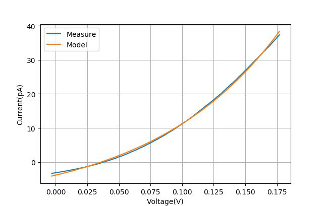

2.分析数据
使用指数模型对上述测量结果进行建模:
利用scipy.optimize中的curve_fit函数来进行曲线拟合,得到的参数为:[a,b,c]= [ 8.44483303 0.09925057 -11.89422983]
绘制出模型曲线与测量曲线:
▲ 对测量的硅二极管的典雅与电流曲线与建模曲线的对比
可以看到,对于施加电压对于0部分,拟合曲线的精度相当好。而对于电压小于0之后,测量的曲线电流就明显偏离了模型指数曲线了。
对测量数据施加电压小于0部分进行线性拟合:
得到对应的参数:[a,b]=[ 2.10646325 -7.27212467]
▲ 对测量结果施加电压小于0部分进行线性拟合
根据斜率a的数值,可以得到对应的等效电阻数值:

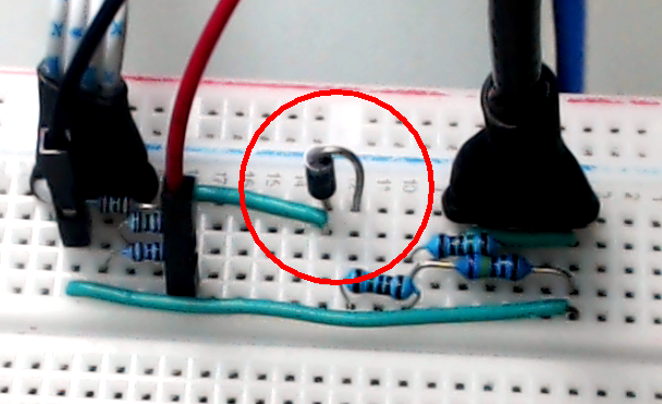

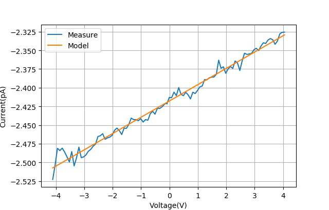

这个电阻很可能是由于二极管所在的面包板的相邻两个所造成的电阻泄露所引起的。这一点可以通过将二极管去掉然后重新测量I-V曲线来验证。
▲ 测量二极管以及所在的面包板
▲ 测量二极管以及所在的面包板
下面是将二极管去掉,重新扫描电压-4V~+4V之间电压与电流之间的关系。通过线性拟合,可以得到对应的曲线参数:[a,b]=[ 0.02182531 -2.41772746]
换算之后的等效电阻为:
▲ 将二极管去掉之后,测量施加电压与测量电流之间的曲线
这个数值比起前面二极管对应的电阻小了两个数量级,所以前面测量对于负电压之间的差别中存在的电阻主要是由二极管内部的电阻泄露所引起的。
使用前面参数[a,b,c]= [ 8.44483303 -0.09925057 -11.89422983]作为初始值,对于硅耳机的电压大于零的部分重新按照指数模型(2.2.1)进行参数辨识,可以得到对应的结果为:[a,b,c] = [ 9.12216015 0.10247578 -12.96444879]
▲ 只对施加电压大于零的部分进行指数建模

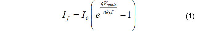

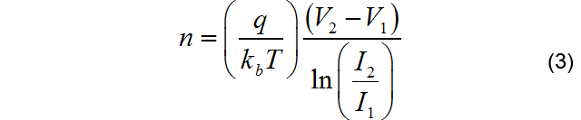

由前面公式(1)可以知道:
根据 Physics constants ,可以计算出来参数n的数值
