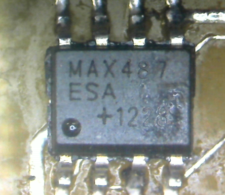

■ MAX487简介
MAX487是用于低功耗RS-485总线收发器。

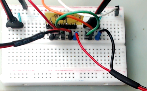

01实验电路设计
1.电路设计
▲ 实验电路原理图
▲ 实验电路原理图
▲ 实验电路板PCB
▲ 实验电路板PCB

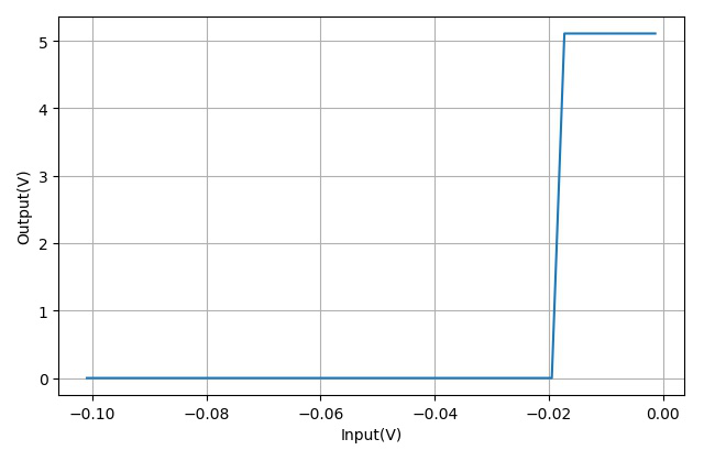

□ MAX487输入输出电压关系
▲ 输入和输出之间的关系
▲ MAX487输入和输出之间的关系
inv=[5.11,5.11,5.11,5.11,5.11,5.11,5.11,5.11,3.30,3.29,3.28,3.27,3.26,3.25,3.24,3.23,3.22,3.21,3.20,3.19,3.18,3.16,3.15,3.15,3.14,3.13,3.12,3.11,3.10,3.09,3.08,3.07,3.06,3.05,3.04,3.03,3.02,3.01,0.00,0.00,0.00,0.00,0.00,0.00,0.00,0.00,0.00,0.00,0.00,0.00]
outv=[-0.00,-0.00,-0.01,-0.01,-0.01,-0.01,-0.01,-0.02,-0.02,-0.02,-0.02,-0.02,-0.02,-0.03,-0.03,-0.03,-0.03,-0.03,-0.04,-0.04,-0.04,-0.04,-0.04,-0.05,-0.05,-0.05,-0.05,-0.05,-0.06,-0.06,-0.06,-0.06,-0.06,-0.07,-0.07,-0.07,-0.07,-0.08,-0.08,-0.08,-0.08,-0.09,-0.09,-0.09,-0.09,-0.09,-0.09,-0.10,-0.10,-0.10]

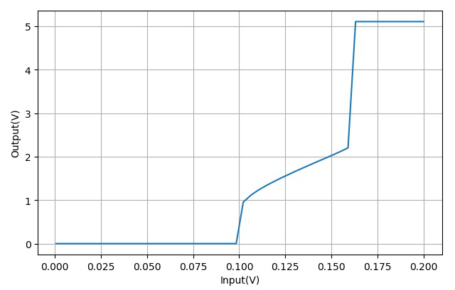

□ Sipex485输入输出之间的关系
▲ Sipexl485输入输出之间的关系
inv=[0.00,0.00,0.00,0.00,0.00,0.00,0.00,0.00,0.00,0.00,0.00,0.00,0.00,0.00,0.00,0.00,0.00,0.00,0.00,0.00,0.00,0.00,0.00,0.00,0.00,0.95,1.11,1.23,1.33,1.41,1.50,1.60,1.68,1.75,1.82,1.90,1.97,2.04,2.12,2.20,5.11,5.11,5.11,5.11,5.11,5.11,5.11,5.11,5.11,5.11]
outv=[0.00,0.00,0.01,0.01,0.02,0.02,0.02,0.03,0.03,0.04,0.04,0.05,0.05,0.05,0.06,0.06,0.07,0.07,0.07,0.08,0.08,0.09,0.09,0.09,0.10,0.10,0.11,0.11,0.11,0.12,0.12,0.13,0.13,0.14,0.14,0.14,0.15,0.15,0.15,0.16,0.16,0.17,0.17,0.18,0.18,0.18,0.19,0.19,0.20,0.20]

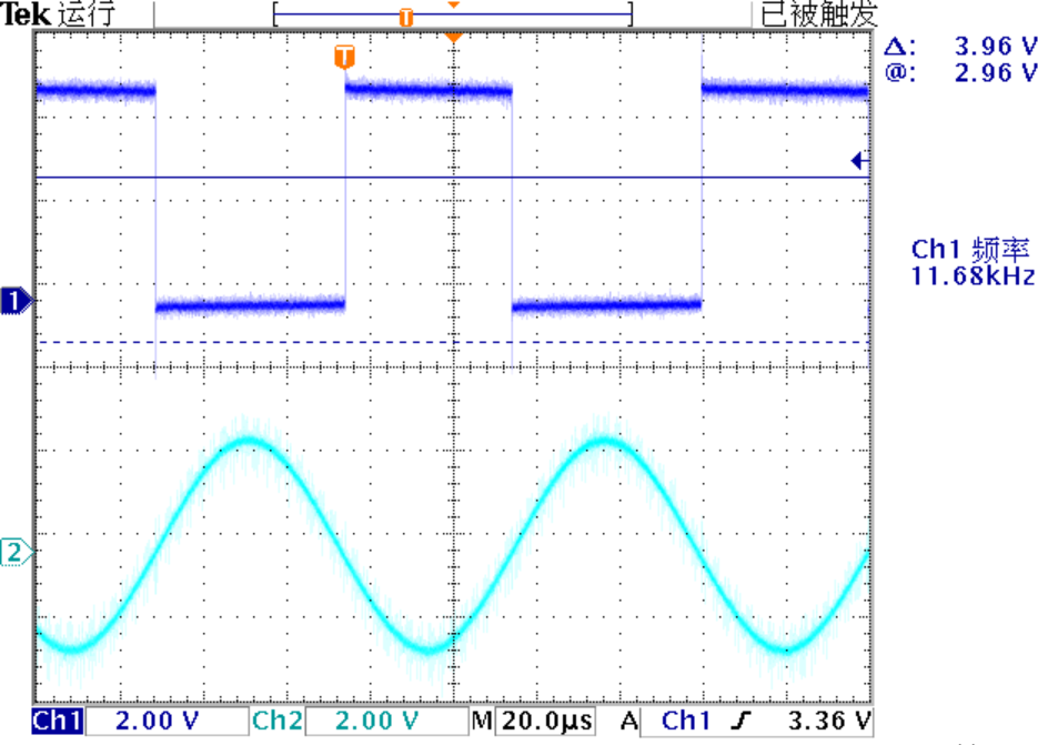

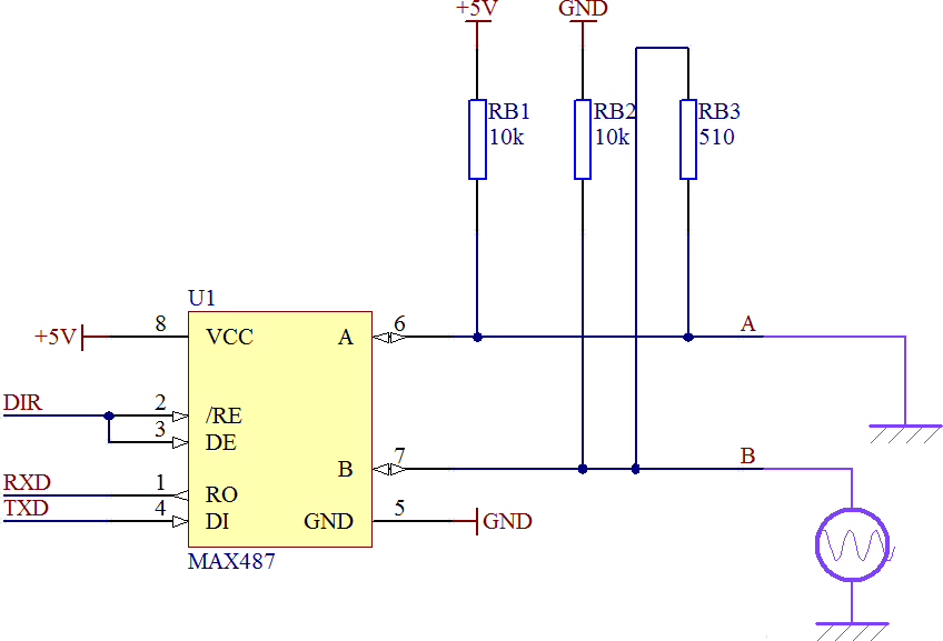

1. TXD←总线
在485总线B端加入交流信号。A端接地。测量RO的输出波形。
▲ 测量电路
▲ 测量电路
测量信号波形:
▲ 输入波形和输出波形
▲ 输入波形和输出波形

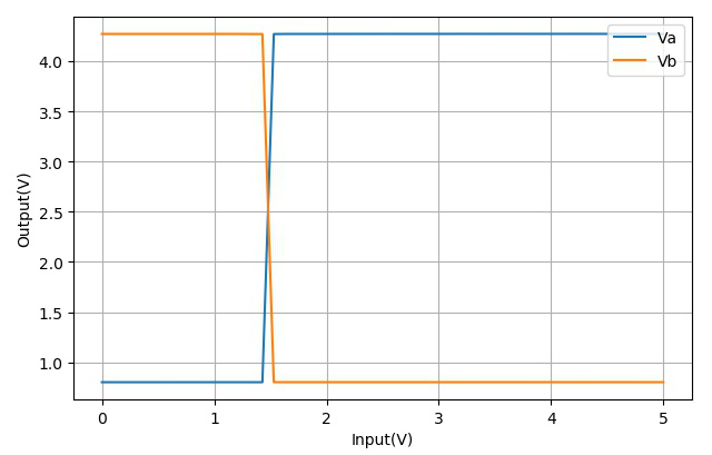

2.TXD→总线
  • <font size=5>补充这个实验</font>
▲ 测量TXD到VAB之间的传递关系
▲ 测量TXD到VAB之间的传递关系
▲ TXD→Vab
▲ TXD → Vab
▲ TXD → Vab
▲ TXD → Vab
▲ TXD → Vab
▲ TXD → Vab
▲ TXD → Vab
▲ TXD → Vab

  1. 对于MAX487组成的总线不需要另行进行偏置。Va<Vb 20mV之后,才有输出反转。
