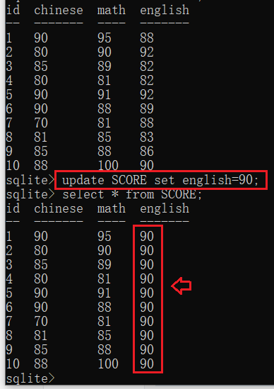

更新所有id的english为90,则不使用where指定条件即可:
update SCORE set english=90;

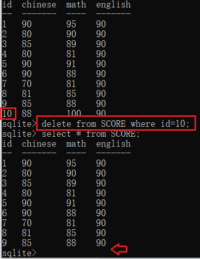

例如,删除id为10的记录:
delete from SCORE where id=10;

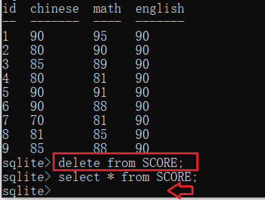

如果要删除所有的记录,则不加where语句:
delete from SCORE;

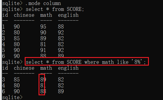

若要显示SCORE中math成绩以8开头的记录:
select * from SCORE where math like '8%';

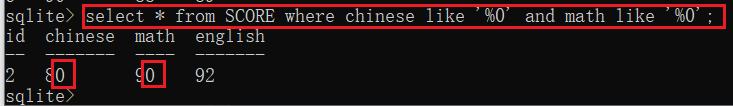

若要显示SCORE中chinese和math成绩以0结尾的记录:
select * from SCORE where chinese like '%0' and math like '%0';

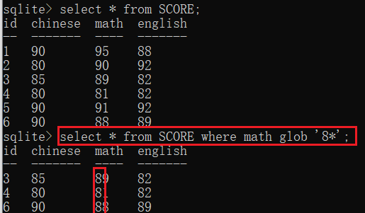

select * from SCORE where math glob '8*';

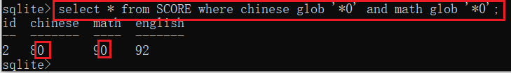

select * from SCORE where chinese glob '*0' and math glob '*0';
