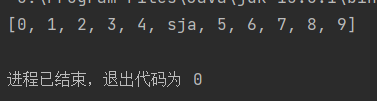

2. 增
ArraysList.add(5, "在下标为5的位置追加引号中的内容");
ArrayList<String> b = new ArrayList<>();
for (int i = 0; i<10; i++){
b.add(Integer.toString(i));
b.add(5,"sja");
System.out.println(b);

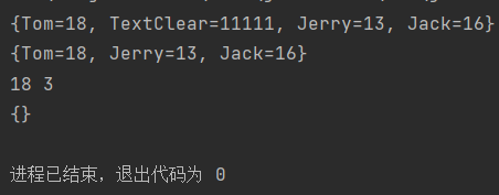

代码示例:
HashMap<String,Integer> hama = new HashMap<>();
hama.put("Jerry", 13);
hama.put("Jack", 16);
hama.put("Tom", 18);
hama.put("TextClear", 11111);
System.out.println(hama);
hama.remove("TextClear");
int age = hama.get("Tom");
int size = hama.size();
System.out.println(age+" "+size);
hama.clear();
结果展示:
