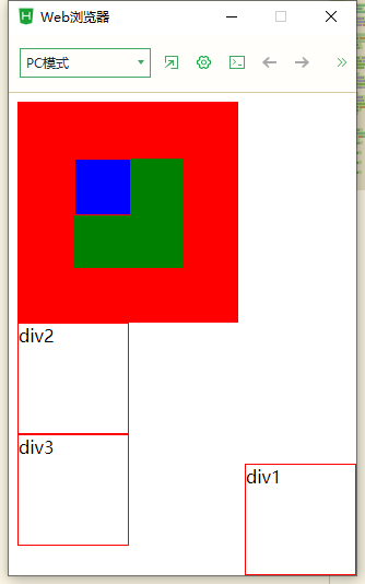

2.绝对路径
<!DOCTYPE html>
<html>
	<head>
		<meta charset="utf-8">
		<title></title>
		<style type="text/css">
			div{
			width: 100px;
			height: 100px;
			border: 1px solid red;
			#d1{
			/*设置绝对定位脱离文档流让出所占位置*/
			position: absolute;
			/* 坐标相对于窗口而非自身位置 */
			right: 0;
			bottom: 0;
			#big{
				width: 200px;
				height: 200px;
				background-color: red;
				position: relative;/* 做位置参考 */
			#middle{
			width: 100px;
			height: 100px;
			background-color: green;
			margin: 50px 0 0 50px;
			#small{
			width: 50px;
			height: 50px;
			background-color: blue;|
			position: absolute;
			right: 0;
			top: 0;
		</style>
	</head>
	<body>
		<div id="big">
			<div id="middle">
				<div id="small">
				</div>
			</div>
		</div>
		<div id="d1">
		div1
		</div>
		<div id="d2">
		div2
		</div>
		<div id="d3">
		div3
		</div>
	</body>
</html>
显示效果:

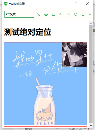

3.绝对定位练习
<!DOCTYPE html>
<html>
	<head>
		<title></title>
			#i1{
				width: 100%;
			#i2{
				width: 100px;
				/* 绝对定位,相对于上级div */
				position: absolute;
				right: 0;
				top: 0;
			#d1{
				position: relative;/* 参照物 */
		</style>
	</head>
	<body>
		<h1>测试绝对定位</h1>
		<div id="d1">
			<img id="i1" src="../晚课/web01/images/back.jpg" >
			<img id="i2" src="../day01/abc/3.png" >
		</div>
	</body>
</html>
测试结果:

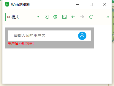

4.定位练习
<!DOCTYPE html>
<html>
	<head>
		<title></title>
			div{
				background-color: rgba(0,0,0,0.3);
				width: 280px;
				padding: 10px;
				position: relative;
			input{
				/* 因为添加了内边距
				 宽度280-20*2*/
				width: 240px;
				/* 去掉自带边框 */
				border: 0;
				padding: 10px 20px;
			img{
				position: absolute;
				top: 14px;
				right: 25px;
			p{
				font-size:12px ;
				color: red;
				margin: 0;
		</style>
	</head>
	<body>
		<div>
			<input type="text" placeholder="请输入您的用户名" />
			<img src="http://doc.canglaoshi.org/tstore_v1/images/login/yhm.png" >
			<p>用户名不能为空!</p>
		</div>
	</body>
</html>
测试效果:

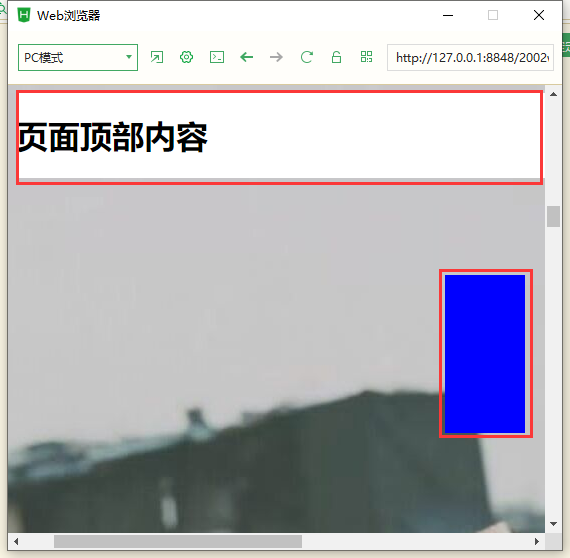

5.固定定位
<!DOCTYPE html>
<html>
	<head>
		<title></title>
			#d1{
				position: fixed;
				background-color: white;
				width: 100%;
			#i1{
				margin-top:100px ;
			#d2{
				width: 80px;
				height: 158px ;
				position: fixed;
				right: 20px;
				bottom: 100px;
		</style>
	</head>
	<body>
		<div id="d1">
			<h1>页面顶部内容</h1>
		</div>
		<div id="d2">
		</div>
		<img src="../2.jpg" >
	</body>
</html>
显示效果:
滚动页面时红色框中内容不动

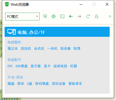

7.学子商城练习
<!DOCTYPE html>
<html>
	<head>
		<title></title>
			body{
				font: 12px "simhei", Arial, Helvetica, sans-serif;
				color: #666;
			body>div{
				width: 366px;
				height: 233px;
				background-color: #e8e8e8;
			#top_div{
				height: 35px;
				background-color: #0AA1ED;
				border-radius: 2px;
			#top_div>img{
				margin: 8px 0 0 10px;
			#top_div>span{
				color: white;
				font-size: 16px;
				/* 位置微调使用相对定位 */
				position: relative;
				bottom: 3px;
			.c1{
				/* 让div里面的内容缩进10个像素 */
				padding-left: 10px;
			ul{
				list-style-type: none;
				/* 去掉无序列表自带缩进 */
				padding: 0;
				/* 因为ul里面的所有li全部浮动了,此时因为高度识别为0 会出现显示异常
				添加以下代码解决*/
				overflow: hidden;
				margin-top: 8px;
				margin-bottom: 25px;
			li{
				float: left;
				margin-right: 10px;
			.c1>p{
				color: #62B5EC;
				margin-bottom: 8px;
			li>a{
				color: #0AA1ED;
				text-decoration: none;
			a:hover{
				color: #0a7eb8;
		</style>
	</head>
	<body>
		<div>
			<div id="top_div">
				<img src="http://doc.canglaoshi.org/tstore_v1/images/itemCat/computer_icon1.png"/>
				<span>电脑,办公/1F</span>
			</div>
			<div class="c1">
				<p>电脑整机</p>
				<ul>
					<li><a href="#">笔记本</a></li>
					<li><a href="#">游戏机</a></li>
					<li><a href="#">台式机</a></li>
					<li><a href="#">一体机</a></li>
					<li><a href="#">服务器</a></li>
					<li><a href="#">联想</a></li>
				</ul>
			</div>
			<div class="c1">
				<p>电脑配件</p>
				<ul>
					<li><a href="#">CPU</a></li>
					<li><a href="#">SSD硬盘</a></li>
					<li><a href="#">显示器</a></li>
					<li><a href="#">显卡</a></li>
					<li><a href="#">组装电脑</a></li>
					<li><a href="#">机箱</a></li>
				</ul>
			</div>
			<div class="c1">
				<p>外设/游戏</p>
				<ul>
					<li><a href="#">键盘</a></li>
					<li><a href="#">鼠标</a></li>
					<li><a href="#">U盘</a></li>
					<li><a href="#">移动硬盘</a></li>
					<li><a href="#">游戏设备</a></li>
					<li><a href="#">智能单车</a></li>
				</ul>
			</div>
		</div>
	</body>
</html>
显示效果:

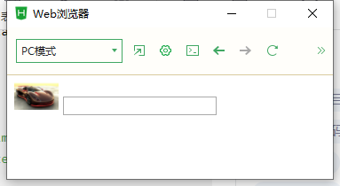

8.行内对齐方式
<!DOCTYPE html>
<html>
	<head>
		<title></title>
			img{
				width: 50px;
				/* 行内元素的水平对齐方式:top/bottom/middle/baseline(默认) */
				vertical-align: baseline;
		</style>
	</head>
	<body>
		<img src="../imgs/2.jpg" />
		<input type="text" />
	</body>
</html>
显示效果:

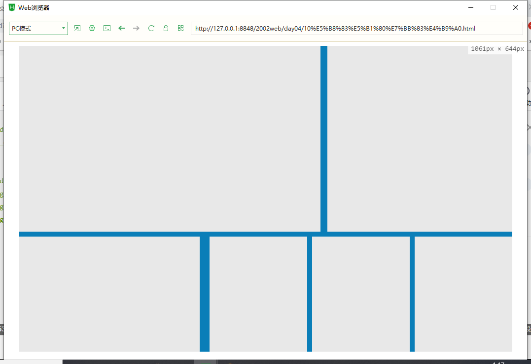

9.布局练习
<!DOCTYPE html>
<html>
	<head>
		<title></title>
			body>div{
				width: 1000px;
				margin: 0 auto;
				background-color: #0A7EB8;
			#t_left_div{
				width: 611px;
				height: 376px;
				float: left;
			#t_right_div{
				width: 375px;
				height: 376px;
				float: right;
			body>div>div{
				overflow: hidden;/* 解决高度为0的问题 */
				margin-bottom: 10px;/* 两行之间的间距 */
			body>div>div>div{/* 给所有第3层的div添加背景颜色 */
			#b_left_div{
				width: 366px;
				height: 233px;
				float: left;
			.b_right_div{
					width: 198px;
					height: 233px;
					float: right;
					margin-left: 10px;
		</style>
	</head>
	<body>
		<div>
			<div >
				<div id="t_left_div"></div>
				<div id="t_right_div"></div>
			</div>
			<div >
				<div id="b_left_div"></div>
				<div class="b_right_div"></div>
			</div>
		</div>
	</body>
</html>
显示效果:
