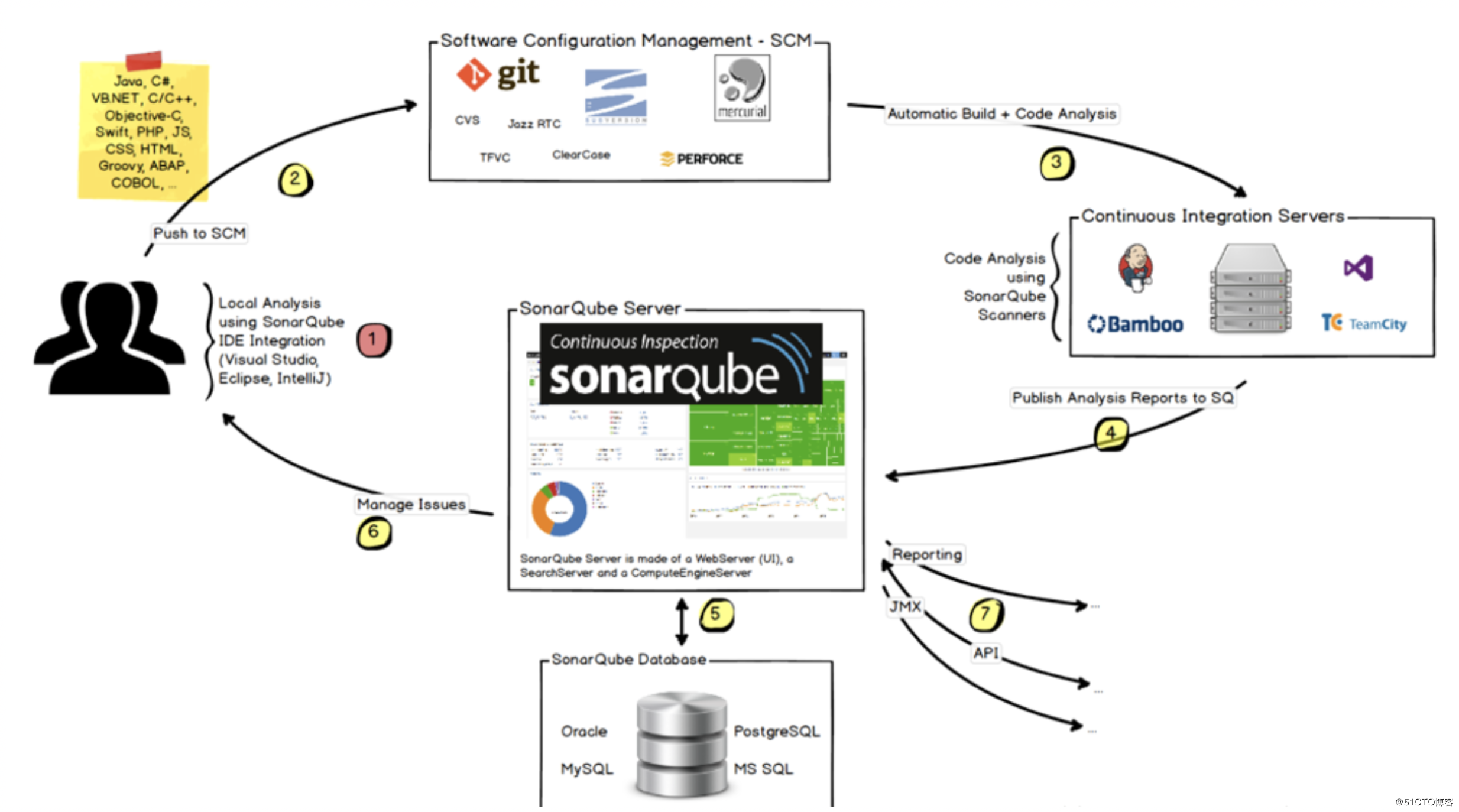

1.3 架构图
开发人员把代码push到SCM(如gitlab)->jenkins构建定义好的job,然后通过jenkins 插件(sonar scanner)分析源码->jenkins/gitlab-ci 中的scanner客户端把分析报告发到sonarqube server

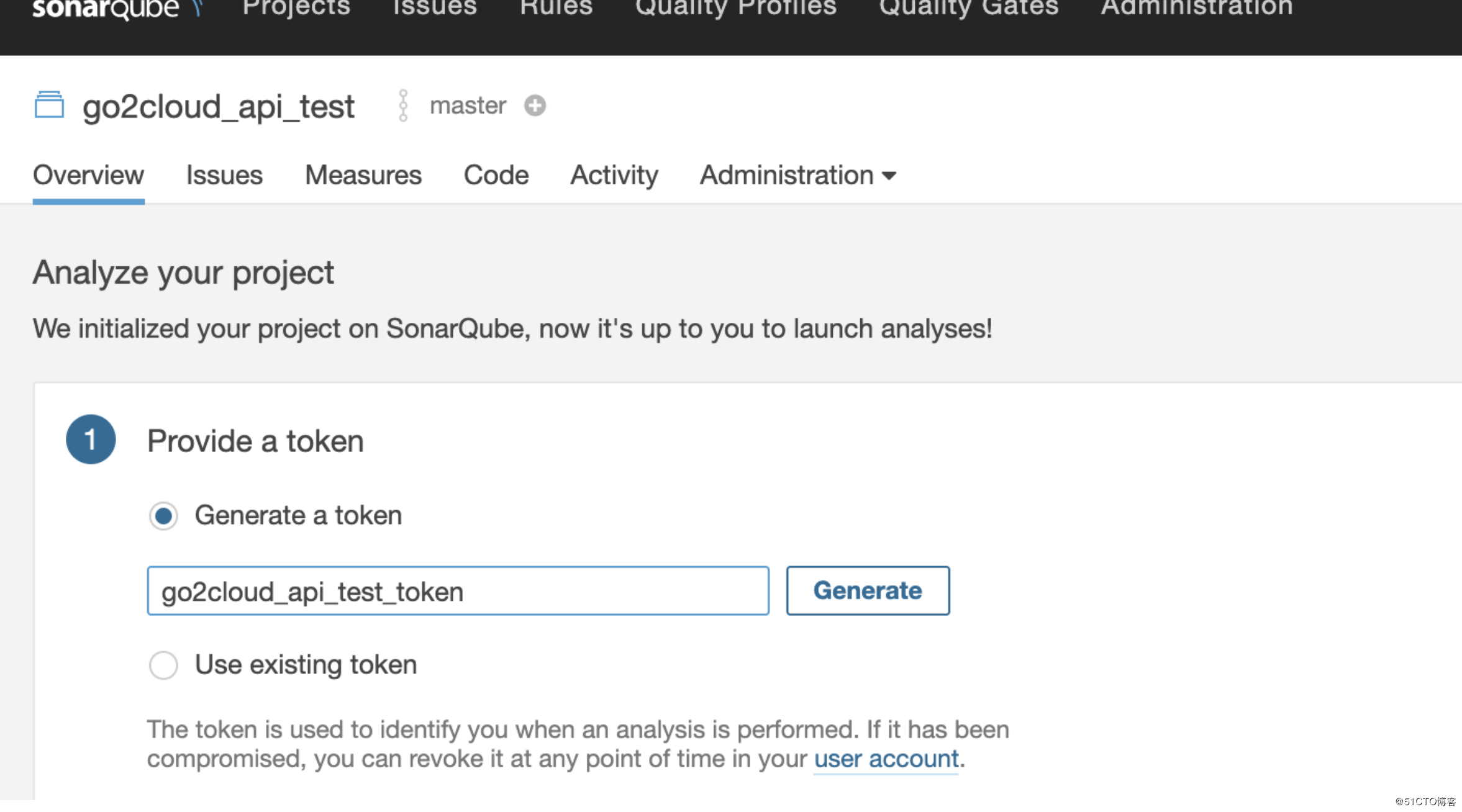

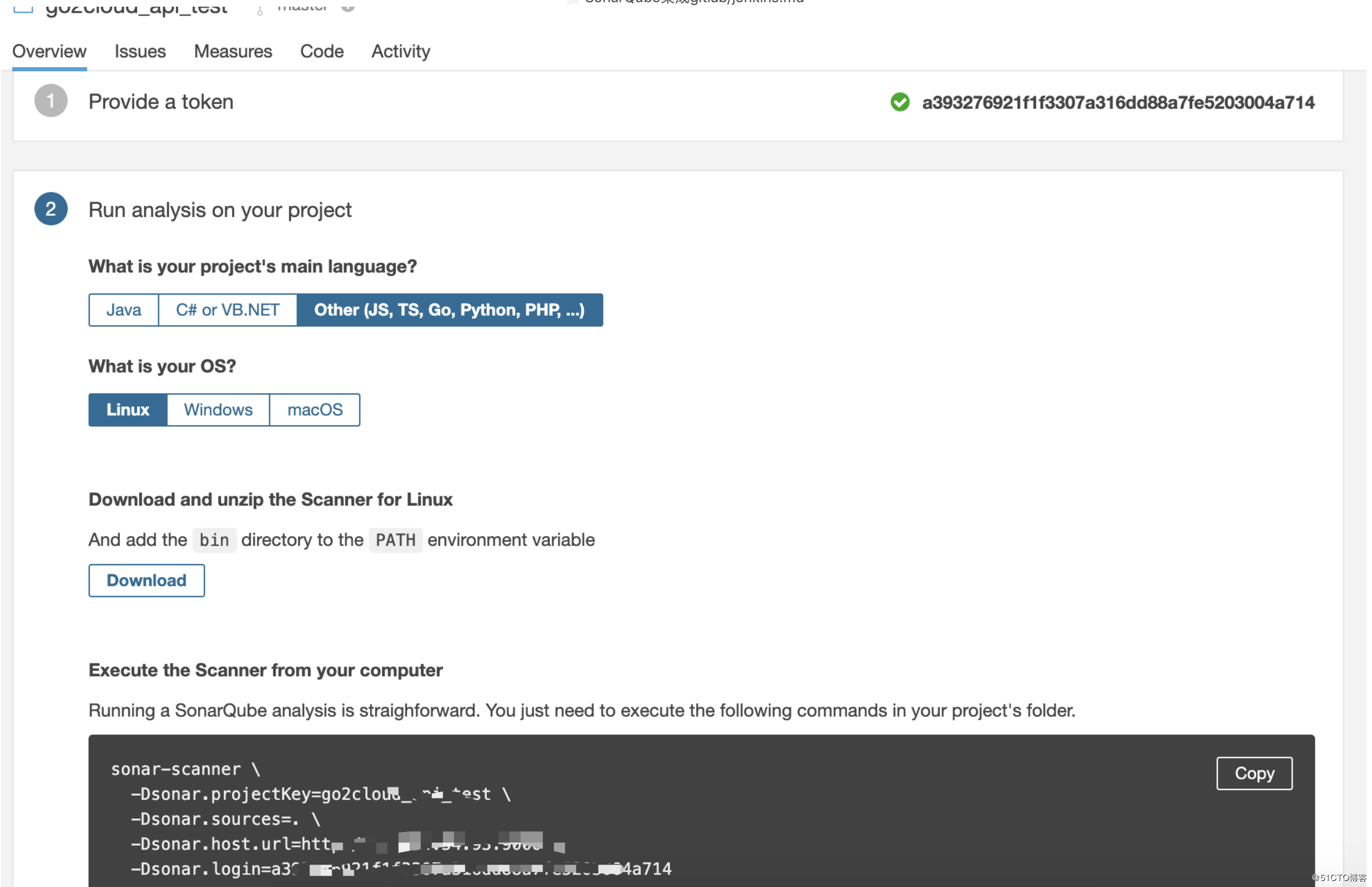

2.2.2 sonarqube web配置项目
Create new project->Provide a token->

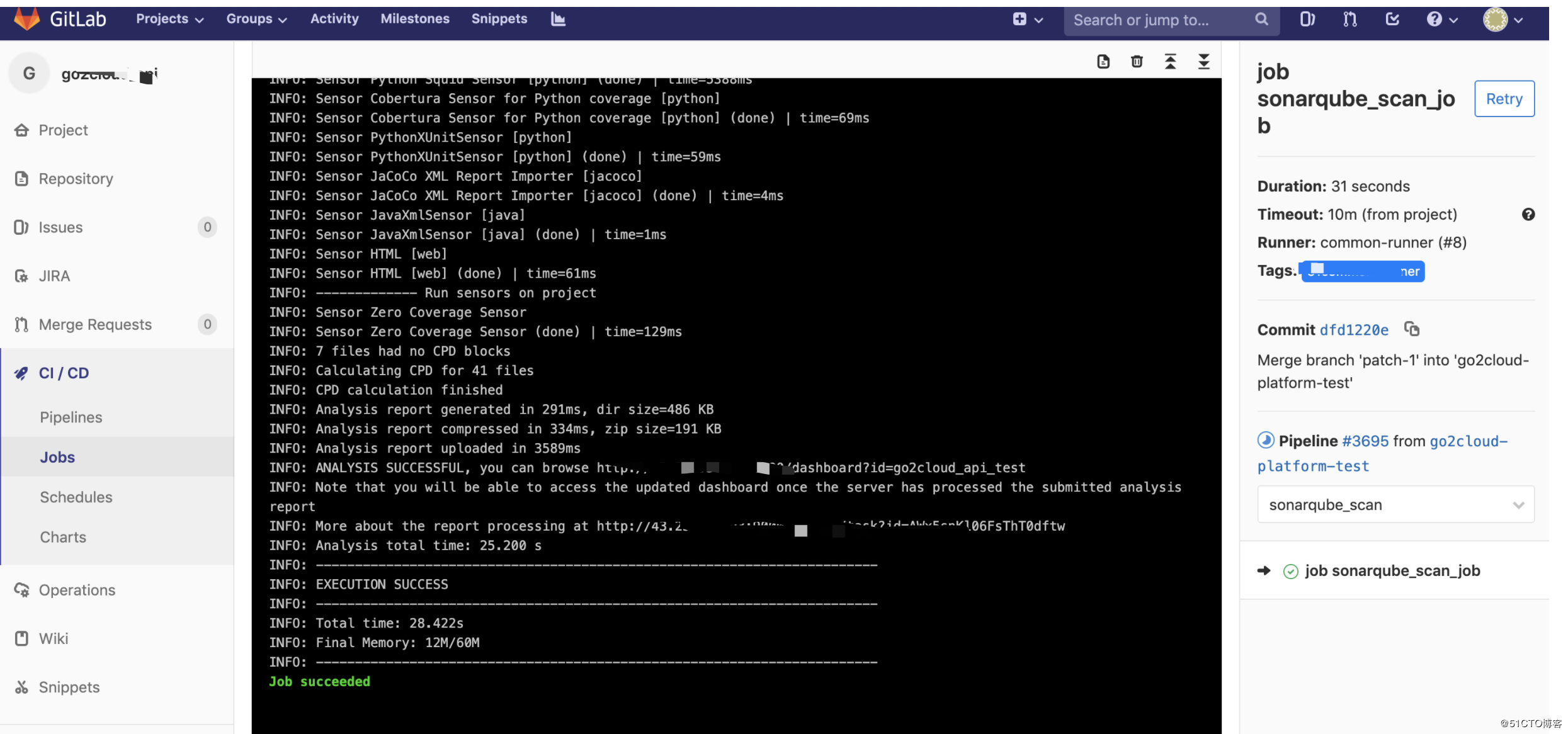

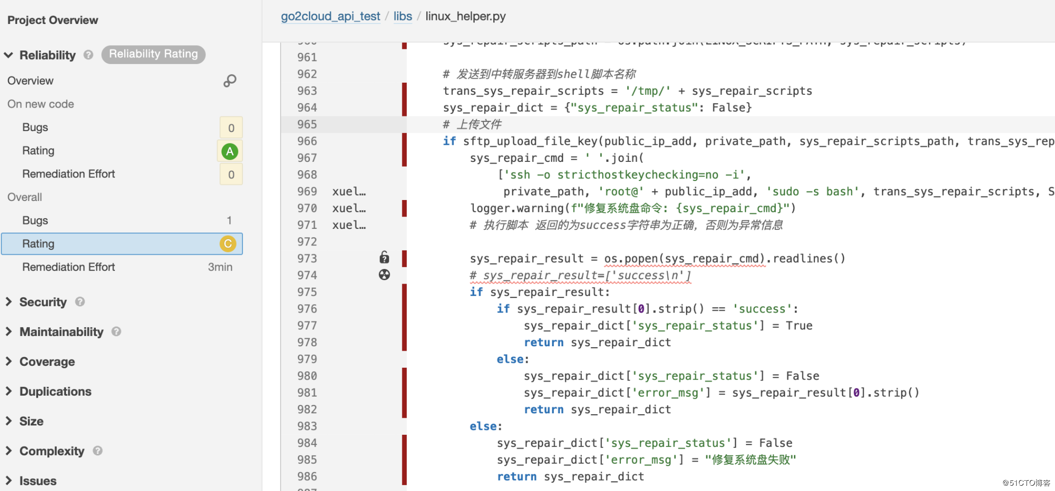

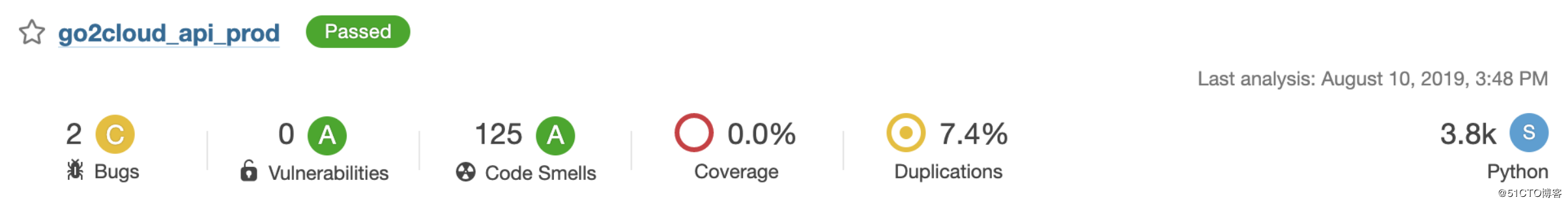

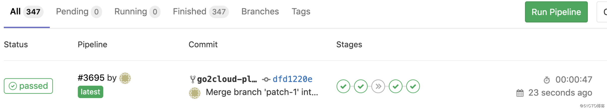

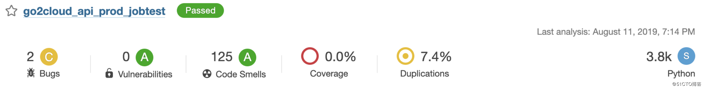

提交代码测试:
查看运行job

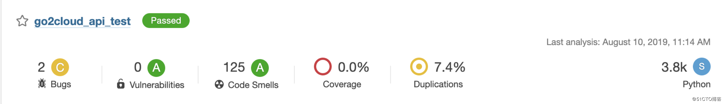

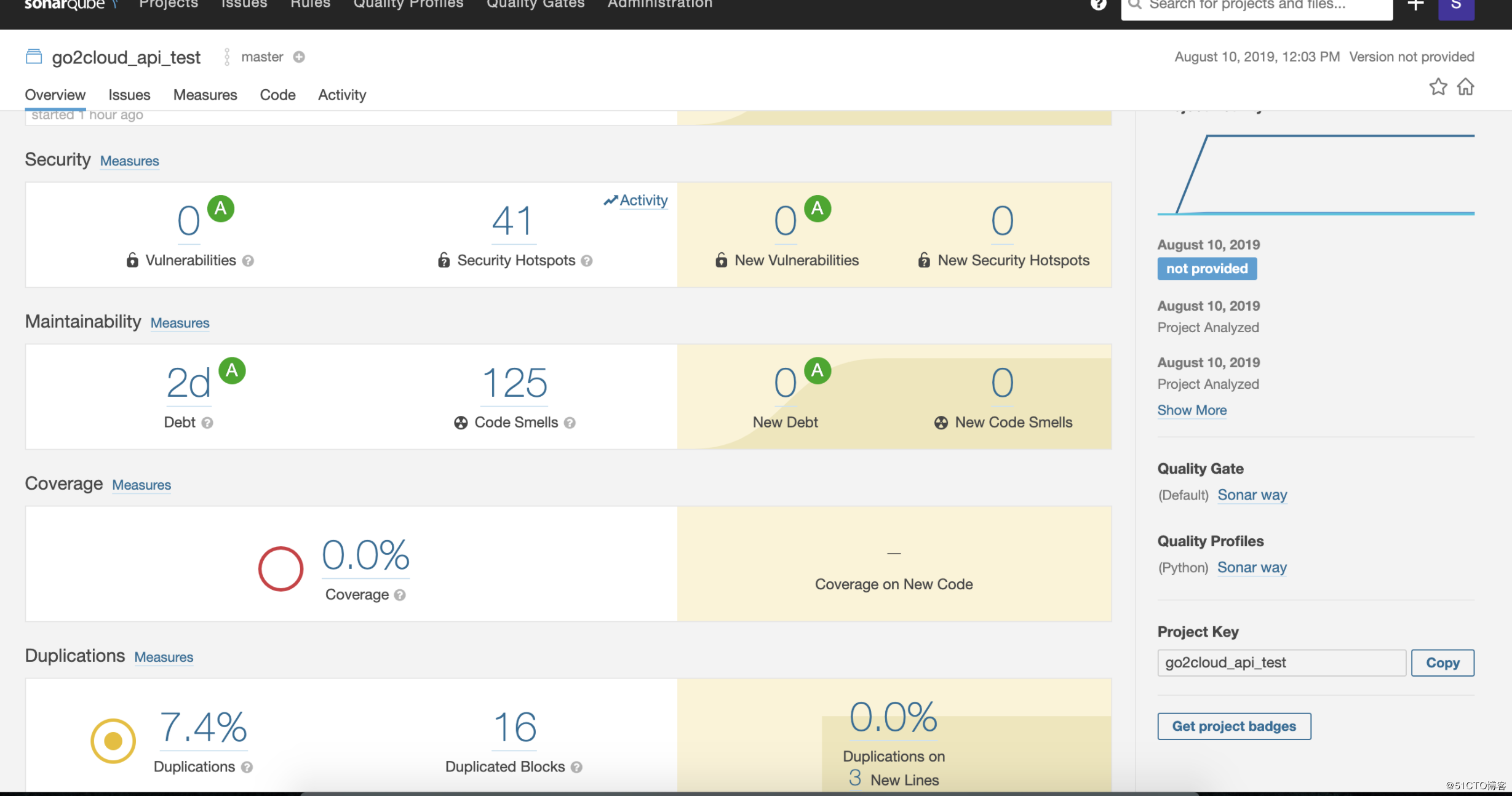

查看sonarqube项目
![image-20190810112146155](/Users/xuel/Library/Application Support/typora-user-images/image-20190810112146155.png)
查看详情

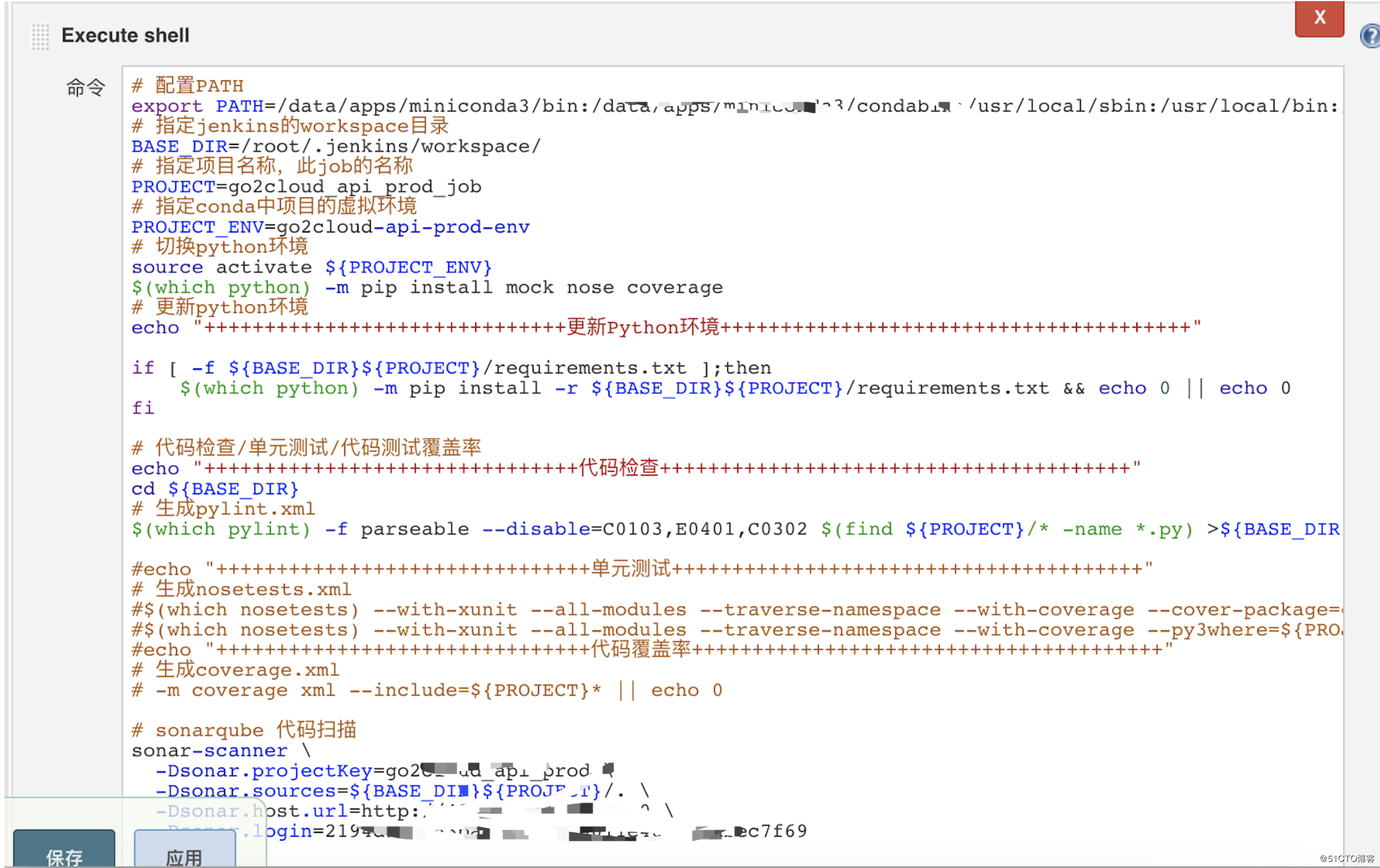

2.3.2.1 脚本构建集成
在构建的时候利用安装好的sonar-scanner命令集成
# 配置PATH
export PATH=/data/apps/miniconda3/bin:/data/apps/miniconda3/condabin:/usr/local/sbin:/usr/local/bin:/usr/sbin:/usr/bin:/data/apps/miniconda3/bin:/data/apps/software/sonar-scanner/bin:/root/bin
# 指定jenkins的workspace目录
BASE_DIR=/root/.jenkins/workspace/
# 指定项目名称,此job的名称
PROJECT=go2cloud_api_prod_job
# 指定conda中项目的虚拟环境
PROJECT_ENV=go2cloud-api-prod-env
# 切换python环境
source activate ${PROJECT_ENV}
$(which python) -m pip install mock nose coverage
# 更新python环境
echo "++++++++++++++++++++++++++++++更新Python环境+++++++++++++++++++++++++++++++++++++++"
if [ -f ${BASE_DIR}${PROJECT}/requirements.txt ];then
    $(which python) -m pip install -r ${BASE_DIR}${PROJECT}/requirements.txt && echo 0 || echo 0
fi
# 代码检查/单元测试/代码测试覆盖率
echo "+++++++++++++++++++++++++++++++代码检查+++++++++++++++++++++++++++++++++++++++"
cd ${BASE_DIR}
# 生成pylint.xml
$(which pylint) -f parseable --disable=C0103,E0401,C0302 $(find ${PROJECT}/* -name *.py) >${BASE_DIR}${PROJECT}-pylint.xml || echo 0
#echo "+++++++++++++++++++++++++++++++单元测试+++++++++++++++++++++++++++++++++++++++"
# 生成nosetests.xml
#$(which nosetests) --with-xunit --all-modules --traverse-namespace --with-coverage --cover-package=go2cloud-api-deploy-prod --cover-inclusive || echo 0
#$(which nosetests) --with-xunit --all-modules --traverse-namespace --with-coverage --py3where=${PROJECT} --cover-package=${PROJECT} --cover-inclusive || echo 0
#echo "+++++++++++++++++++++++++++++++代码覆盖率+++++++++++++++++++++++++++++++++++++++"
# 生成coverage.xml
# -m coverage xml --include=${PROJECT}* || echo 0

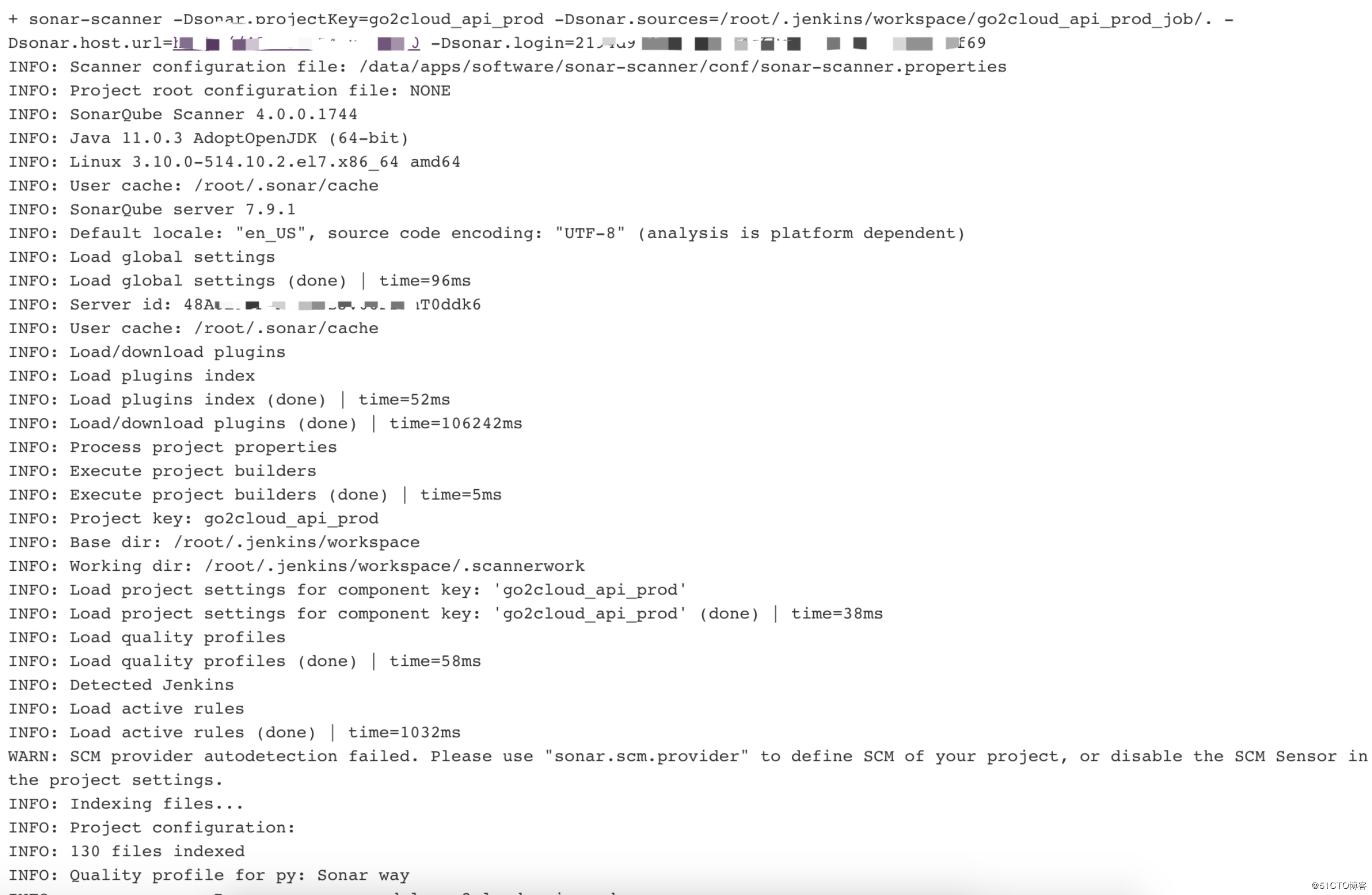

# sonarqube 代码扫描
sonar-scanner \
  -Dsonar.projectKey=go2cloud_api_prod \
  -Dsonar.sources=${BASE_DIR}${PROJECT}/. \
  -Dsonar.host.url=http://xxx.xxx.xxx.xxx:9100 \
  -Dsonar.login=2194d90xxxxxxxxxxxxxxxxxxxxxxxxbec7f69

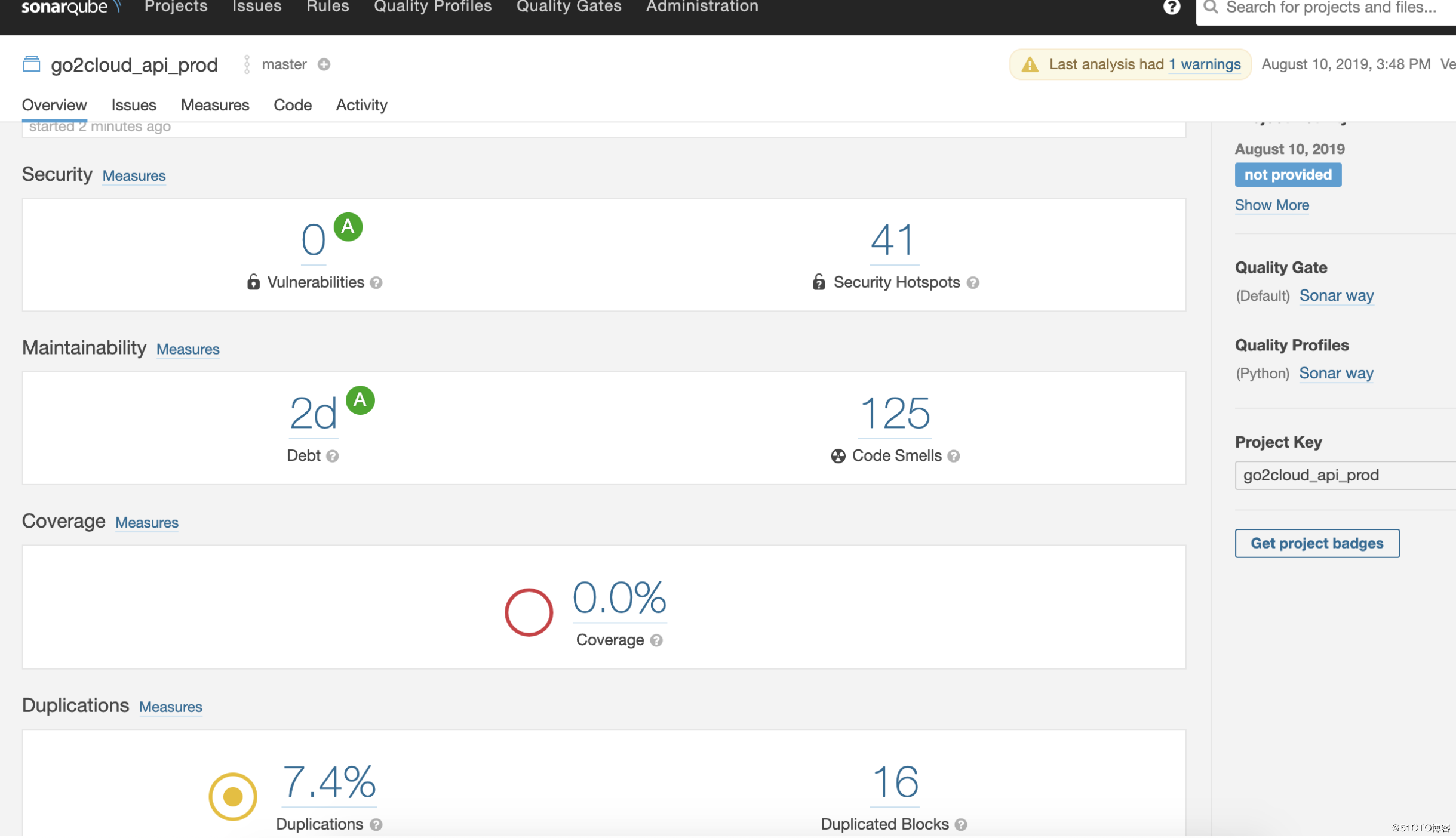

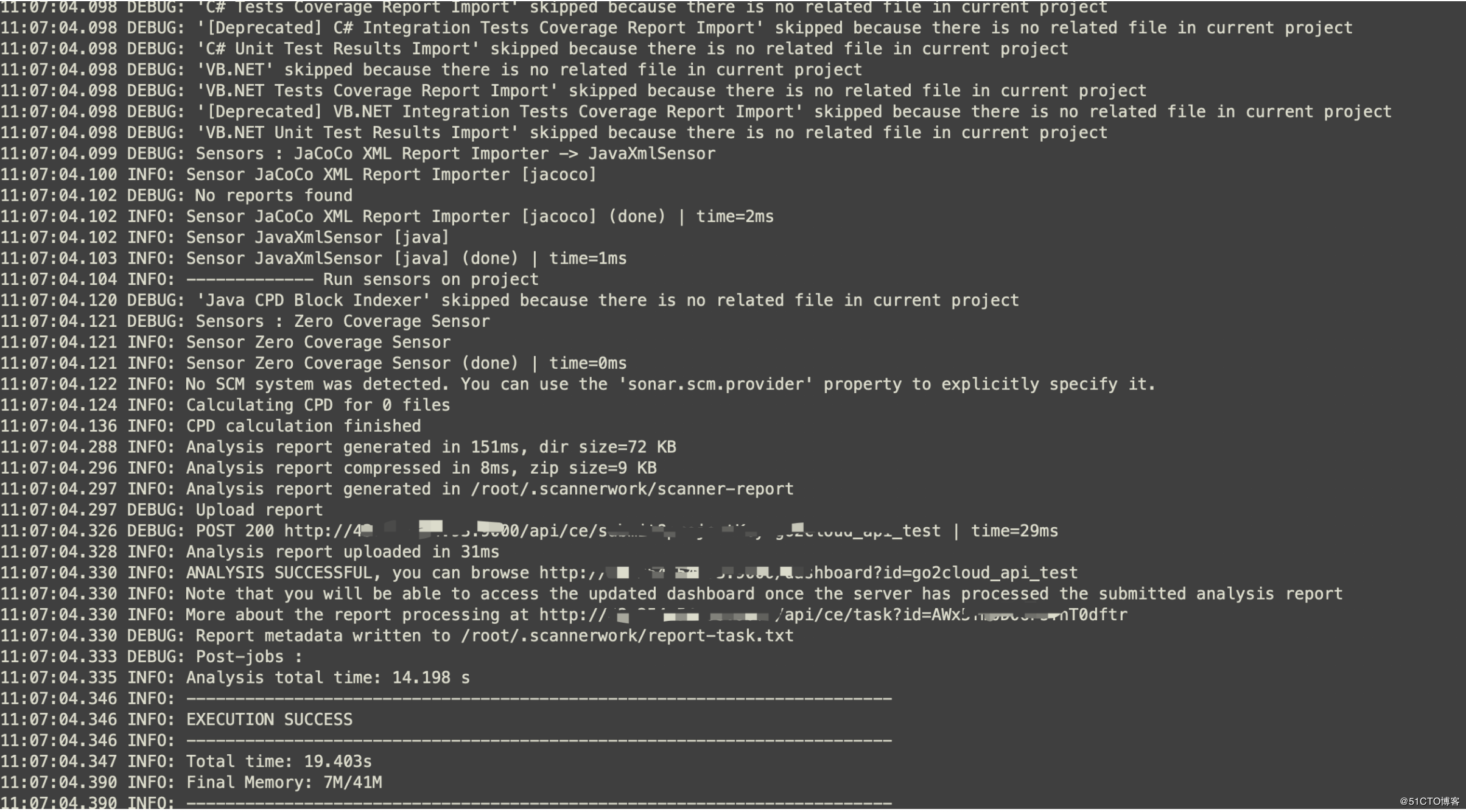

运行项目查看
查看sonarqube项目

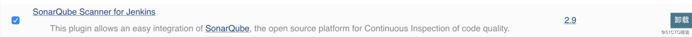

2.3.2.2 插件形式集成

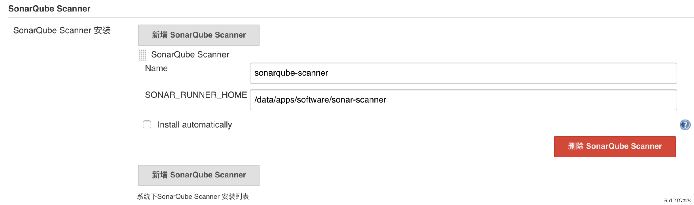

  • jenkins服务器scanner配置
# 如果在构建中未指定将扫描报告发送给server端地址,需要在客户端中配置,在安装好scanner的conf目录下修改:sonar-scanner.properties 服务端的地址

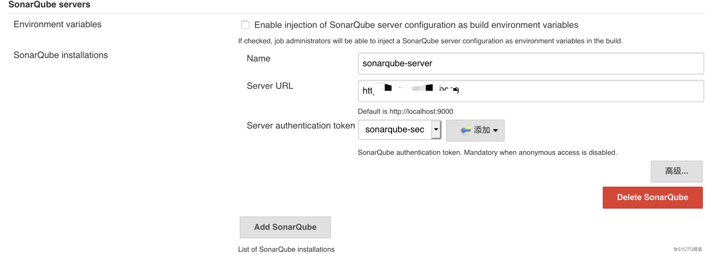

  • jenkins服务器安装scanner
  • 工具中配置scanner

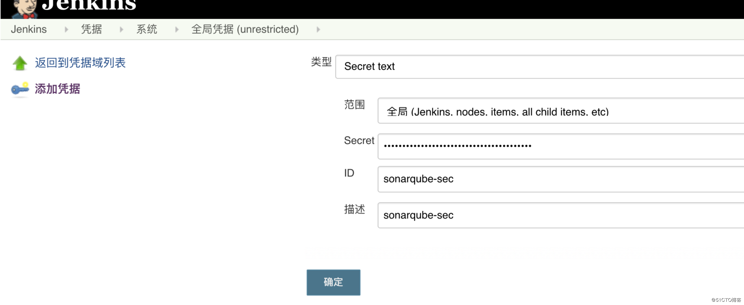

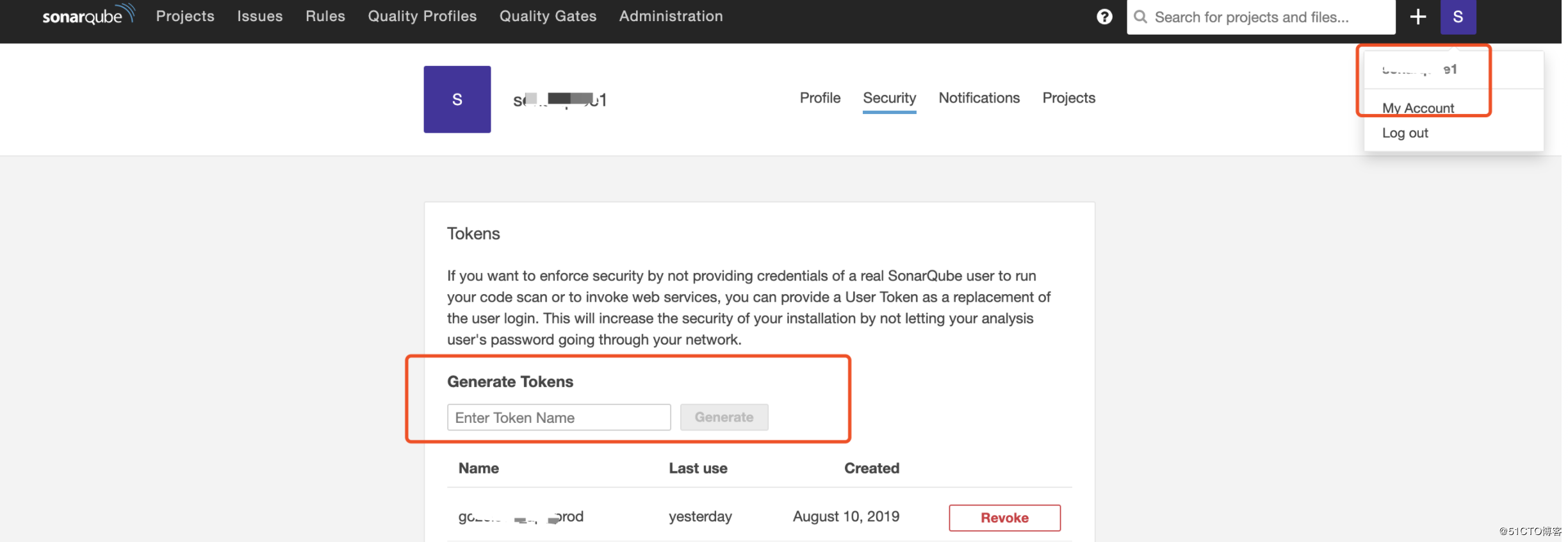

  • sonarqube server生产token
需要在sonarqube server配置jenkins的api token,用来jenkins将报告发送给sonarqube server
  • 全局工具配置中添加SonarQube servers
jenkins利用sonarqube的token创建凭据

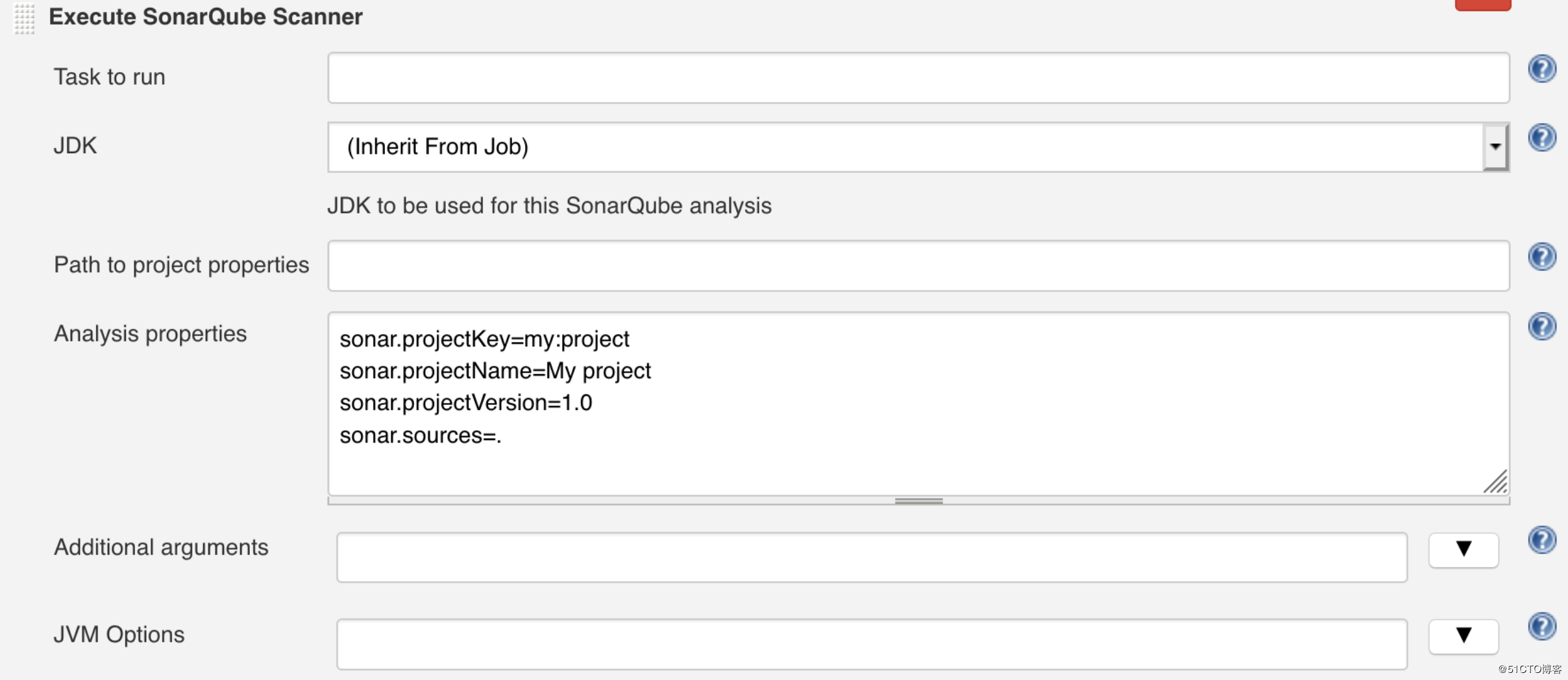

  • 构建项目配置
根据扫描的程序语言填写对应的analysis properties,在此填写项目相关信息。
如果使用pipeline,可以参考声明式示例
