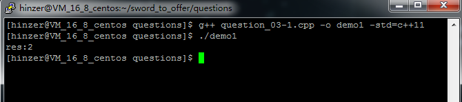

void test01()
int numbers[] = {2, 3, 1, 0, 2, 5, 3};
int duplication = 0;
if ( duplicate(numbers, sizeof(numbers)/sizeof(int), &duplication) == true )
cout << "res:" << duplication << endl;
int main(int argc, char const *argv[])
test01();
return 0;
运行

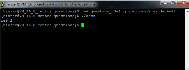

void test01()
int arr[] = {2, 3, 5, 4, 3, 2, 6, 7};
int res = getDuplication(arr, sizeof(arr)/sizeof(int));
cout << "res:" << res << endl;
test01();
return 0;
运行
