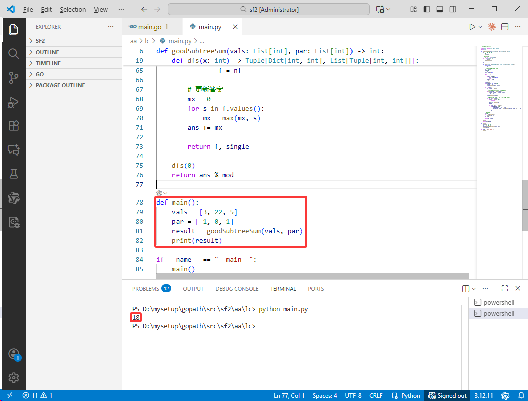

Python完整代码如下:
# -*-coding:utf-8-*-
from typing import List, Dict, Tuple
import copy
def goodSubtreeSum(vals: List[int], par: List[int]) -> int:
    mod = 1_000_000_007
    D = 10
    n = len(par)
    # 构建树结构
    g = [[] for _ in range(n)]
    for i in range(1, n):
        p = par[i]
        g[p].append(i)
    ans = 0
    def dfs(x: int) -> Tuple[Dict[int, int], List[Tuple[int, int]]]:
        nonlocal ans
        f = {}
        # 计算 val 的数位集合 mask
        val = vals[x]
        mask = 0
        v = val
        valid_mask = True
        while v > 0:
            d = v % D
            if mask >> d & 1:
                valid_mask = False
                break
            mask |= 1 << d
            v //= D
        single = []
        if valid_mask and mask > 0:
            f[mask] = val
            single.append((mask, val))
        for y in g[x]:
            fy, singleY = dfs(y)
            # 启发式合并:确保 single 是较大的那个
            if len(singleY) > len(single):
                single, singleY = singleY, single
                f, fy = fy, f
            single.extend(singleY)
            # 把子树 y 中的 mask 和 val 一个一个地加到 f 中
            for msk, v in singleY:
                if v <= f.get(msk, 0):
                    continue
                nf = copy.deepcopy(f)
                nf[msk] = v
                for msk2, s2 in f.items():
                    if msk & msk2 == 0:
                        combined_mask = msk | msk2
                        nf[combined_mask] = max(nf.get(combined_mask, 0), v + s2)
                f = nf
        # 更新答案
        mx = 0
        for s in f.values():
            mx = max(mx, s)
        ans += mx
        return f, single
    dfs(0)
    return ans % mod
def main():
    vals = [3, 22, 5]
    par = [-1, 0, 1]
    result = goodSubtreeSum(vals, par)
    print(result)
if __name__ == "__main__":
    main()

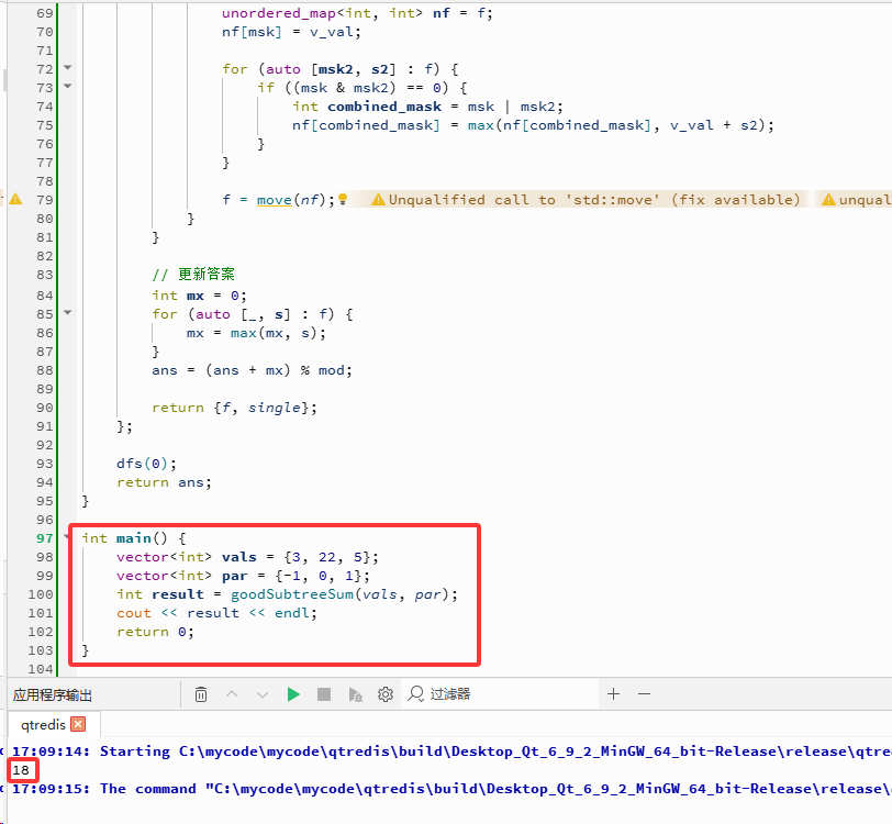

C++完整代码如下:
#include <iostream>
#include <vector>
#include <unordered_map>
#include <algorithm>
#include <functional>
using namespace std;
int goodSubtreeSum(vector<int>& vals, vector<int>& par) {
    const int mod = 1000000007;
    const int D = 10;
    int n = par.size();
    // 构建树结构
    vector<vector<int>> g(n);
    for (int i = 1; i < n; i++) {
        int p = par[i];
        g[p].push_back(i);
    int ans = 0;
    // 使用pair表示mask和val
    using Pair = pair<int, int>;
    function<tuple<unordered_map<int, int>, vector<Pair>>(int)> dfs;
    dfs = [&](int x) -> tuple<unordered_map<int, int>, vector<Pair>> {
        unordered_map<int, int> f;
        vector<Pair> single;
        // 计算val的数位集合mask
        int val = vals[x];
        int mask = 0;
        int v = val;
        bool valid_mask = true;
        while (v > 0) {
            int d = v % D;
            if (mask >> d & 1) {
                valid_mask = false;
                break;
            mask |= 1 << d;
            v /= D;
        if (valid_mask && mask > 0) {
            f[mask] = val;
            single.emplace_back(mask, val);
        for (int y : g[x]) {
            auto [fy, singleY] = dfs(y);
            // 启发式合并:确保single是较大的那个
            if (singleY.size() > single.size()) {
                swap(single, singleY);
                swap(f, fy);
            single.insert(single.end(), singleY.begin(), singleY.end());
            // 把子树y中的mask和val一个一个地加到f中
            for (auto [msk, v_val] : singleY) {
                if (v_val <= f[msk]) {
                    continue;
                unordered_map<int, int> nf = f;
                nf[msk] = v_val;
                for (auto [msk2, s2] : f) {
                    if ((msk & msk2) == 0) {
                        int combined_mask = msk | msk2;
                        nf[combined_mask] = max(nf[combined_mask], v_val + s2);
                f = move(nf);
        // 更新答案
        int mx = 0;
        for (auto [_, s] : f) {
            mx = max(mx, s);
        ans = (ans + mx) % mod;
        return {f, single};
    dfs(0);
    return ans;
int main() {
    vector<int> vals = {3, 22, 5};
    vector<int> par = {-1, 0, 1};
    int result = goodSubtreeSum(vals, par);
    cout << result << endl;
    return 0;
