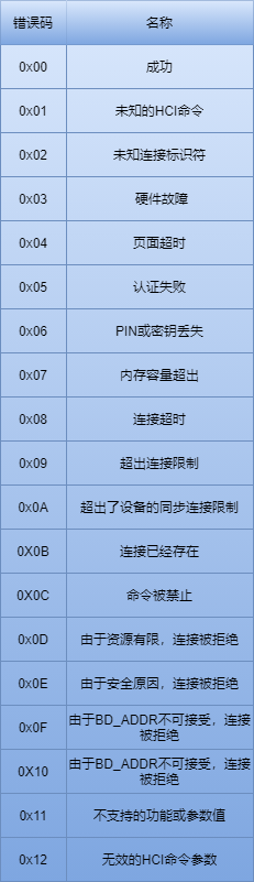

2.错误代码列表
(未完待补充)
对应代码宏定义:
/* Success code */
#define HCI_SUCCESS 0x00
/* Possible error codes */
#define HCI_UNKNOWN_HCI_COMMAND 0x01
#define HCI_NO_CONNECTION 0x02
#define HCI_HW_FAILURE 0x03
#define HCI_PAGE_TIMEOUT 0x04
#define HCI_AUTHENTICATION_FAILURE 0x05
#define HCI_KEY_MISSING 0x06
#define HCI_MEMORY_FULL 0x07
#define HCI_CONN_TIMEOUT 0x08
#define HCI_MAX_NUMBER_OF_CONNECTIONS 0x09
#define HCI_MAX_NUMBER_OF_SCO_CONNECTIONS_TO_DEVICE 0x0A
#define HCI_ACL_CONNECTION_EXISTS 0x0B
#define HCI_COMMAND_DISSALLOWED 0x0C
#define HCI_HOST_REJECTED_DUE_TO_LIMITED_RESOURCES 0x0D
#define HCI_HOST_REJECTED_DUE_TO_SECURITY_REASONS 0x0E
#define HCI_HOST_REJECTED_DUE_TO_REMOTE_DEVICE_ONLY_PERSONAL_SERVICE 0x0F
#define HCI_HOST_TIMEOUT 0x10
#define HCI_UNSUPPORTED_FEATURE_OR_PARAMETER_VALUE 0x11
#define HCI_INVALID_HCI_COMMAND_PARAMETERS 0x12
#define HCI_OTHER_END_TERMINATED_CONN_USER_ENDED 0x13
#define HCI_OTHER_END_TERMINATED_CONN_LOW_RESOURCES 0x14
#define HCI_OTHER_END_TERMINATED_CONN_ABOUT_TO_POWER_OFF 0x15
#define HCI_CONN_TERMINATED_BY_LOCAL_HOST 0x16
#define HCI_REPETED_ATTEMPTS 0x17
#define HCI_PAIRING_NOT_ALLOWED 0x18
#define HCI_UNKNOWN_LMP_PDU 0x19
#define HCI_UNSUPPORTED_REMOTE_FEATURE 0x1A
#define HCI_SCO_OFFSET_REJECTED 0x1B
#define HCI_SCO_INTERVAL_REJECTED 0x1C
#define HCI_SCO_AIR_MODE_REJECTED 0x1D
#define HCI_INVALID_LMP_PARAMETERS 0x1E
#define HCI_UNSPECIFIED_ERROR 0x1F
#define HCI_UNSUPPORTED_LMP_PARAMETER_VALUE 0x20
#define HCI_ROLE_CHANGE_NOT_ALLOWED 0x21
#define HCI_LMP_RESPONSE_TIMEOUT 0x22
#define HCI_LMP_ERROR_TRANSACTION_COLLISION 0x23
#define HCI_LMP_PDU_NOT_ALLOWED 0x24
#define HCI_ENCRYPTION_MODE_NOT_ACCEPTABLE 0x25
#define HCI_UNIT_KEY_USED 0x26
#define HCI_QOS_NOT_SUPPORTED 0x27
#define HCI_INSTANT_PASSED 0x28
#define HCI_PAIRING_UNIT_KEY_NOT_SUPPORTED 0x29
