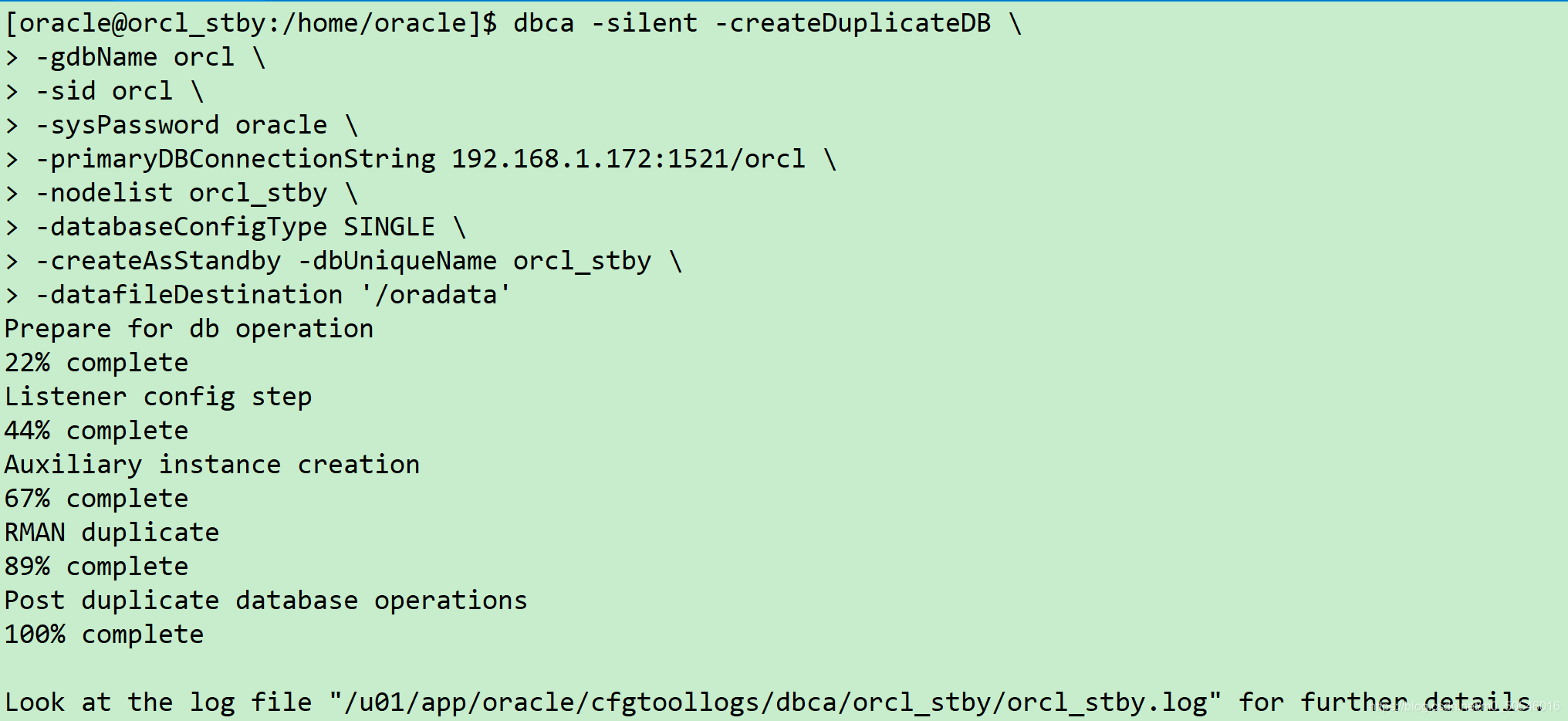

3、 DBCA  AsStandby
dbca -silent -createDuplicateDB \
-gdbName orcl \
-sid orcl \
-sysPassword oracle \
-primaryDBConnectionString 192.168.1.172:1521/orcl \
-nodelist orcl_stby \
-databaseConfigType SINGLE \
-createAsStandby -dbUniqueName orcl_stby \
-datafileDestination '/oradata'
