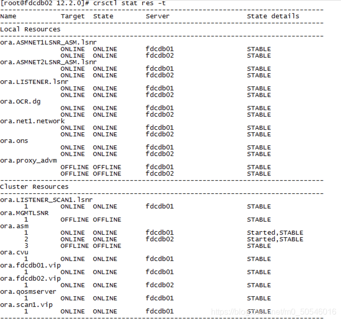

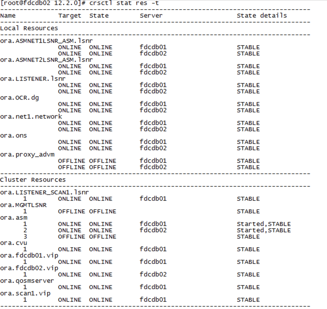

7、检查集群状态

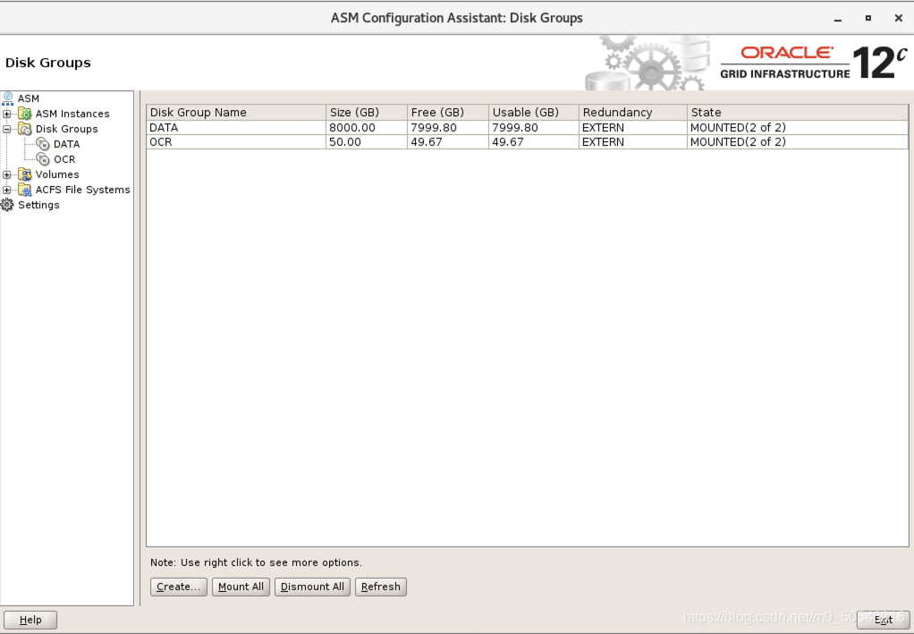

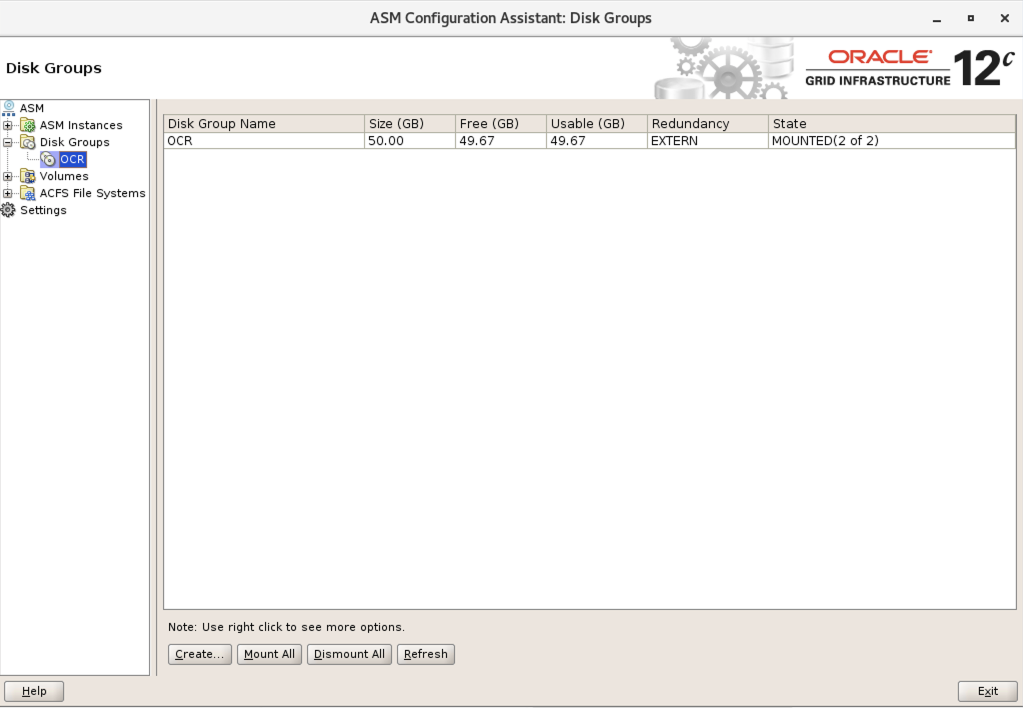

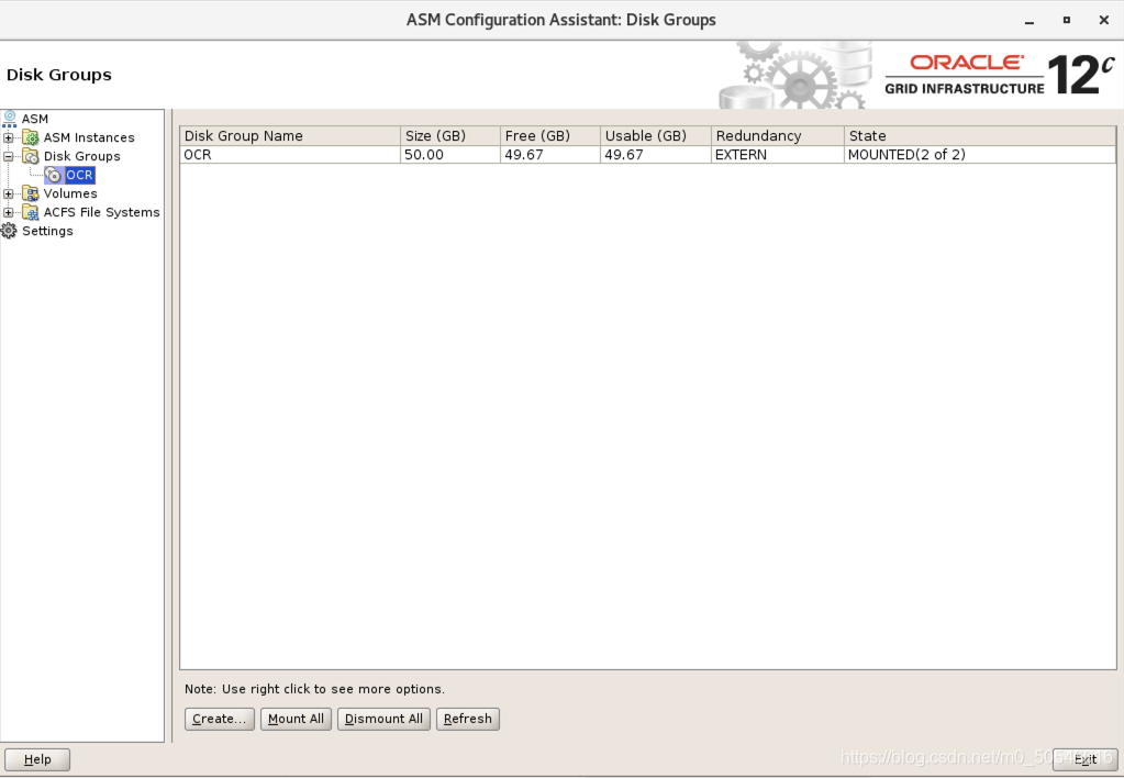

ASM磁盘OCR检查:

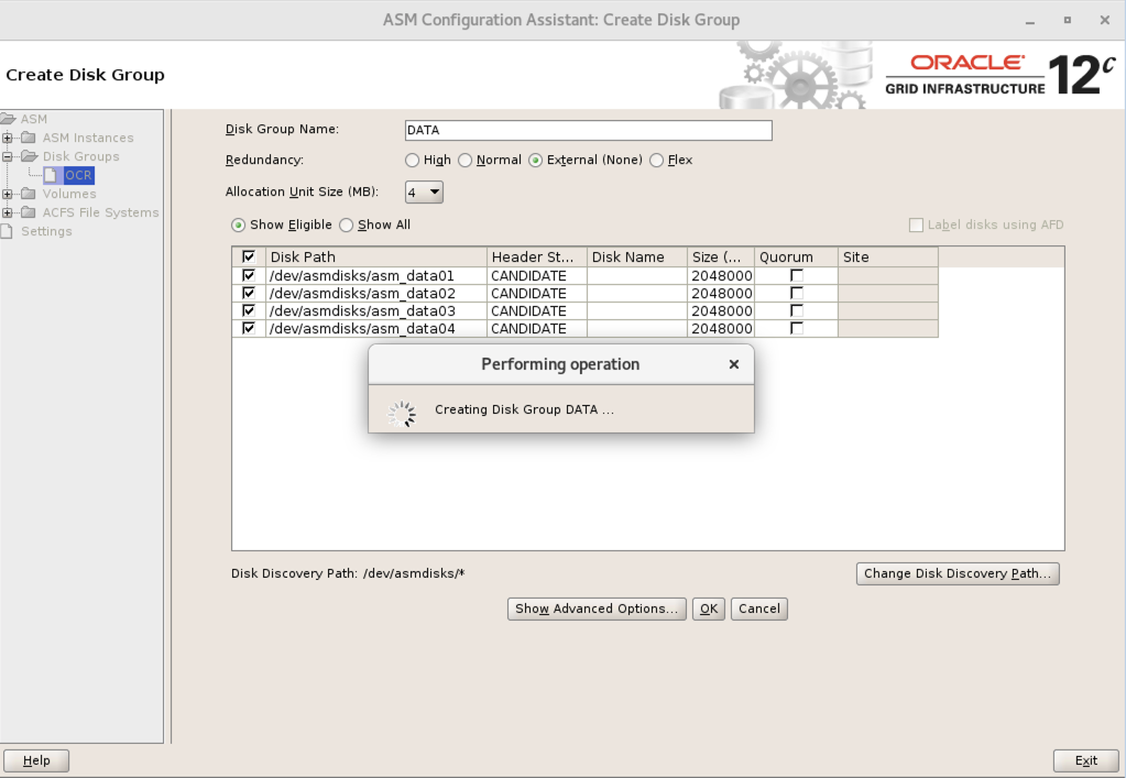

5、创建ASM DATA盘
检查ASM磁盘组情况:
所有主机reboot检查集群是否运行正常。

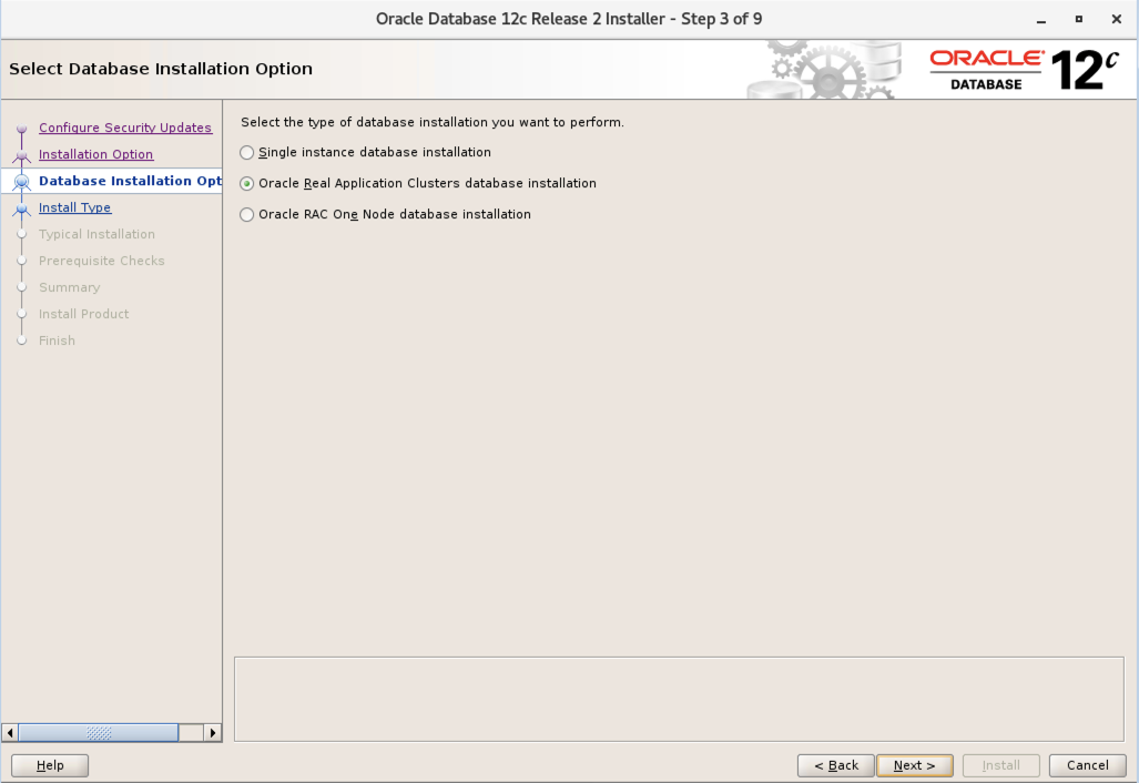

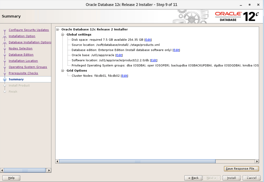

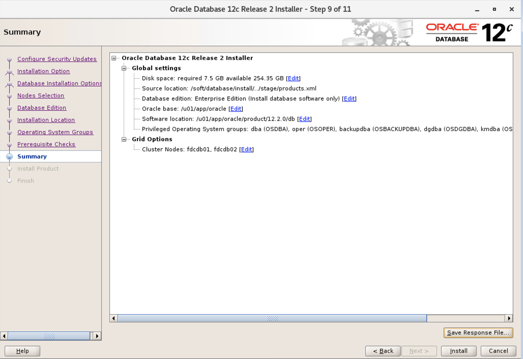

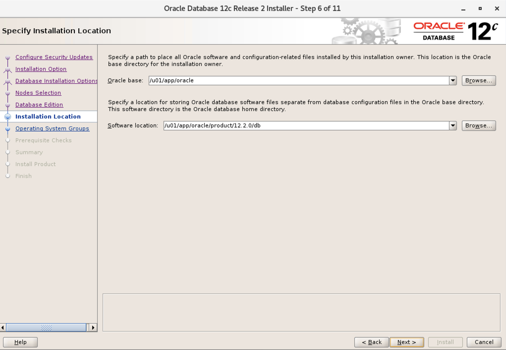

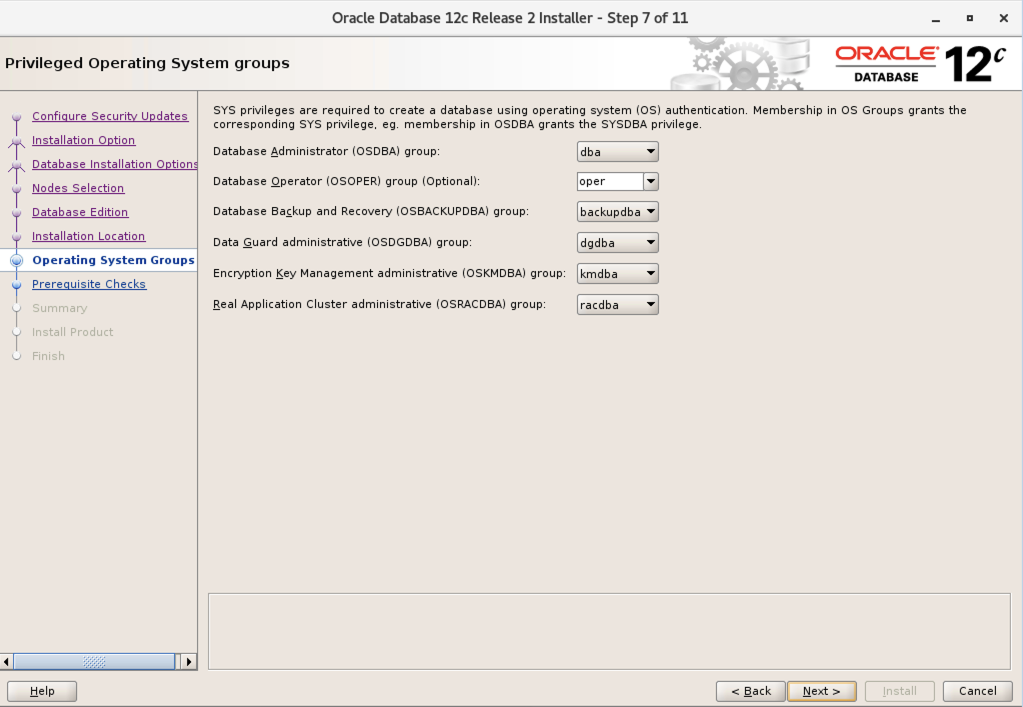

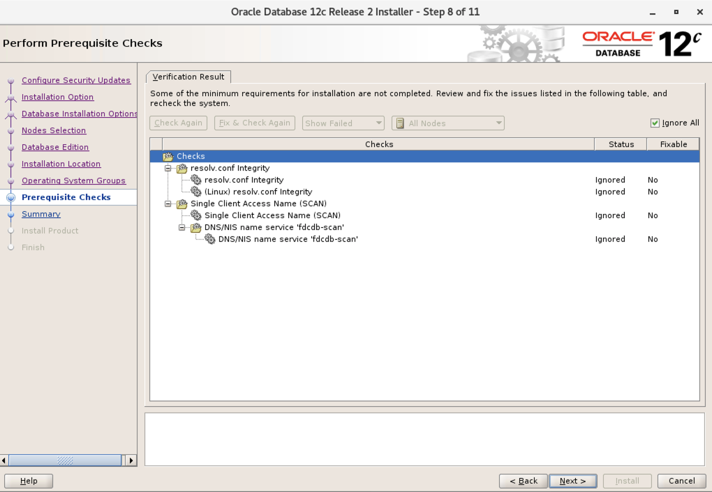

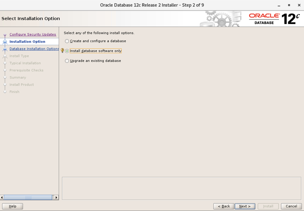

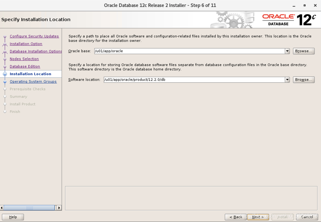

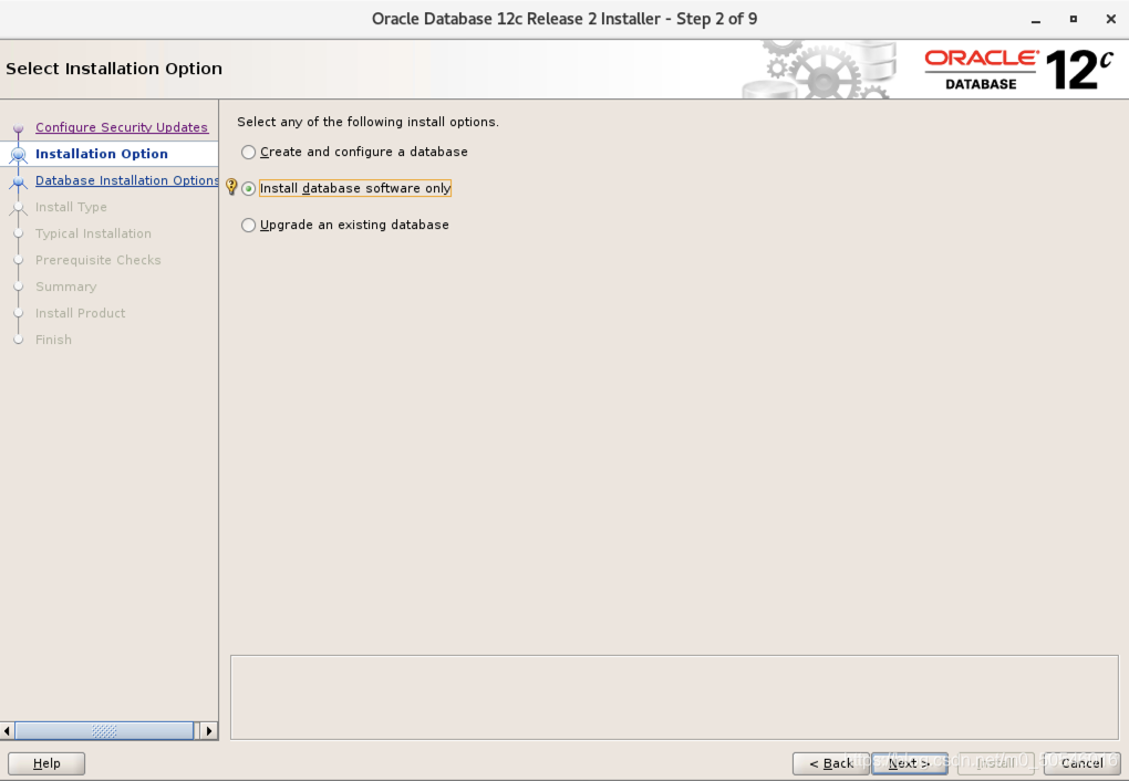

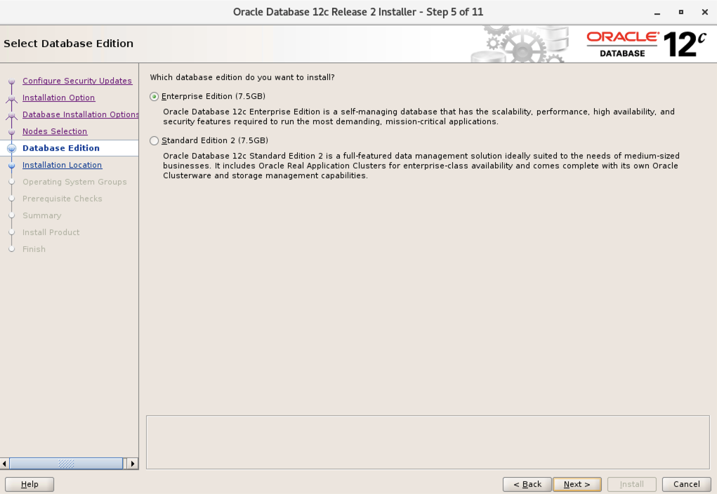

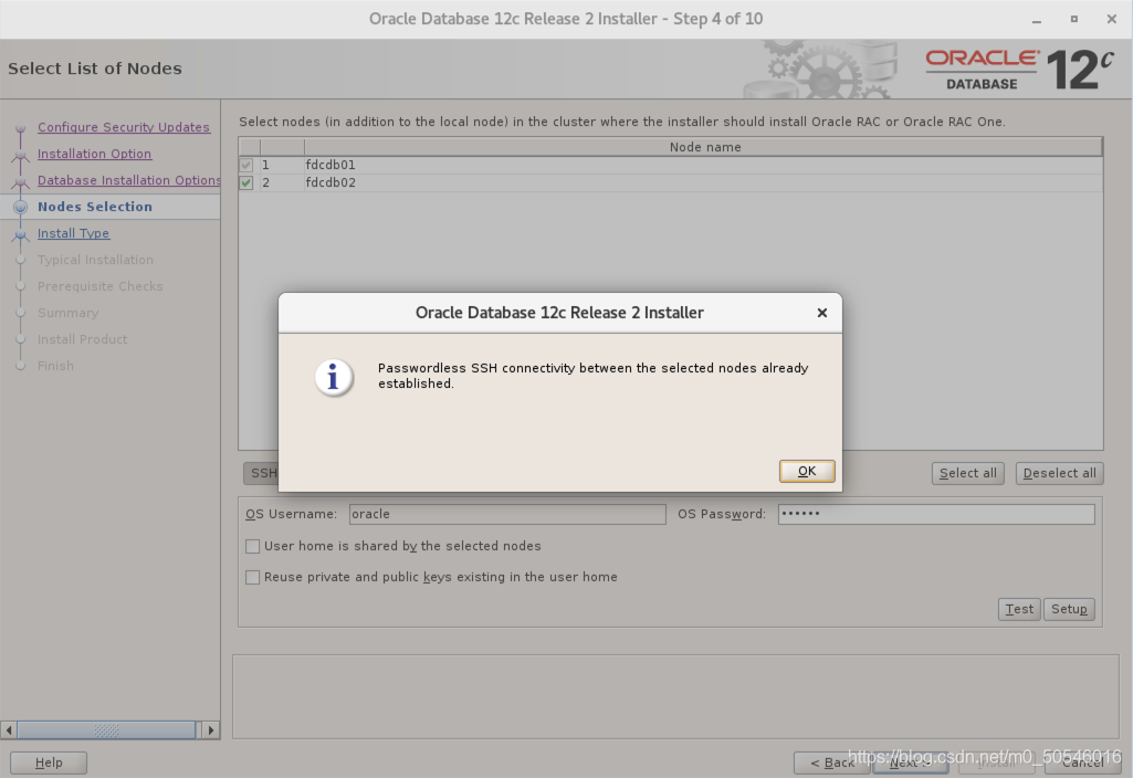

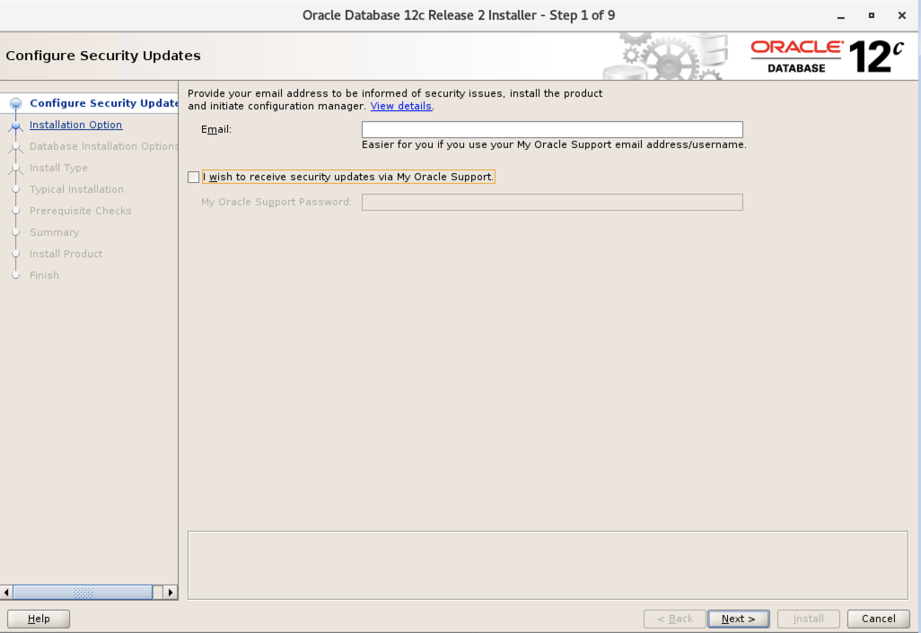

四、安装ORACLE软件
1、安装ORACLE软件
[oracle@fdcdb01 database]$ ./runInstaller
Starting Oracle Universal Installer...
Checking Temp space: must be greater than 500 MB.   Actual 261237 MB    Passed
Checking swap space: must be greater than 150 MB.   Actual 32767 MB    Passed
Checking monitor: must be configured to display at least 256 colors.    Actual 16777216    Passed
Preparing to launch Oracle Universal Installer from /tmp/OraInstall2021-04-02_10-03-42AM. Please wait ...[

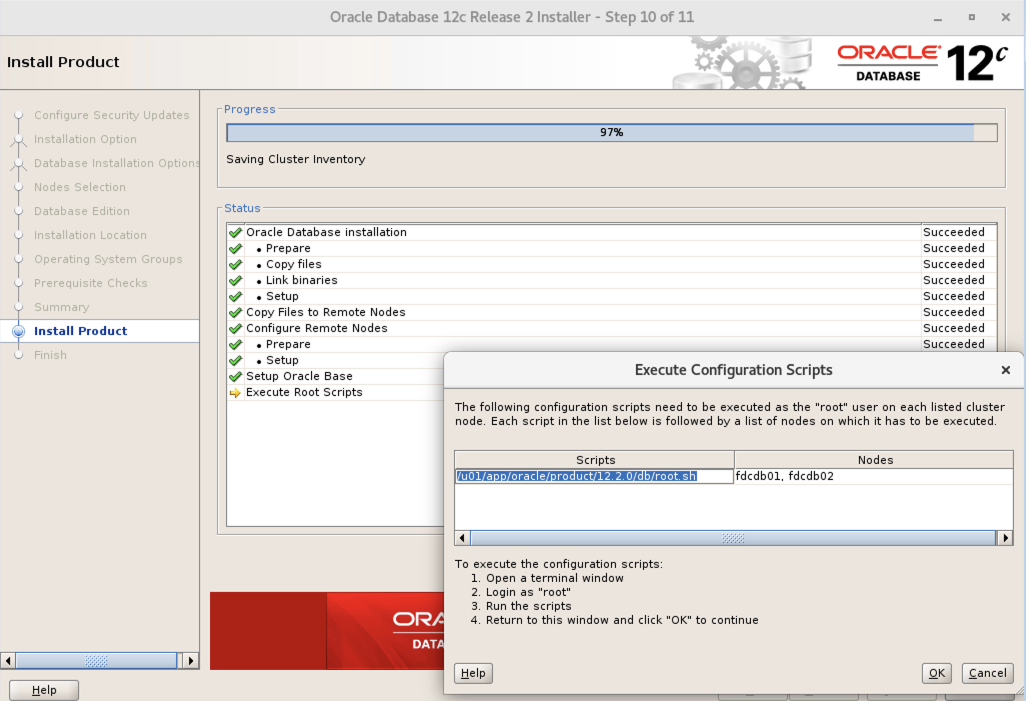

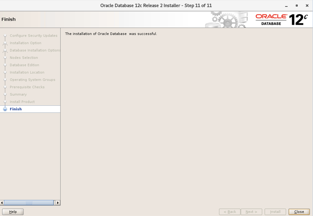

 2、执行ROOT.SH
一节点:
[root@fdcdb01 database]# /u01/app/oracle/product/12.2.0/db/root.sh
Performing root user operation.
The following environment variables are set as:
    ORACLE_OWNER= oracle
    ORACLE_HOME=  /u01/app/oracle/product/12.2.0/db
Enter the full pathname of the local bin directory: [/usr/local/bin]:
The contents of "dbhome" have not changed. No need to overwrite.
The contents of "oraenv" have not changed. No need to overwrite.
The contents of "coraenv" have not changed. No need to overwrite.
Entries will be added to the /etc/oratab file as needed by
Database Configuration Assistant when a database is created
Finished running generic part of root script.
Now product-specific root actions will be performed.
 二节点:
[root@fdcdb02 grid]# /u01/app/oracle/product/12.2.0/db/root.sh
 执行成功。
Oracle软件安装成功。
