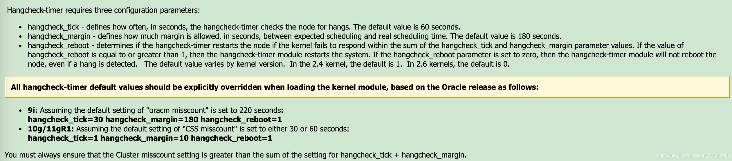

Note : Hangheck timer is not required starting with Oracle Clusterware 11gR2(CTSSD)
The Hangcheck-timer kernel module is required for both Oracle 10gR2 and 11gR1 RAC on Linux. Assuming the default setting of "CSS misscount" is set to either 30 or 60 seconds, the recommended hangcheck-timer settings are: hangcheck_tick=1 hangcheck_margin=10 hangcheck_reboot=1,  see Document 726833.1.  For 11gR2, hangcheck-timer is no longer required as this functionality has been built into the Grid Infrastructure stack.

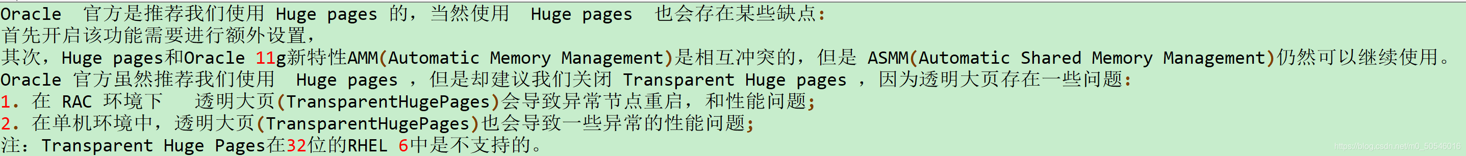

2.HugePages(标准大页)和 Transparent HugePages(透明大页)
主要用于Large Page Size,大内存。
HugePages:
Implement HugePages for the database instances.  HugePages provides a method to have larger page sizes and it will lock the SGA into physical memory thus eliminating the need for system page table lookups for the SGA.  This is especially important on systems with high memory allocations due to eliminate the management overhead associated with the such configurations.  HugePages is also recommended in environments where server stability issues are evident – various spins/hangs, which are not attributed to Oracle Clusterware or other known OS issues.  To compute size, see Document 401749.1. For more information, see Document 361323.1. In 11gR1 and above, you must disable AMM to use HugePages as directed in Document 749851.1.
**Oracle Linux: Shell Script to Calculate Values Recommended Linux HugePages / HugeTLB Configuration (Doc ID 401749.1)    **
Transparent HugePages:
If you are running RedHat/OEL 6/7, SLES 11/12 or UEK2 kernels, be sure to disable Transparent HugePages to prevent performance problems and Node/Instance evictions.  Our long standing recomendation of using general HugePages still stands (THP is a different implementation than general HugePages).  See Document 1557478.1 for additional details.
**ALERT: Disable Transparent HugePages on SLES11, RHEL6, RHEL7, OL6, OL7, and UEK2 and above (Doc ID 1557478.1)    **
If you want to use HugePages make sure that both MEMORY_TARGET / MEMORY_MAX_TARGET initialization parameters are unset (i.e. using “ALTER SYSTEM RESET”) for the database instance.

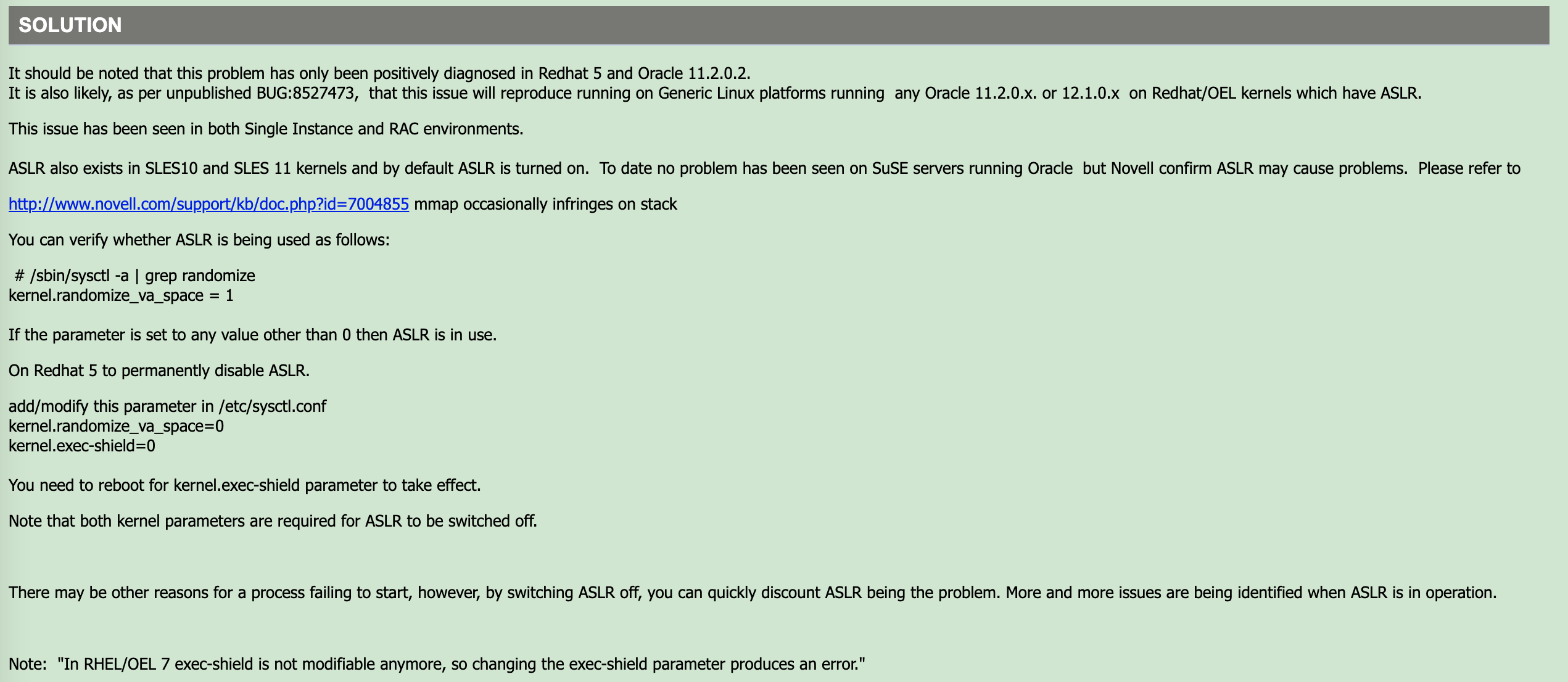

3.Address Space Layout Randomization(ASLR)
Disable ASLR (Address Space Layout Randomization) on OEL/RHEL 5, 6 and 7 and Suse 10 and above to prevent process startup errors.  ASLR  is a feature designed to load shared memory objects in random addresses. In Oracle, multiple processes map a shared memory object at the same address across the processes.  With ASLR turned on Oracle cannot guarantee the availability of this shared memory address.  This conflict in the address space means that a process trying to attach a shared memory object to a specific address may not be able to do so, resulting in a failure in shmat subroutine.  See Document 1345364.1 for additional details.
Note:  "In RHEL/OEL 7 exec-shield is not modifiable anymore, so changing the exec-shield parameter produces an error."
**You need to reboot for kernel.exec-shield parameter to take effect. **
