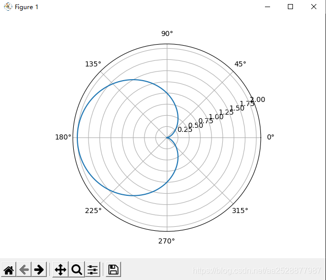

# 心形线
a = 1
theta = np.linspace(0, 2*np.pi, 1000)
r = a*(1 - np.cos(theta))
plt.axes(polar = True)
plt.plot(theta, r)
plt.show()

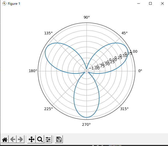

# 玫瑰线
a = 1
r = a* np.sin(3*theta)
plt.plot(theta, r)
plt.show()

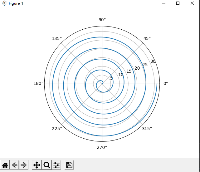

# 阿基米德螺线
a = 1
theta = np.linspace(0, 10*np.pi, 1000)
r = a * theta
plt.plot(theta, r)
plt.show()

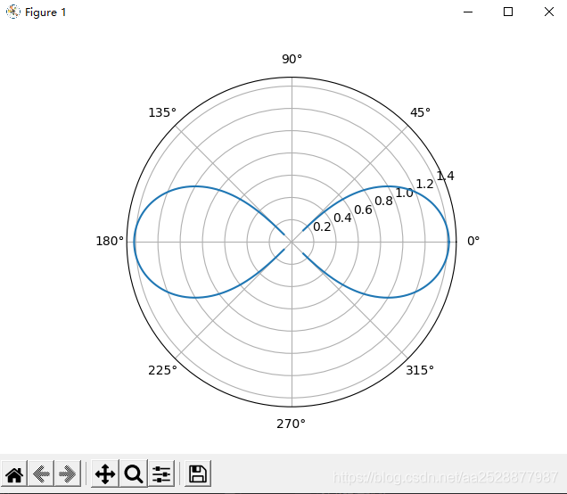

# 伯努利双纽线
a = 1
r = np.sqrt(2*(a**2)*np.cos(2*theta))
plt.plot(theta, r)
plt.show()

画出四个图形如下:
np.linspace来选取0到2π的1000个点,计算r,polar=True 为极坐标图
