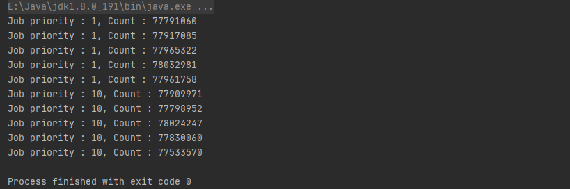

public class Priority {
    /** 线程执行流程控制开关 */
    private static volatile boolean notStart = true;
    /** 线程执行流程控制开关 */
    private static volatile boolean notEnd = true;
    public static void main(String[] args) throws InterruptedException {
        List<Job> jobs = new ArrayList<>();
        // 设置5个优先级为1的线程,设置5个优先级为10的线程
        for (int i = 0; i < 10; i++) {
            int priority = i < 5 ? Thread.MIN_PRIORITY : Thread.MAX_PRIORITY;
            Job job = new Job(priority);
            jobs.add(job);
            Thread thread = new Thread(job, "Thread:" + i);
            thread.setPriority(priority);
            thread.start();
        notStart = false;
        TimeUnit.SECONDS.sleep(10);
        notEnd = false;
        jobs.forEach(
                job -> System.out.println("Job priority : " + job.priority + ", Count : " + job.jobCount)
     * 通过Job来记录线程的执行次数和优先级
    static class Job implements Runnable {
        private int priority;
        private long jobCount;
        public Job(int priority) {
            this.priority = priority;
        @Override
        public void run() {
            while (notStart) {
                // 让出CPU时间片,等待下次调度
                Thread.yield();
            while (notEnd) {
                // 让出CPU时间片,等待下次调度
                Thread.yield();
                jobCount++;

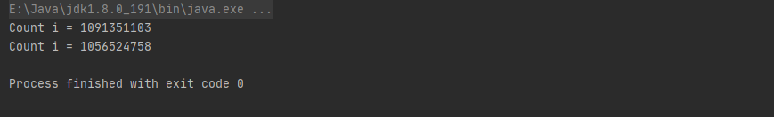

执行结果:
从输出结果上来看,优先级为1的线程和优先级为10的线程执行的次数非常相近,因此这表明程序正确性是不能依赖线程的优先级高低的。

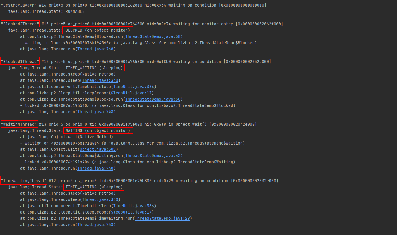

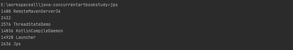

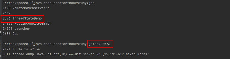

使用JPS查看Java进程:
查看示例代码ThreadStateDemo进程ID是2576,键入jstack 2576查看输出:
整理输出结果:
线程名称
线程状态
Blocked2Thread
BLOCKED (on object monitor),阻塞在获取Blocked.class的锁上
Blocked1Thread
TIMED_WAITING (sleeping)
WaitingThread
WAITING (on object monitor)
TimeWaitingThread
总结:

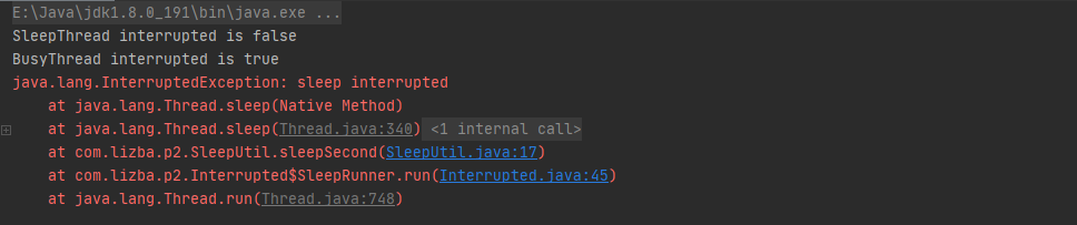

    static class SleepRunner implements Runnable {
        @Override
        public void run() {
            while (true) {
                SleepUtil.sleepSecond(10);
    static class BusyRunner implements Runnable {
        @Override
        public void run() {
            while (true) {}
查看运行结果:
总结:
抛出InterruptedException的是sleepThread线程,虽然两者都被中断过,但是sleepThread线程的中断标志返回的是false,这是因为TimeUnit.SECONDS.sleep(seconds)会抛出InterruptedException异常,抛出异常之前,sleepThread线程的中断标志被清除了。但是,busyThread一直在运行没有抛出异常,中断位没有被清除。

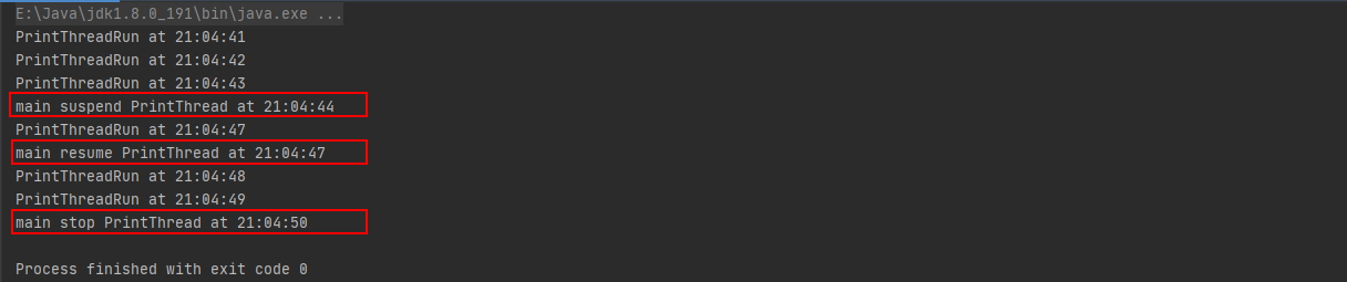

3、suspend()、resume()和stop()
举例:
线程这三个方法,相当于QQ音乐播放音乐时的暂停、恢复和停止操作。(注意这些方法已经过期了,不建议使用。)
示例代码:
package com.lizba.p2;
import java.text.DateFormat;
import java.text.SimpleDateFormat;
import java.util.Date;
import java.util.concurrent.TimeUnit;
 * <p>
 *      线程过期方法示例
 * </p>
 * @Author: Liziba
 * @Date: 2021/6/14 20:57
public class Deprecated {
    static DateFormat format = new SimpleDateFormat("HH:mm:ss");
        Thread printThread = new Thread(new PrintThread(), "PrintThread");

输出结果:
总结:
上述代码执行输出的结果,与API说明和我们的预期完成一致,但是看似正确的代码却隐藏这很多问题。
存在问题:
  • suspend()方法调用后不会释放已占有的资源(比如锁),可能会导致死锁
  • stop()方法在终结一个线程时不能保证资源的正常释放,可能会导致程序处于不确定的工作状态

输出结果:
总结:
main线程通过中断操作和cancel()方法均可使CountThread得以终止。这两种方法终止线程的好处是能让线程在终止时有机会去清理资源。做法更加安全和优雅。
