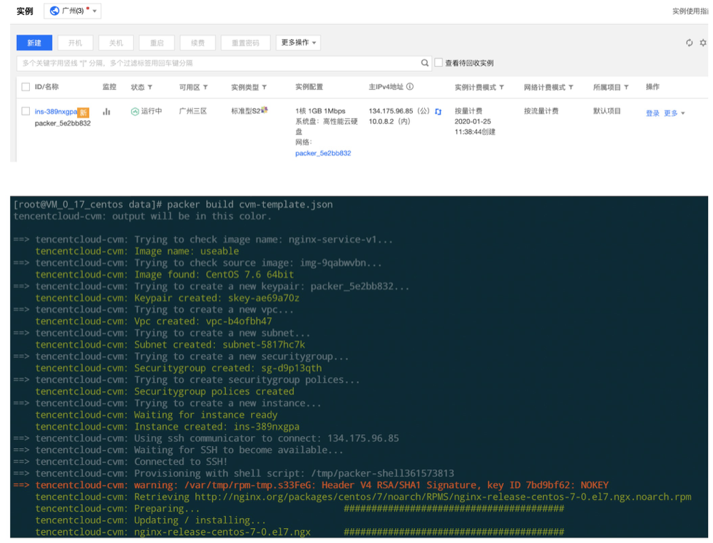

==> tencentcloud-cvm: Trying to create a new image: nginx-service-v1...
    tencentcloud-cvm: Waiting for image ready
    tencentcloud-cvm: Image created: img-lw1glokq
==> tencentcloud-cvm: Cleaning up instance...
==> tencentcloud-cvm: Cleaning up securitygroup...
==> tencentcloud-cvm: Cleaning up subnet...
==> tencentcloud-cvm: Cleaning up vpc...
==> tencentcloud-cvm: Cleaning up keypair...
Build 'tencentcloud-cvm' finished.
==> Builds finished. The artifacts of successful builds are:
--> tencentcloud-cvm: Tencentcloud images(ap-guangzhou: img-lw1glokq) were created.
4.1.3 查看执行结果
图片描述
图片描述
