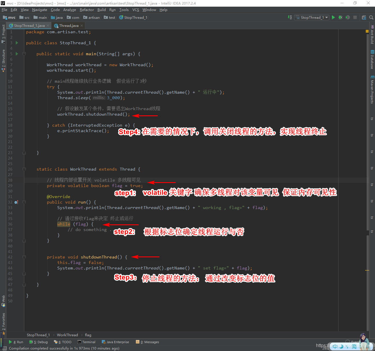

方式一 设置开关
package com.artisan.test;
public class StopThread_1 {
        WorkThread workThread = new WorkThread();
        workThread.start();
        // main线程继续执行业务逻辑  假设运行了3秒
        try {
            System.out.println(Thread.currentThread().getName() + " 运行中");
            Thread.sleep(3_000);
            // 假设触发某个条件,需要退出WorkThread线程
            workThread.shutdownThread();
        } catch (InterruptedException e) {
            e.printStackTrace();
    static class WorkThread extends Thread {
        // 线程内部设置开关 volatile 多线程可见
        private volatile boolean flag = true;
        @Override
        public void run() {
            System.out.println(Thread.currentThread().getName() + " working , flag=" + flag);
            // 通过接收flag来决定 终止或运行
            while (flag) {
                // do something ......
        private void shutdownThread() {
            this.flag = false;
            System.out.println(Thread.currentThread().getName() + " set flag=" + flag);

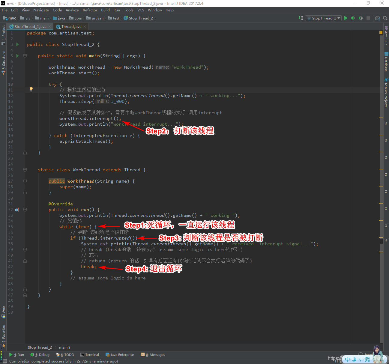

方式二 调用interrupt API
public class StopThread_2 {
        WorkThread workThread = new WorkThread("workThread");
        workThread.start();
        try {
            // 模拟主线程的业务
            System.out.println(Thread.currentThread().getName() + " working...");
            // 假设触发了某种条件,需要中断workThread线程的执行 调用interrupt
            workThread.interrupt();
            System.out.println("workThread interrupt...");
        public WorkThread(String name) {
            super(name);
        @Override
        public void run() {
            System.out.println(Thread.currentThread().getName() + " working ");
            // 死循环
            while (true) {
                // 判断 该线程是否被打断
                if (Thread.interrupted()) {
                    System.out.println(Thread.currentThread().getName() + " received  interrupt signal...");
                    // break (break的话  还会执行 assume some logic is here的代码)
                    // 或者
                    // return (return 的话,如果有后面还有代码的话就不会执行后续的代码了)
                    break;
                // assume some logic is here

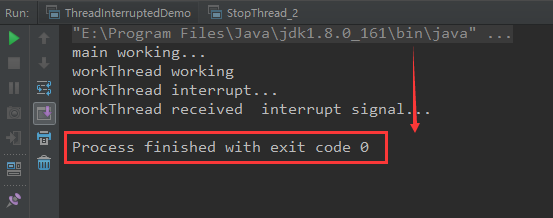

运行结果:
