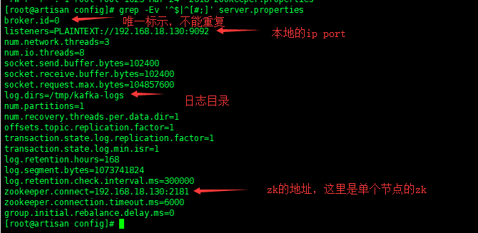

130
[root@artisan config]# grep -Ev '^$|^[#;]' server.properties
broker.id=0
listeners=PLAINTEXT://192.168.18.130:9092
num.network.threads=3
num.io.threads=8
socket.send.buffer.bytes=102400
socket.receive.buffer.bytes=102400
socket.request.max.bytes=104857600
log.dirs=/tmp/kafka-logs
num.partitions=1
num.recovery.threads.per.data.dir=1
offsets.topic.replication.factor=1
transaction.state.log.replication.factor=1
transaction.state.log.min.isr=1
log.retention.hours=168
log.segment.bytes=1073741824
log.retention.check.interval.ms=300000
zookeeper.connect=192.168.18.130:2181
zookeeper.connection.timeout.ms=6000
group.initial.rebalance.delay.ms=0

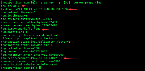

131
broker.id=1
listeners=PLAINTEXT://192.168.18.131:9092
num.io.threads=8
num.partitions=1

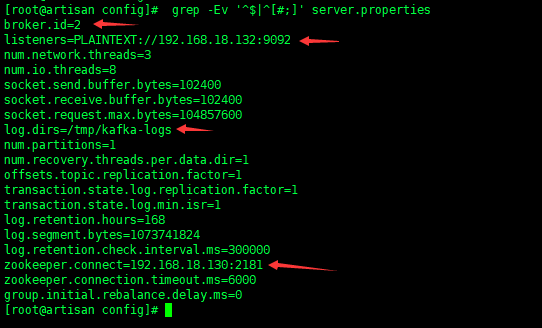

132
broker.id=2
listeners=PLAINTEXT://192.168.18.132:9092
num.io.threads=8
num.partitions=1

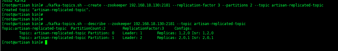

启动zookeeper 和 3个 kafka 后,我们创建一个新的topic,副本数设置为3,分区数设置为2
[root@artisan bin]# ./kafka-topics.sh --create --zookeeper 192.168.18.130:2181 --replication-factor 3 --partitions 2 --topic artisan-replicated-topic
Created topic "artisan-replicated-topic".
[root@artisan bin]#
  • 1
  • 2
  • 3
  • 4
查看topic的情况
[root@artisan bin]# ./kafka-topics.sh --describe --zookeeper 192.168.18.130:2181 --topic artisan-replicated-topic
Topic:artisan-replicated-topic	PartitionCount:2	ReplicationFactor:3	Configs:
	Topic: artisan-replicated-topic	Partition: 0	Leader: 1	Replicas: 1,2,0	Isr: 1,2,0
	Topic: artisan-replicated-topic	Partition: 1	Leader: 2	Replicas: 2,0,1	Isr: 2,0,1
[root@artisan bin]#
