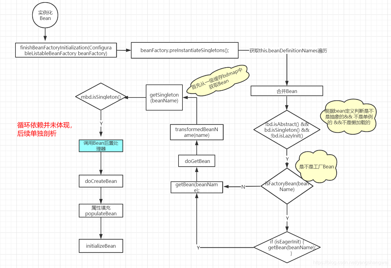

继续
beanFactory.preInstantiateSingletons();
  • 1
@Override
	public void preInstantiateSingletons() throws BeansException {
		if (logger.isDebugEnabled()) {
			logger.debug("Pre-instantiating singletons in " + this);
		//获取我们容器中所有bean定义的名称
		List<String> beanNames = new ArrayList<>(this.beanDefinitionNames);
		//循环我们所有的bean定义名称
		for (String beanName : beanNames) {
			//合并我们的bean定义
			RootBeanDefinition bd = getMergedLocalBeanDefinition(beanName);
			 * 根据bean定义判断是不是抽象的&& 不是单例的 &&不是懒加载的
			if (!bd.isAbstract() && bd.isSingleton() && !bd.isLazyInit()) {
				//是不是工厂bean
				if (isFactoryBean(beanName)) {
					//是的话 给beanName+前缀&符号
					Object bean = getBean(FACTORY_BEAN_PREFIX + beanName);
					if (bean instanceof FactoryBean) {
						final FactoryBean<?> factory = (FactoryBean<?>) bean;
						boolean isEagerInit;
						if (System.getSecurityManager() != null && factory instanceof SmartFactoryBean) {
							isEagerInit = AccessController.doPrivileged((PrivilegedAction<Boolean>)
											((SmartFactoryBean<?>) factory)::isEagerInit,
									getAccessControlContext());
						else {
							isEagerInit = (factory instanceof SmartFactoryBean &&
									((SmartFactoryBean<?>) factory).isEagerInit());
						//调用真正的getBean的流程
						if (isEagerInit) {
							getBean(beanName);
				else {//非工厂Bean 就是普通的bean
					getBean(beanName);
		//或有的bean的名称 ...........到这里所有的单实例的bean已经记载到单实例bean到缓存中
			//从单例缓存池中获取所有的对象
			Object singletonInstance = getSingleton(beanName);
			//判断当前的bean是否实现了SmartInitializingSingleton接口
			if (singletonInstance instanceof SmartInitializingSingleton) {
				final SmartInitializingSingleton smartSingleton = (SmartInitializingSingleton) singletonInstance;
				if (System.getSecurityManager() != null) {
					AccessController.doPrivileged((PrivilegedAction<Object>) () -> {
						smartSingleton.afterSingletonsInstantiated();
						return null;
					}, getAccessControlContext());
				else {
					//触发实例化之后的方法afterSingletonsInstantiated

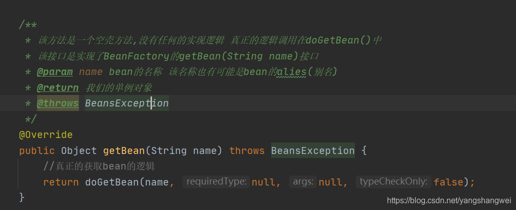

重点方法肯定是 getBean(beanName);咯
