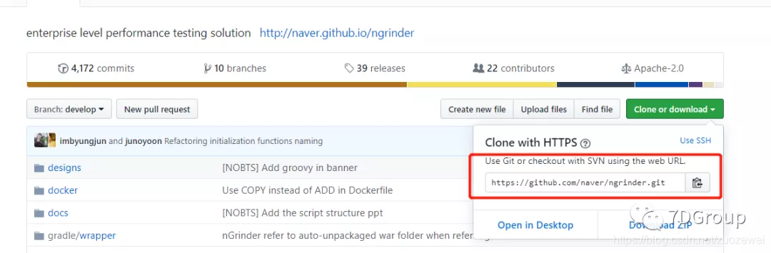

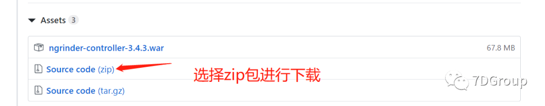

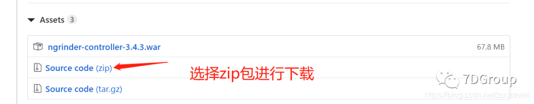

源码下载
下载地址:https://github.com/naver/ngrinder/releases
也可以直接通过:https://github.com/naver/ngrinder.git 方式

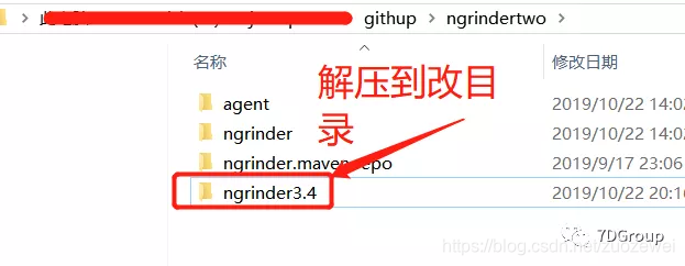

本地配置
这我们演示直接使用下载 zip 包进行安装:

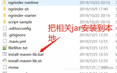

打开目录启动脚本:

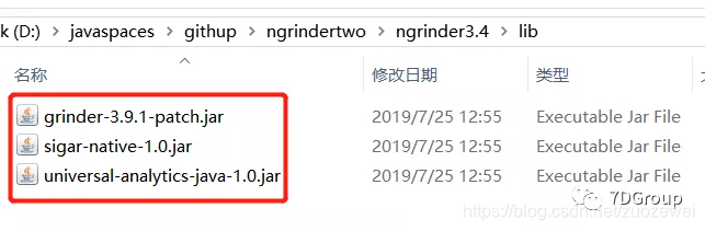

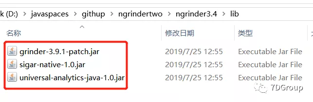

等待执行成功便把如下 jar 包安装到本地仓库:

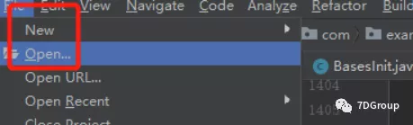

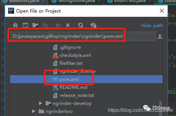

打开 IDEA 开发工具:
点击文件导入 Project:
点击 Open as Project:
打开一个新窗口:
等待 maven 加载相应的 jar。

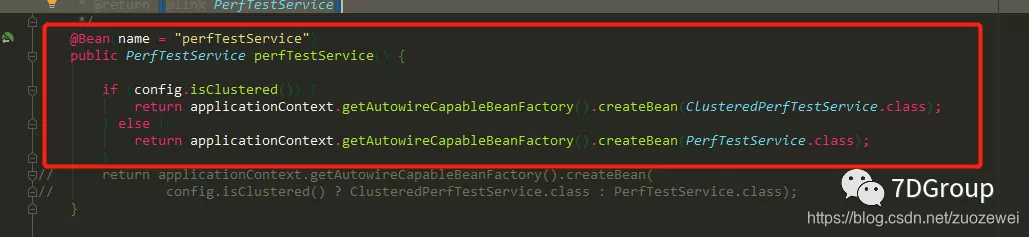

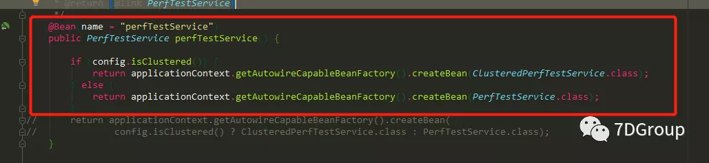

修改代码:
具体代码如下:
package org.ngrinder.perftest.service;
import org.ngrinder.infra.config.Config;
import org.springframework.beans.factory.annotation.Autowired;
import org.springframework.context.ApplicationContext;
import org.springframework.context.ApplicationContextAware;
import org.springframework.context.annotation.Bean;
import org.springframework.context.annotation.Configuration;
import org.springframework.context.annotation.EnableAspectJAutoProxy;
import org.springframework.context.annotation.Profile;
import org.springframework.scheduling.annotation.EnableScheduling;
import org.springframework.transaction.annotation.EnableTransactionManagement;
 * Dynamic creation of {@link PerfTestService} depending on the cluster enable or disable.
 * @author JunHo Yoon
 * @since 3.1
@Configuration
@Profile("production")
@EnableScheduling
@EnableTransactionManagement
@EnableAspectJAutoProxy
public class PerfTestServiceConfig implements ApplicationContextAware {
   @Autowired
   private Config config;
   private ApplicationContext applicationContext;
    * Create PerTest service depending on cluster mode.
    * @return {@link PerfTestService}
   @Bean(name = "perfTestService")
   public PerfTestService perfTestService() {
      if (config.isClustered()) {
         return applicationContext.getAutowireCapableBeanFactory().createBean(ClusteredPerfTestService.class);
      } else {
         return applicationContext.getAutowireCapableBeanFactory().createBean(PerfTestService.class);
//    return applicationContext.getAutowireCapableBeanFactory().createBean(
//          config.isClustered() ? ClusteredPerfTestService.class : PerfTestService.class);
   @Override
   public void setApplicationContext(ApplicationContext applicationContext) {
      this.applicationContext = applicationContext;

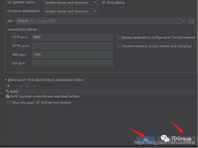

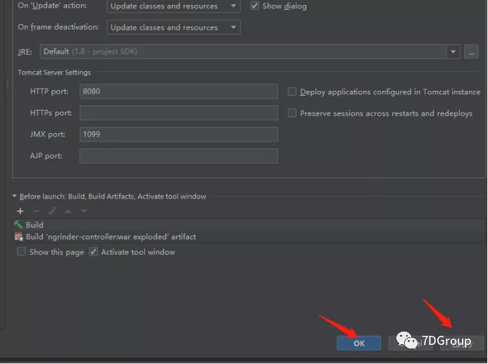

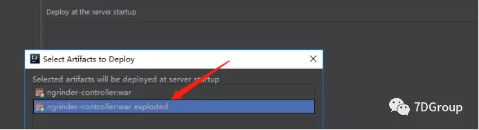

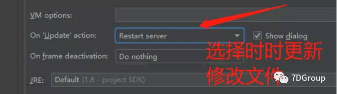

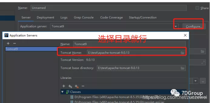

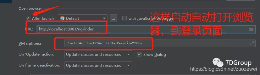

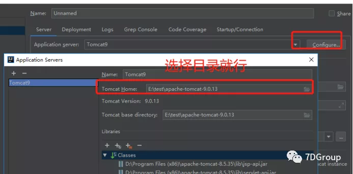

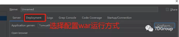

再次配置 Tomcat:
选择运行方式:

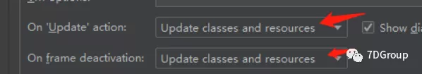

选择时时更新运行:

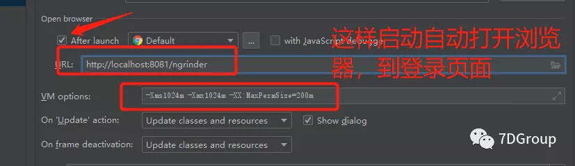

注意最好是加上 JVM 启动参数:
-Xms1024m -Xmx1024m -XX:MaxPermSize=200m
防止内存出现异常
点击确定:

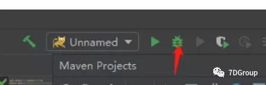

启动项目:

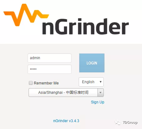

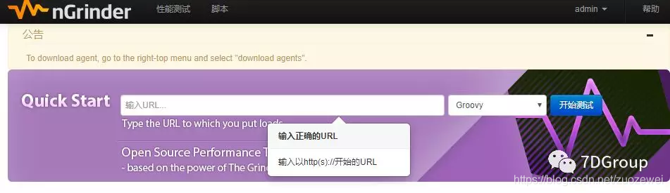

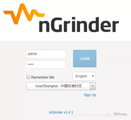

启动验证
打开浏览器验证是否成功:
http://localhost:8081/ngrinder/login
登录成功:

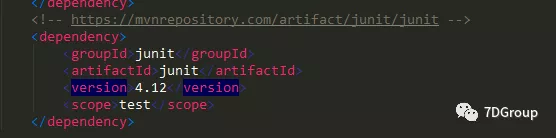

在 script-sample工程下的 pom.xml文件增加:
代码如下:
<!-- https://mvnrepository.com/artifact/junit/junit -->
<dependency>
   <groupId>junit</groupId>
   <artifactId>junit</artifactId>
   <version>4.12</version>
   <scope>test</scope>
</dependency>

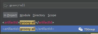

再次在 idea 中全局搜索:
groovy-all
查看版本号,统一修改为:
<version>2.4.16</version>

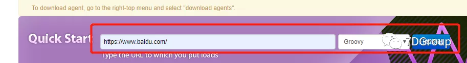

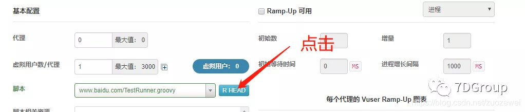

通过平台生成脚本:
点击 R HEAD:
查看脚本:

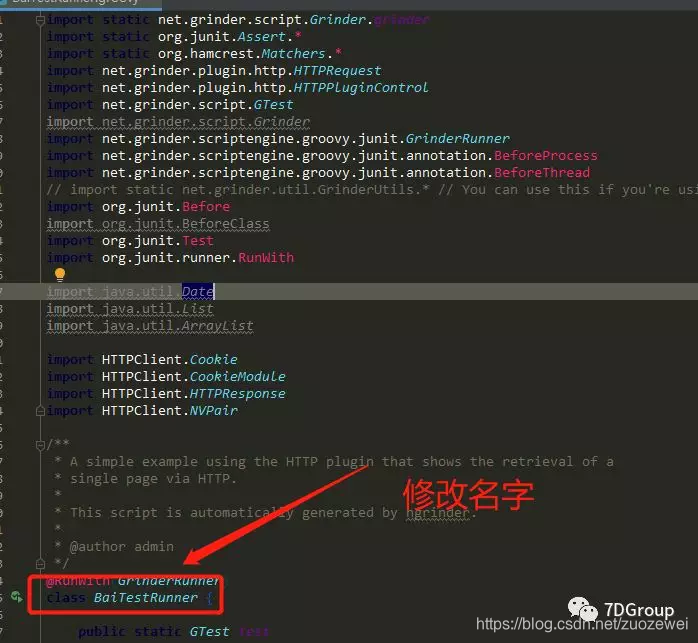

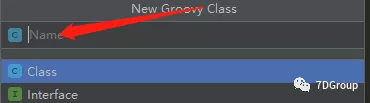

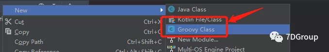

在 idea 中新建脚本:
选择 Groovy 脚本:
输入名字点击保存即可:

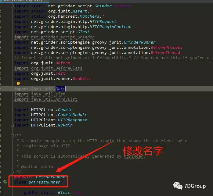

新建完毕把刚才脚本复制过来修改下方法名称:

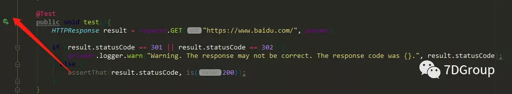

点击运行:

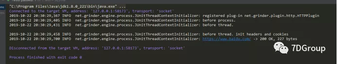

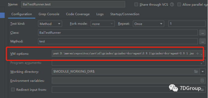

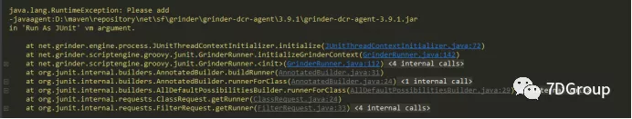

可以看到提示:

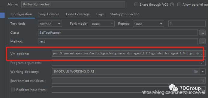

在 Idea 菜单栏->Run->Edit Configurations->Default->Junit->在VM options 填写自定义配置,点击 Apply 按钮保存配置即生效:
再次点击:
运行结果如下:
到这里本机脚本调试成功。
