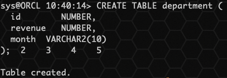

创建测试表 Department
CREATE TABLE department (
  id        NUMBER,
  revenue   NUMBER,
  month  VARCHAR2(10)

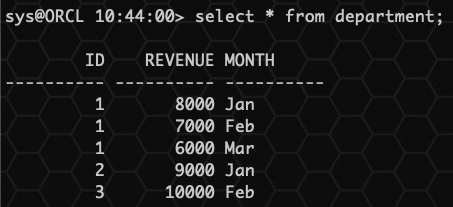

插入测试数据
INSERT INTO department VALUES (1, 8000, 'Jan');
INSERT INTO department VALUES (1, 7000, 'Feb');
INSERT INTO department VALUES (1, 6000, 'Mar');
INSERT INTO department VALUES (2, 9000, 'Jan');
INSERT INTO department VALUES (3, 10000, 'Feb');
commit;

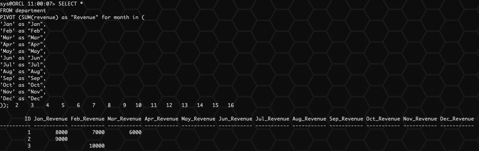

执行 Pivot 行转列函数
根据题意:已确定需要查出的列为 ID 和 12个月份,月份列对应的 REVENUE 的值需要进行汇总 (SUM) 显示。
SELECT *
FROM department
PIVOT (SUM(revenue) as "Revenue" for month in (
'Jan' as "Jan",
'Feb' as "Feb",
'Mar' as "Mar",
'Apr' as "Apr",
'May' as "May",
'Jun' as "Jun",
'Jul' as "Jul",
'Aug' as "Aug",
'Sep' as "Sep",
'Oct' as "Oct",
'Nov' as "Nov",
'Dec' as "Dec"
❤️ 格式化结果与原题所需要求保持一致,解题完成。 ❤️
