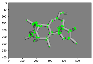

  1. import numpy as np
  2. import cv2
  3. from matplotlib import pyplot as plt
  4. img = cv2.imread('molecule.png',0)
  5. # Initiate STAR detector
  6. orb = cv2.ORB_create()
  7. # find the keypoints with ORB
  8. kp = orb.detect(img,None)
  9. # compute the descriptors with ORB
  10. kp, des = orb.compute(img, kp)
  11. # draw only keypoints location,not size and orientation
  12. img2 = cv2.drawKeypoints(img,kp,color=(0,255,0), flags=0,outImage=None)
  13. cv2.imwrite('sift_keypoints.jpg',img)
  14. plt.imshow(img2),plt.show()
