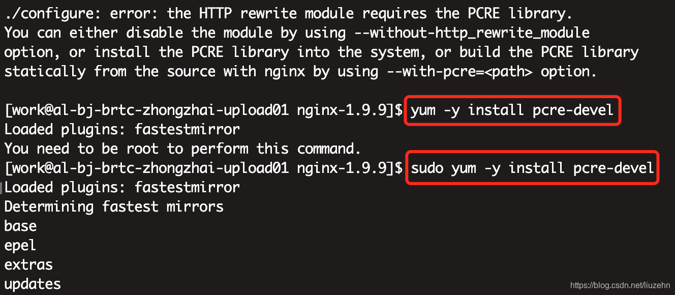

问题一、error: the HTTP rewrite module requires the PCRE library.
./configure: error: the HTTP rewrite module requires the PCRE library.
You can either disable the module by using --without-http_rewrite_module
option, or install the PCRE library into the system, or build the PCRE library
statically from the source with nginx by using --with-pcre=<path> option.
解决:
yum -y install pcre-devel

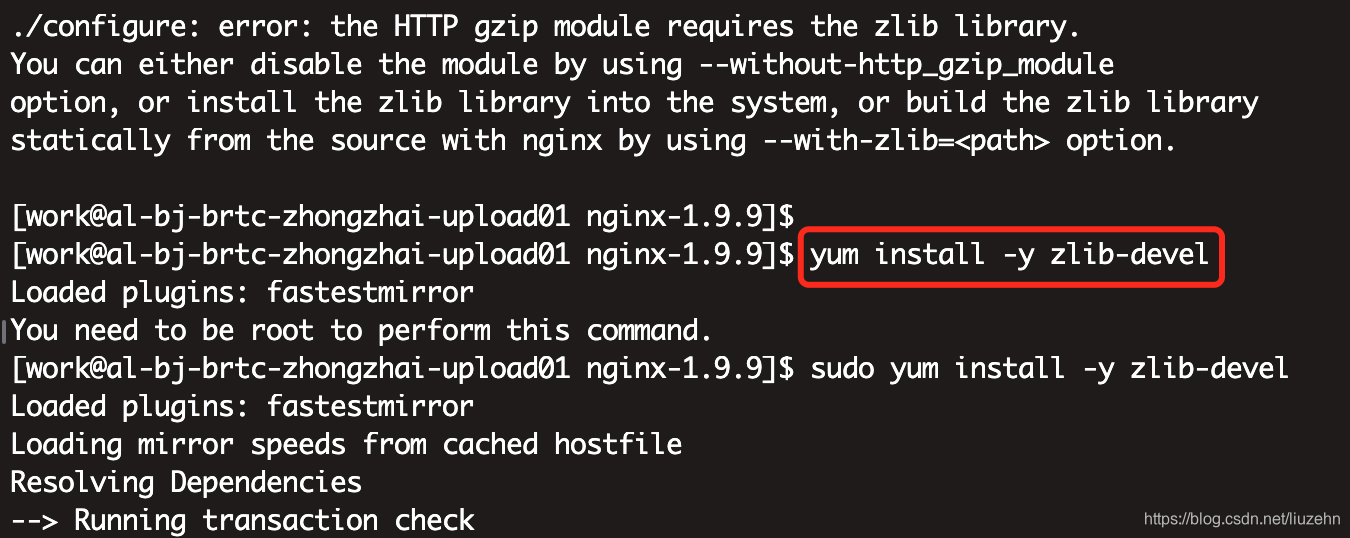

问题二、error: the HTTP gzip module requires the zlib library.
./configure: error: the HTTP gzip module requires the zlib library.
You can either disable the module by using --without-http_gzip_module
option, or install the zlib library into the system, or build the zlib library
statically from the source with nginx by using --with-zlib=<path> option.
解决:
yum install -y zlib-devel

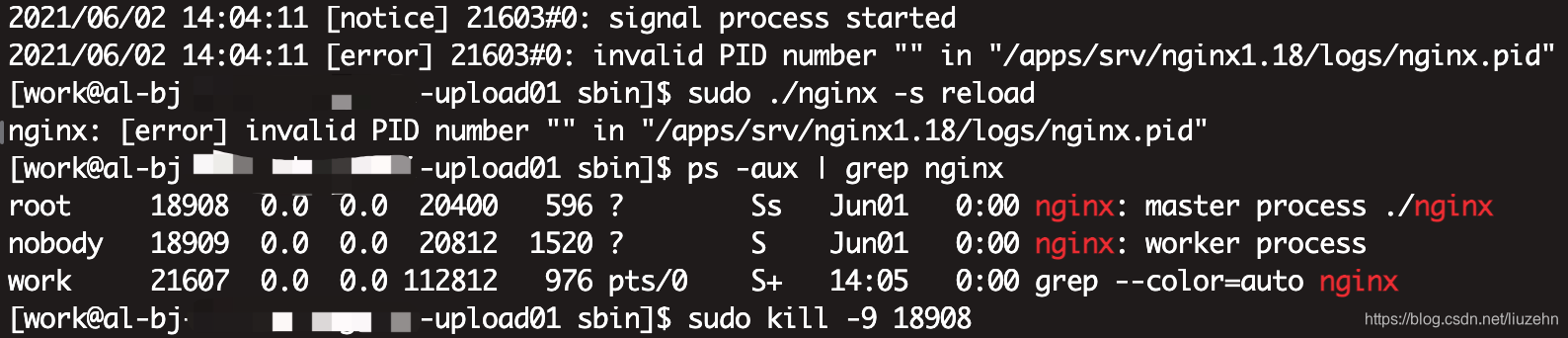

问题三、invalid PID number "" in "/apps/srv/nginx1.18/logs/nginx.pid"
2021/06/02 14:04:11 [notice] 21603#0: signal process started
2021/06/02 14:04:11 [error] 21603#0: invalid PID number "" in "/apps/srv/nginx1.18/logs/nginx.pid"
解决:
没有找到PID对应的nginx进程,所以,如果我们想重启nginx服务的话是有问题的。
我们可以直接运行如下命令启动nginx服务:
./nginx
而不是使用:
./nginx -s reload
当然还有另外一种可能,就是已经存在nginx服务干扰了新服务启动,我们可以使用如下命令查看当前nginx服务的运行状态:
ps -aux | grep nginx
然后,根据PID,干掉对应的nginx服务,再重新启动nginx服务。
kill -9 pid
