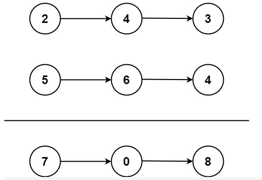

示例1:
- 输入:L1 = [2,4,3],L2 = [5,6,4]
- 输出:[7,0,8]
- 解释:342 + 465 = 807.

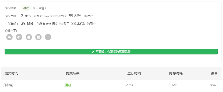

Leetcode执行结果:
