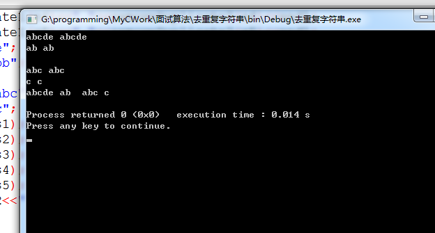

测试用例:
不包含重复字符的字符串,比如:abcd
字符串全是重复字符,比如:aaaa
空字符串
重复字符连续出现,比如:aaabbb
重复字符不连续出现,比如:abababa
完整代码如下:
#include <iostream>
#include <cstring>
using namespace std;
string removeDuplicate1(string s)
{ int check = 0; int len = s.length(); if(len < 2) return s; string str = ""; for(int i=0; i<len; ++i) { int v = (int)(s[i]-'a'); if((check & (1<<v)) == 0) { str += s[i]; check |= (1<<v); } } return str;
string removeDuplicate2(string s)
{ int len = s.length(); if(len < 2) return s; string str = ""; for(int i=0; i<len; ++i) { if(s[i] != '\0') { str += s[i]; for(int j=i+1; j<len; ++j) if(s[j]==s[i]) s[j] = '\0'; } } return str;
void removeDuplicate3(char s[])
{ int len = strlen(s); if(len < 2) return; int p = 0; for(int i=0; i<len; ++i) { if(s[i] != '\0') { s[p++] = s[i]; for(int j=i+1; j<len; ++j) if(s[j]==s[i]) s[j] = '\0'; } } s[p] = '\0';
void removeDuplicate4(char s[])
{ int len = strlen(s); if(len < 2) return; bool c[256]; memset(c, 0, sizeof(c)); int p = 0; for(int i=0; i<len; ++i) { if(!c[s[i]]) { s[p++] = s[i]; c[s[i]] = true; } } s[p] = '\0'; }
void removeDuplicate5(char s[])
{ int len = strlen(s); if(len < 2) return; int check = 0, p = 0; for(int i=0; i<len; ++i) { int v = (int)(s[i]-'a'); if((check & (1<<v))==0) { s[p++] = s[i]; check |= (1<<v); } } s[p] = '\0';
int main()
{ string s1 = "abcde"; string s2 = "aaabbb"; string s3 = ""; string s4 = "abababc"; string s5 = "ccccc"; cout<<removeDuplicate1(s1)<<" "<<removeDuplicate2(s1)<<endl; cout<<removeDuplicate1(s2)<<" "<<removeDuplicate2(s2)<<endl; cout<<removeDuplicate1(s3)<<" "<<removeDuplicate2(s3)<<endl; cout<<removeDuplicate1(s4)<<" "<<removeDuplicate2(s4)<<endl; cout<<removeDuplicate1(s5)<<" "<<removeDuplicate2(s5)<<endl; char ss1[] = "abcde"; char ss2[] = "aaabbb"; char ss3[] = ""; char ss4[] = "abababc"; char ss5[] = "ccccc"; removeDuplicate5(ss1); removeDuplicate5(ss2); removeDuplicate5(ss3); removeDuplicate5(ss4); removeDuplicate5(ss5); cout<<ss1<<" "<<ss2<<" "<<ss3<<" "<<ss4<<" "<<ss5<<endl; return 0;

测试结果如下:
