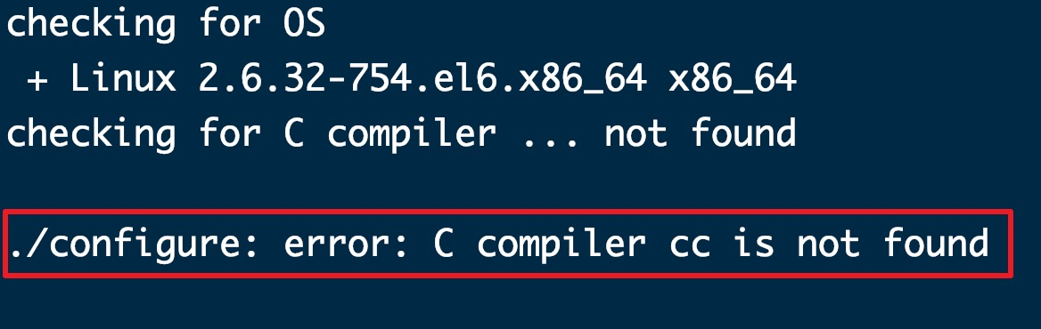

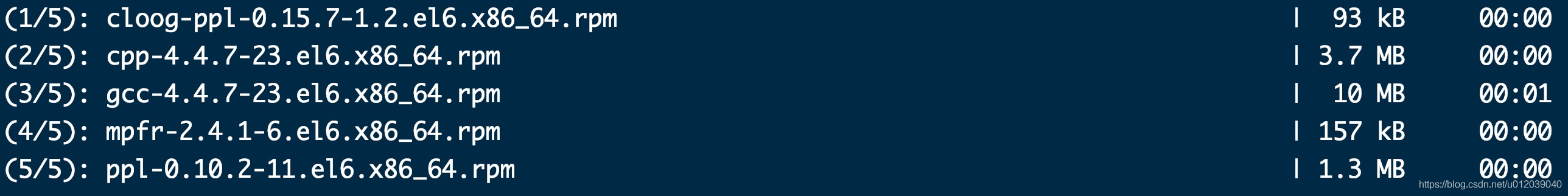

必须要安装的就是gcc(GNU Compiler Collection)GNU编译器套件,其中包含了C、C++、Objective-C、Fortran、Java、Ada、Go语言前端,也包含了对应语言的库,几乎可以满足绝大部分源码软件对编译环境的需要。
yum install gcc
  • 1
安装后可解决以下问题:

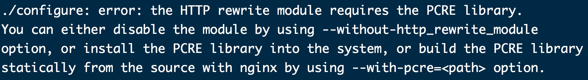

  • pcre
./configure: error: the HTTP rewrite module requires the PCRE library.
You can either disable the module by using --without-http_rewrite_module
option, or install the PCRE library into the system, or build the PCRE library
statically from the source with nginx by using --with-pcre=<path> option.
  • 1
  • 2
  • 3
  • 4
yum install pcre-devel

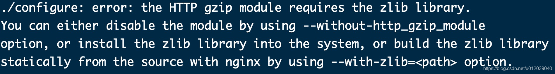

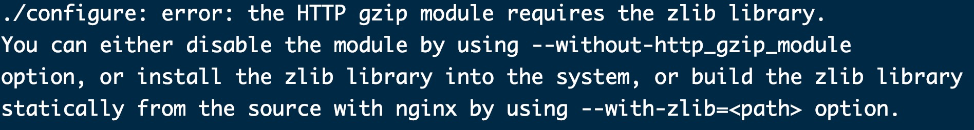

  • zlib
./configure: error: the HTTP gzip module requires the zlib library.
You can either disable the module by using --without-http_gzip_module
option, or install the zlib library into the system, or build the zlib library
statically from the source with nginx by using --with-zlib=<path> option.
  • 1
  • 2
  • 3
  • 4
yum install zlib-devel

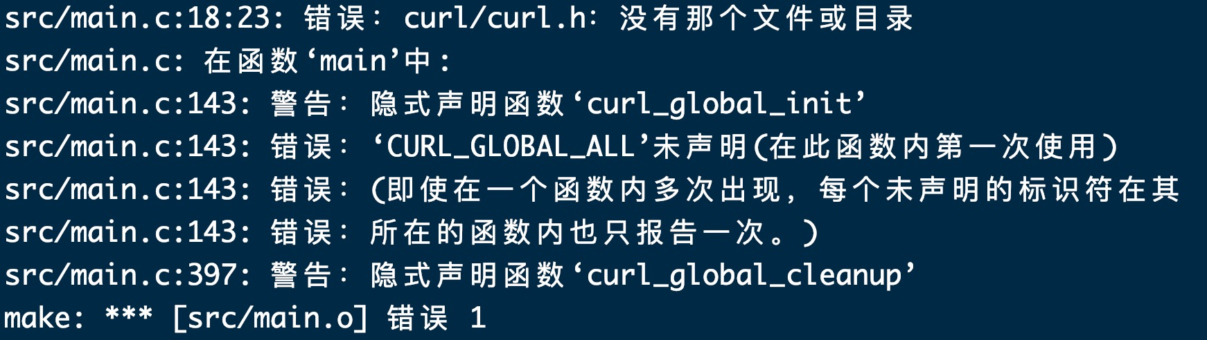

  • curl
src/main.c:18:23: 错误:curl/curl.h:没有那个文件或目录
src/main.c: 在函数‘main’中:
src/main.c:143: 警告:隐式声明函数‘curl_global_init’
src/main.c:143: 错误:‘CURL_GLOBAL_ALL’未声明(在此函数内第一次使用)
src/main.c:143: 错误:(即使在一个函数内多次出现,每个未声明的标识符在其
src/main.c:143: 错误:所在的函数内也只报告一次。)
src/main.c:397: 警告:隐式声明函数‘curl_global_cleanup’
make: *** [src/main.o] 错误 1
  • 1
  • 2
  • 3
  • 4
  • 5
  • 6
  • 7
  • 8
yum install curl-devel
